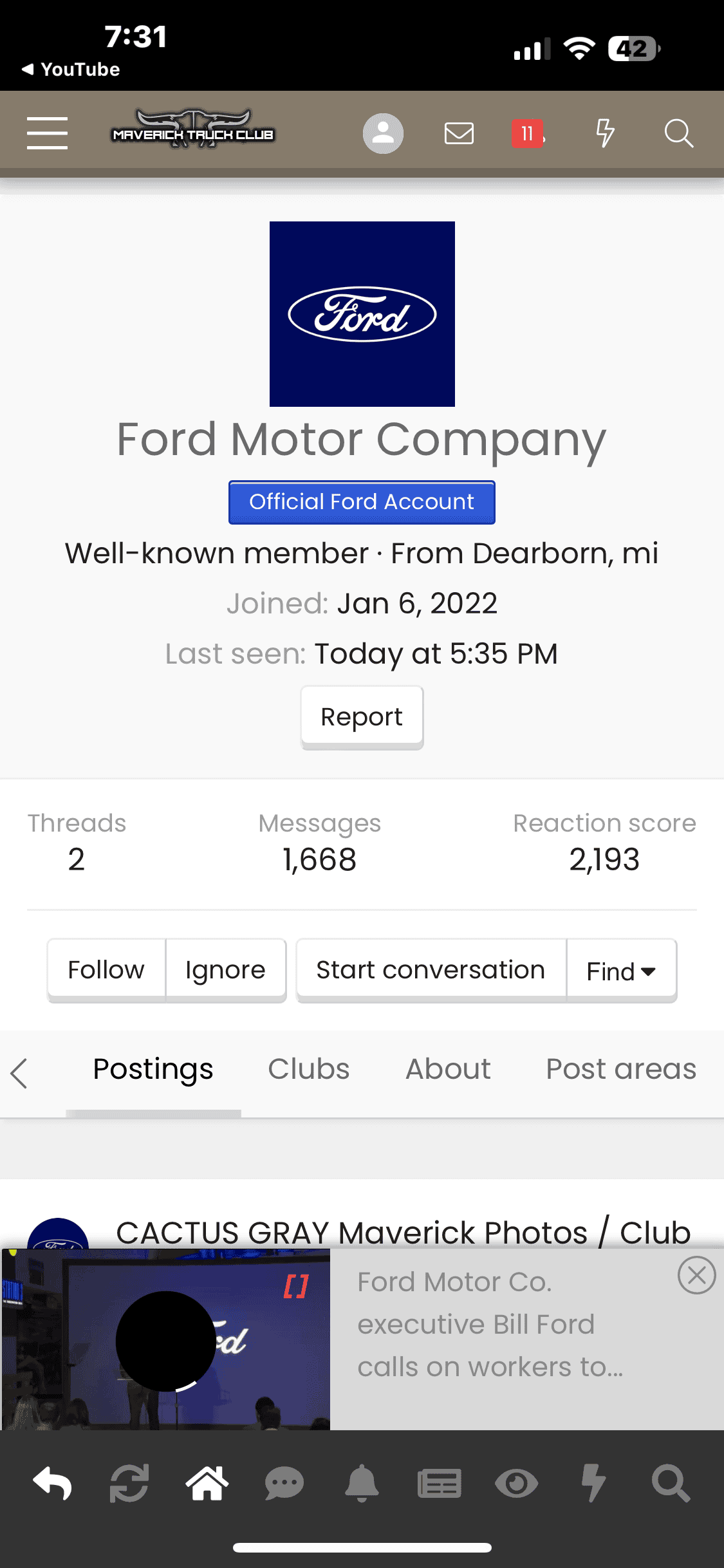

I contacted ford thru one of the members here on the forum. It says ford in her listing. She was a media person, but sent my info to a ford customer service rep. They contacted me the next day and wanted all the details. They then called me too. Another rep then contacted me and the dealer after they got all the info. They said all info was confidential . So I’ll let you start with the PM. I just searched for ford in the member list and the ball starting rolling .

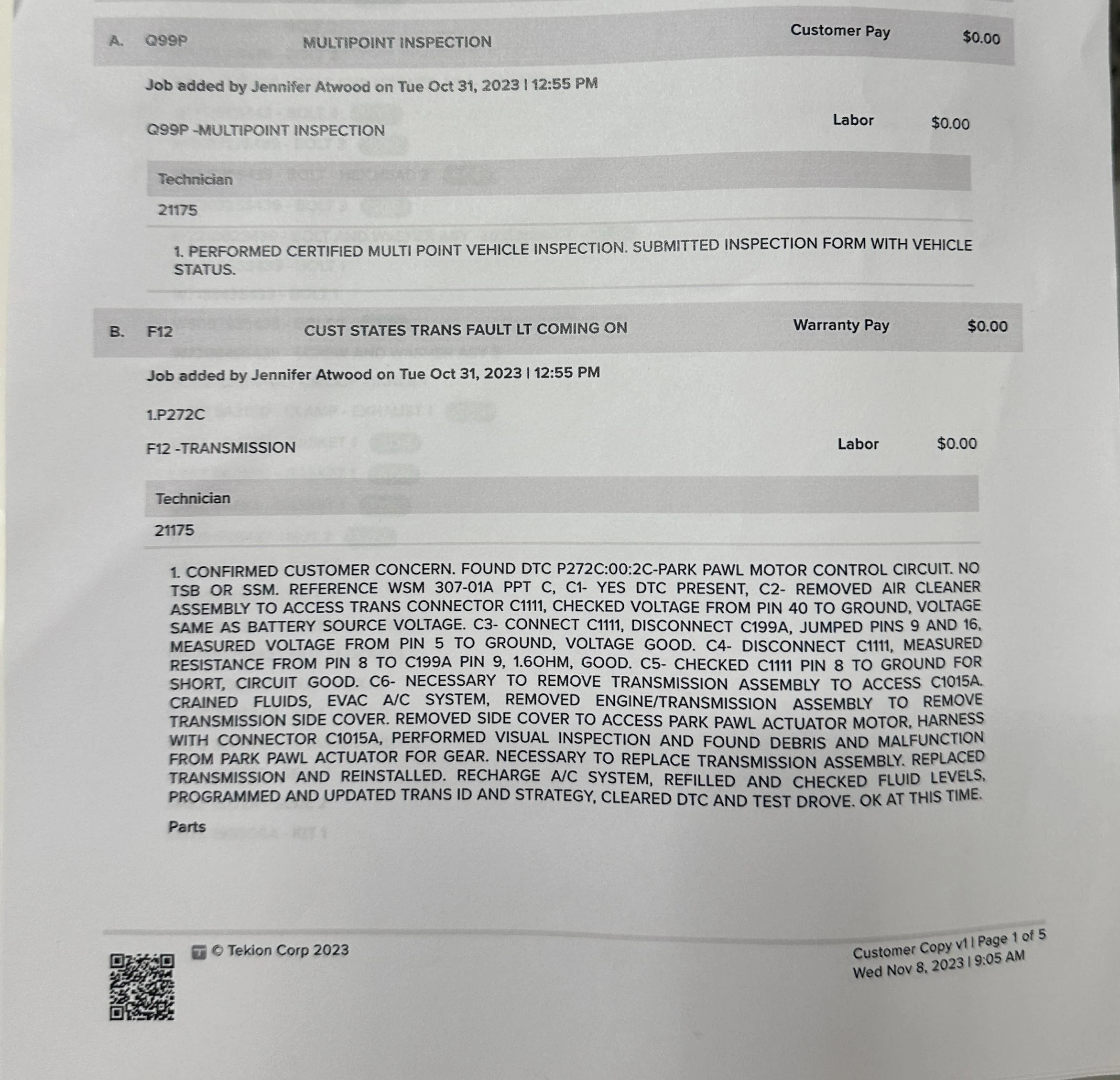

Good news, just picked mine up from the dealer. Seems to be working now. They installed a new Transmission. They opened up the old one and found a bunch of debris around the shift prawl motor. I’m not sure if it’s left over from manufacturing of if something failed leaving it behind. Ford wanted the old one back to see what’s going on with these failures. I’ll post the service tick tomorrow . Most of the parts were one time use bolts and a new transmission .
Tech Tye
Ken
Oct 10, 2023
213
185
Kentucky
2023 Maverick

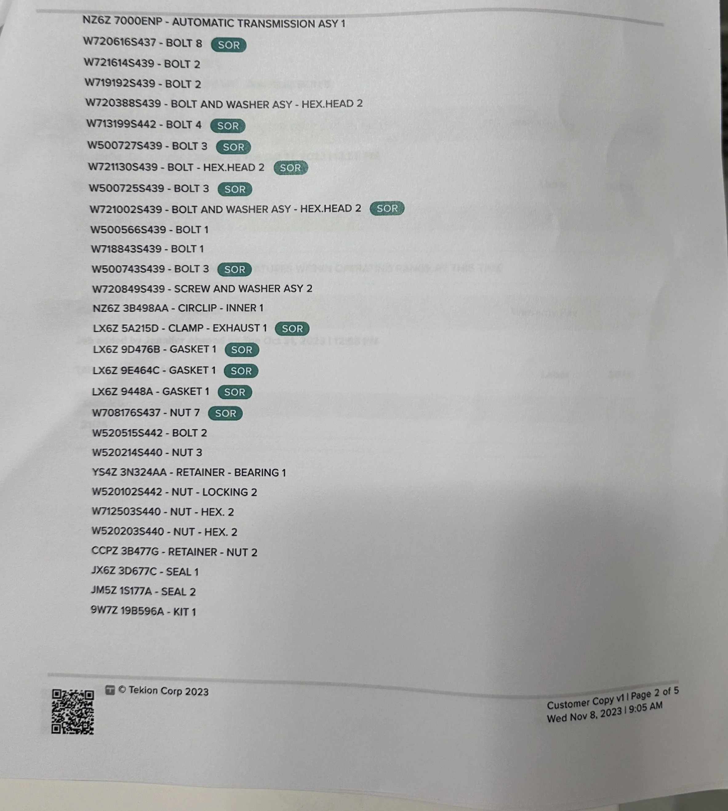

Here is the work order. Plenty of bolts too

What in the world are they, 1 lift for the whole shop?. I would contact the ford person and let them know what’s up with the mom and pop shop that only has 1 lift. Paul miller ford in lex had multiple lifts, just 1 hybrid certified person tho to do the work. So far that fixed my issue by replacing the transmission . I don’t think ford wants them inside of the trans, just order a new one along with 20 one time use bolts. I posted the parts list of all the bolts that were needed.
