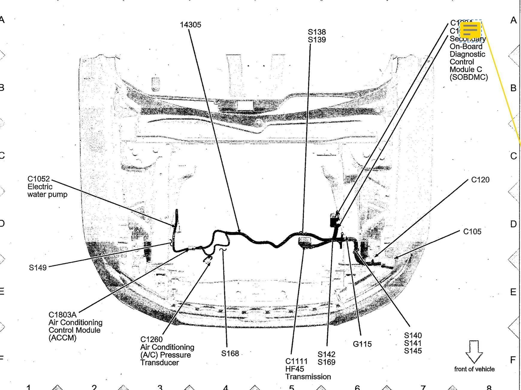

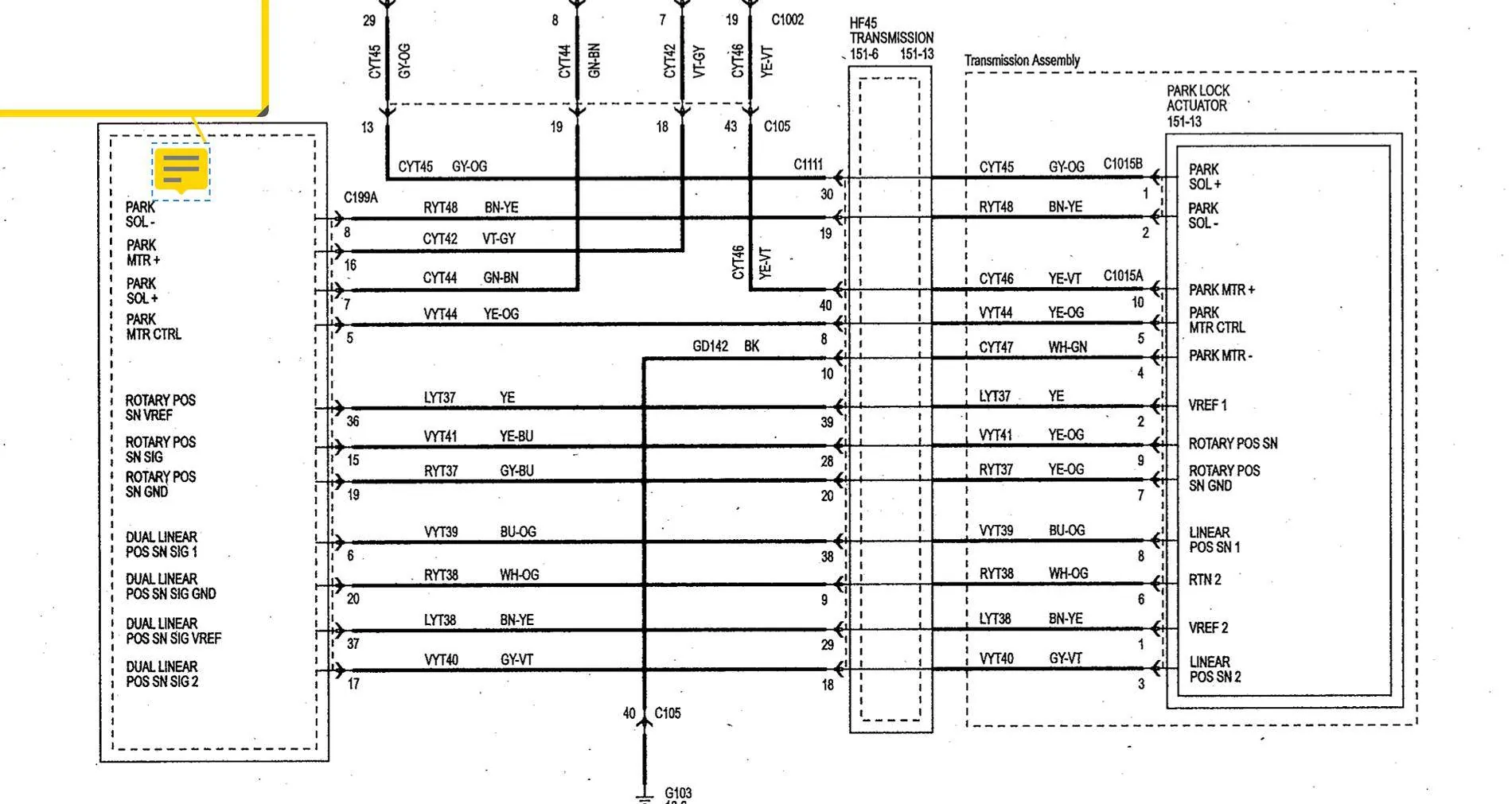

All good, I'll do a reverse a lookup with the electrical diagrams. I'm assuming the two you're talking about are the male/female parts of the wiring harness? Or two different wiring harnesses entirely?
Maverick_Innovation_Designs
Gold Sponsor
Jul 5, 2022
193
247
California, CA
'09 F-150, '22 Maverick
Not yet, I know they are 40 pin latch style. I think there is a BCM in the fend well
I believe it's the SOBDCM (secondary on-board diagnostic BCM). Wiring harness is the one that connects the SOBDCM to the HF45 Transmission, also known as the Battery Cable Harness (NZ6Z-14305-B). Does that look right to you?
