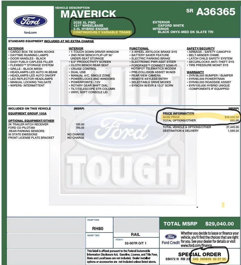

Maverick #1 – invoice date 02/07/2025, price level code 545. This is evidently before a base price increase by Ford. The base price shown is $26,550.00. And in the Vehicle Description, 2.5L Hybrid Engine, Continuously Variable Trans.
Ford Maverick 2025 Hybrids – all with HF55 CVT??? Mav1

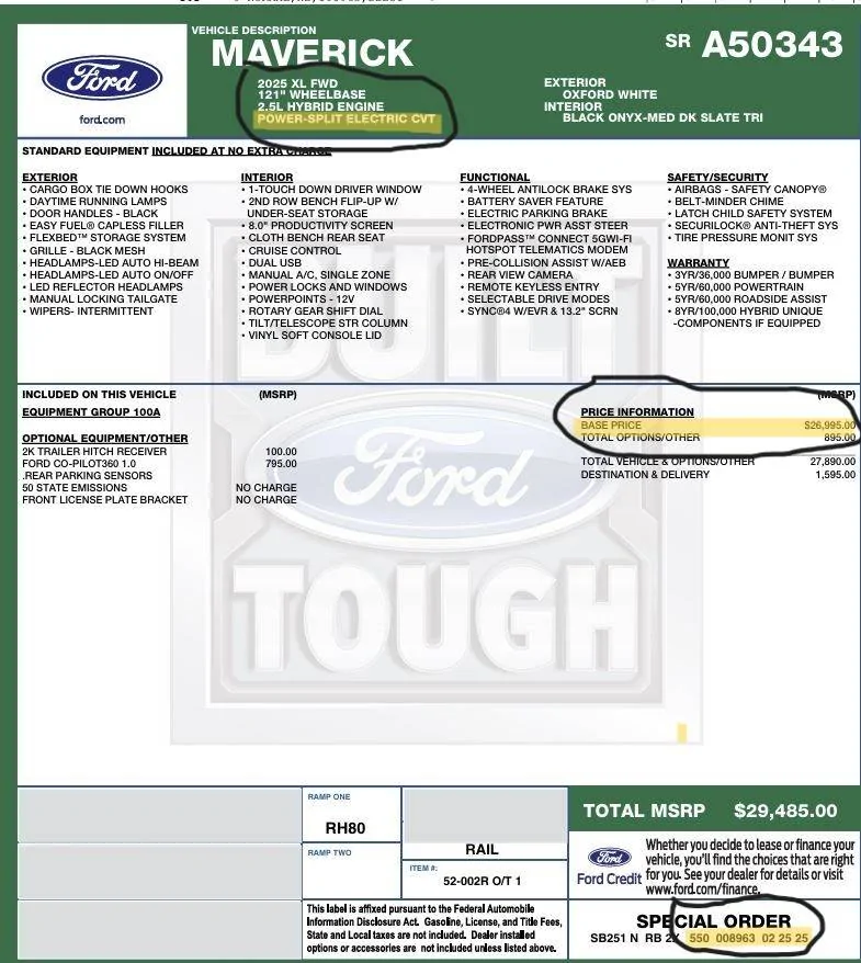

Maverick #2 – invoice date 02/25/2025, price level code is 550 (post-price increase). Base price shown is $26,995.00 (a $445.00 bump). But the Vehicle Description now shows 2.5L Hybrid Engine, Power-Split Electric CVT.
Ford Maverick 2025 Hybrids – all with HF55 CVT??? Mav2
I’d like to assume that ALL 2025 Mav Hybrids now come with the new HF55 and that for some unknown reason Ford decided to change their Monroney sticker wording - but – something tells me the vehicle description was changed for a reason.
Any insights? Looking for something more definitive than opinions.

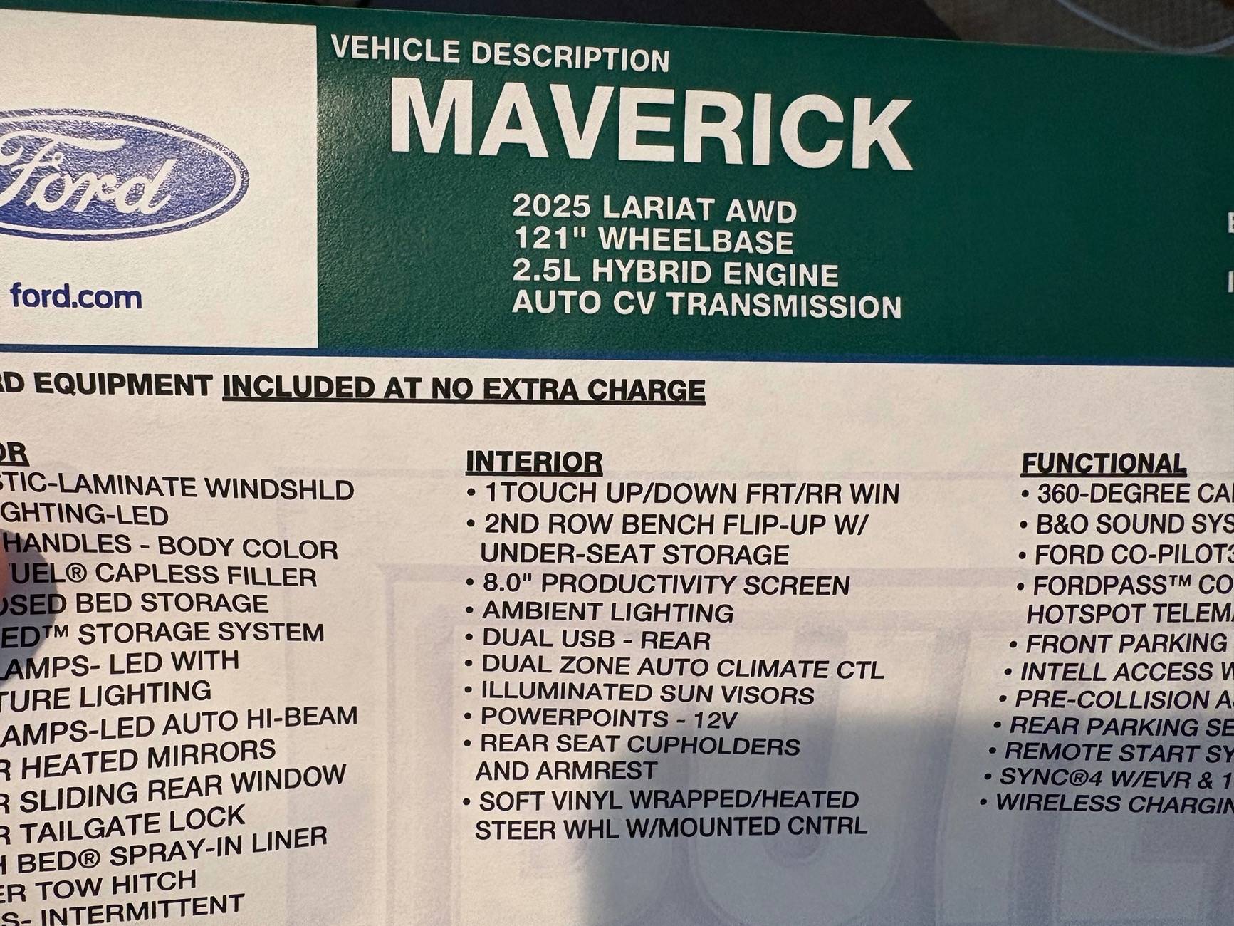

All 2025 hybrids have the HF55 transmission, but interesting that the window stickers are different.
EDIT: It appears Ford cannot decide what to call it. Mine has a third descriptor. This might be the most Ford thing ever
Ford Maverick 2025 Hybrids – all with HF55 CVT??? IMG_8824

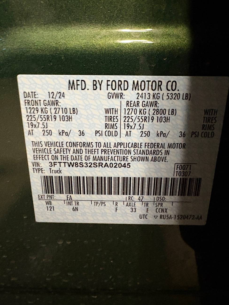

Tony Pandy
Tony
Oct 31, 2024
174
142
2025 Lariat Hybrid, F53 Chassis Class A Motorhome, Acura TLX, '79 280ZX
Ok thanks. Very weird, so at least 3 different Monroney sticker descriptions.
So a couple questions for you:
1. On your window sticker, what's the Invoice Date?
2. On your doorjamb Safety Compliance Certification Label, what's your Transmission Code? My understanding from a 2022 Maverick Identifications code doc is that the HF45 trans code is 5. So yours with the HF55 should be something different than 5.
mavericktruckclub.com/forum/attachments/vin-pdf.40388/
I promise you that all 2025 Hybrids have the HF55.
Lariat with 4K Tow Pkg
Mfg date: 01/25
WIndow Sticker Date: 12/18/24 (Special Order)
Trans Code: "E"
Axle: 33
