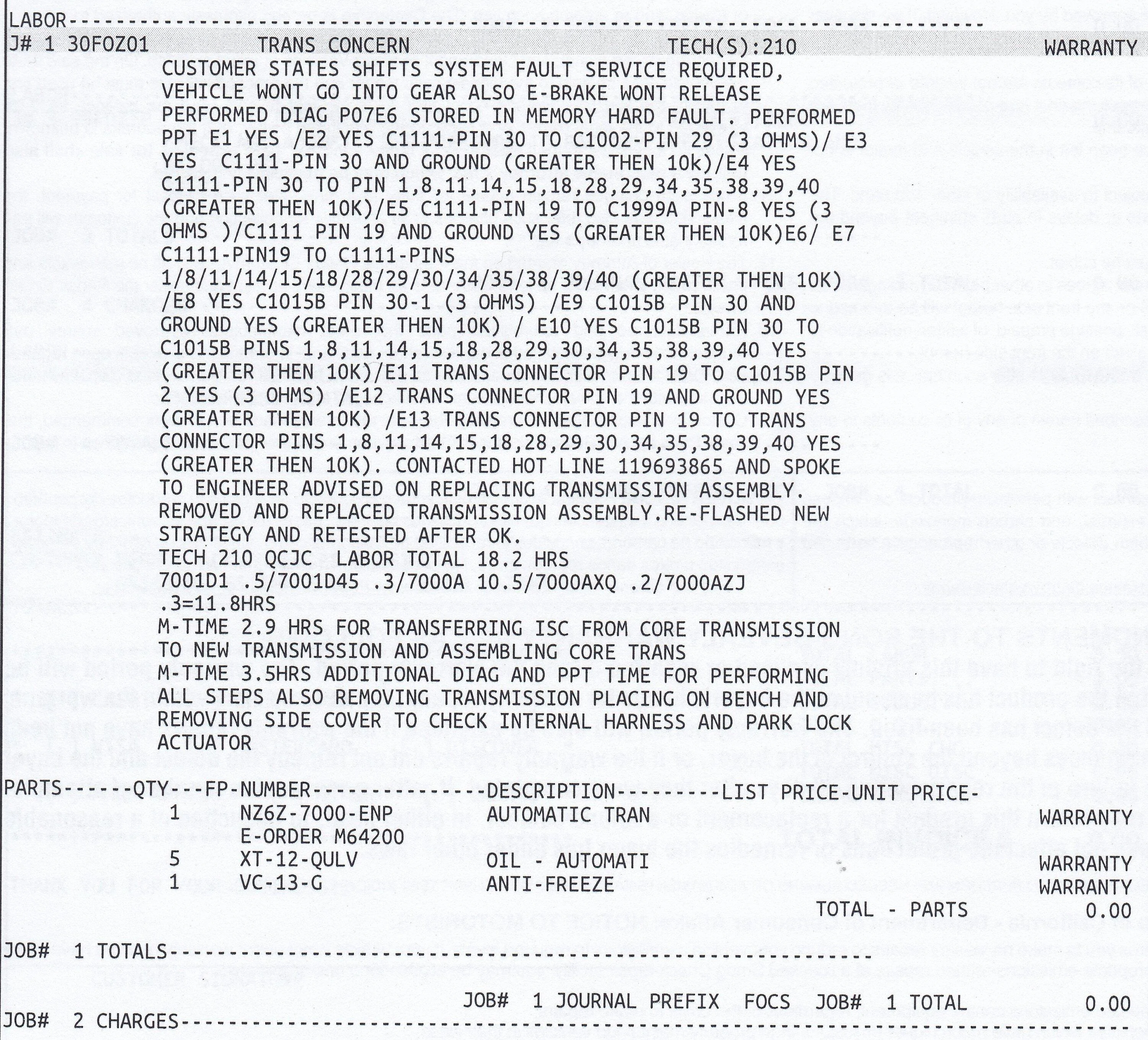

I’ll attach the repair info at the bottom for those curious folks. The Tech working on my truck had a thought after he completed the transmission install… he would have liked to change out the emergency brake actuator to see if that was the culprit. That was one thing that was not tried before installing the new trans. Guess we’ll have to wait for a new Ford service repair bulletin after the Ford engineers (that didn’t retire), identify the cause of the ‘Shift SYS Fault’ by dissecting my old CVT transmission.
Ford Maverick Shift SYS Fault - Service Required (Hybrid CVT) New Trans info

Same P07E6 engine code as OLDguy66. Same result - new ECVT transmission installed. Received vehicle back on 12/16/22. No problems so far.

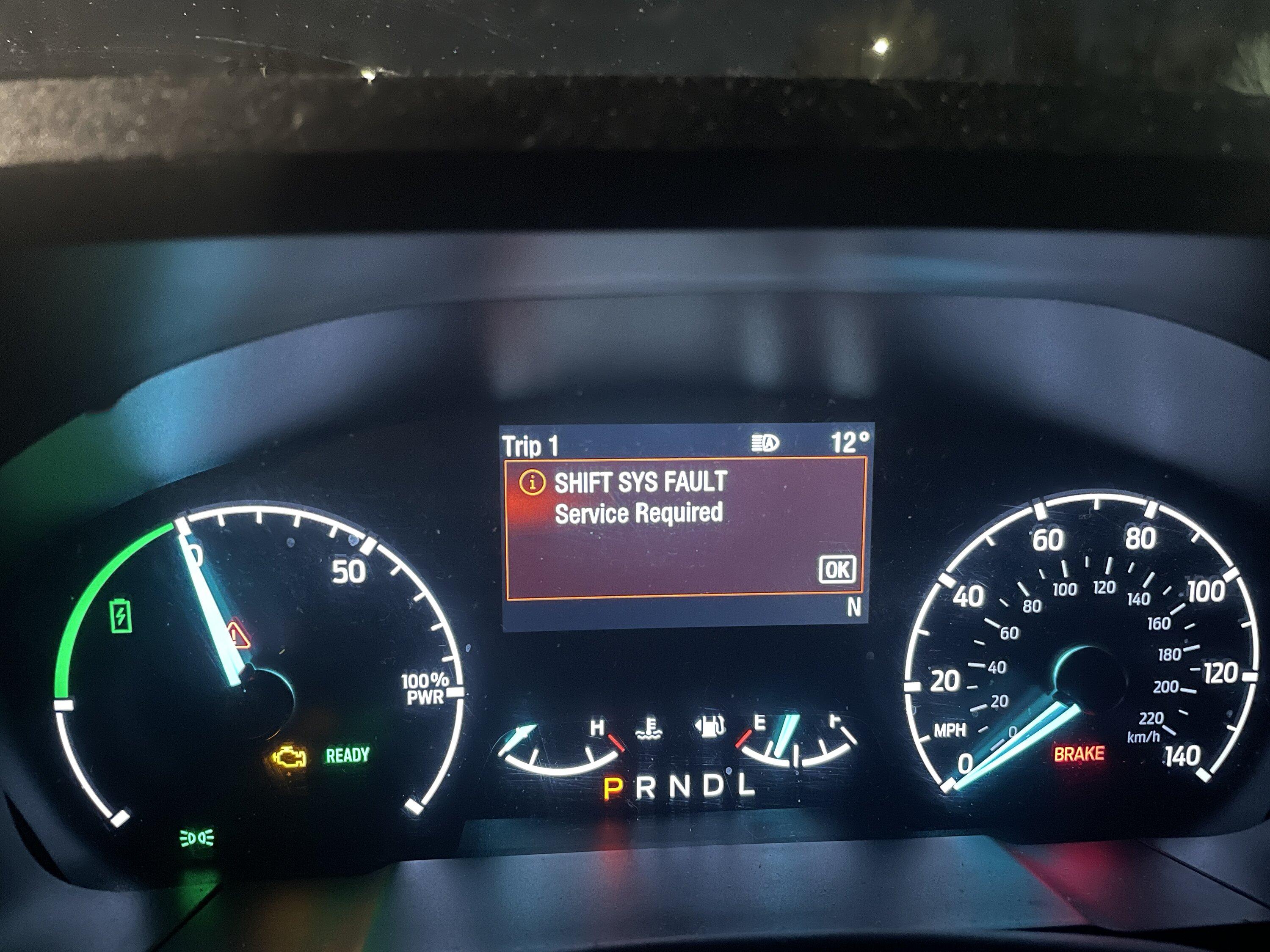

Just got the same error on mine. I can’t say that it’s heat related because it’s 0 degrees Fahrenheit right now and it hasn’t been driven in 3 days. I now have a parking brake error, shift sys error, and constant deep sleep warnings. It has never died on me but I’m not sure I can trust driving it now. Sticking with the F150 until the dealer can get me in next month.
