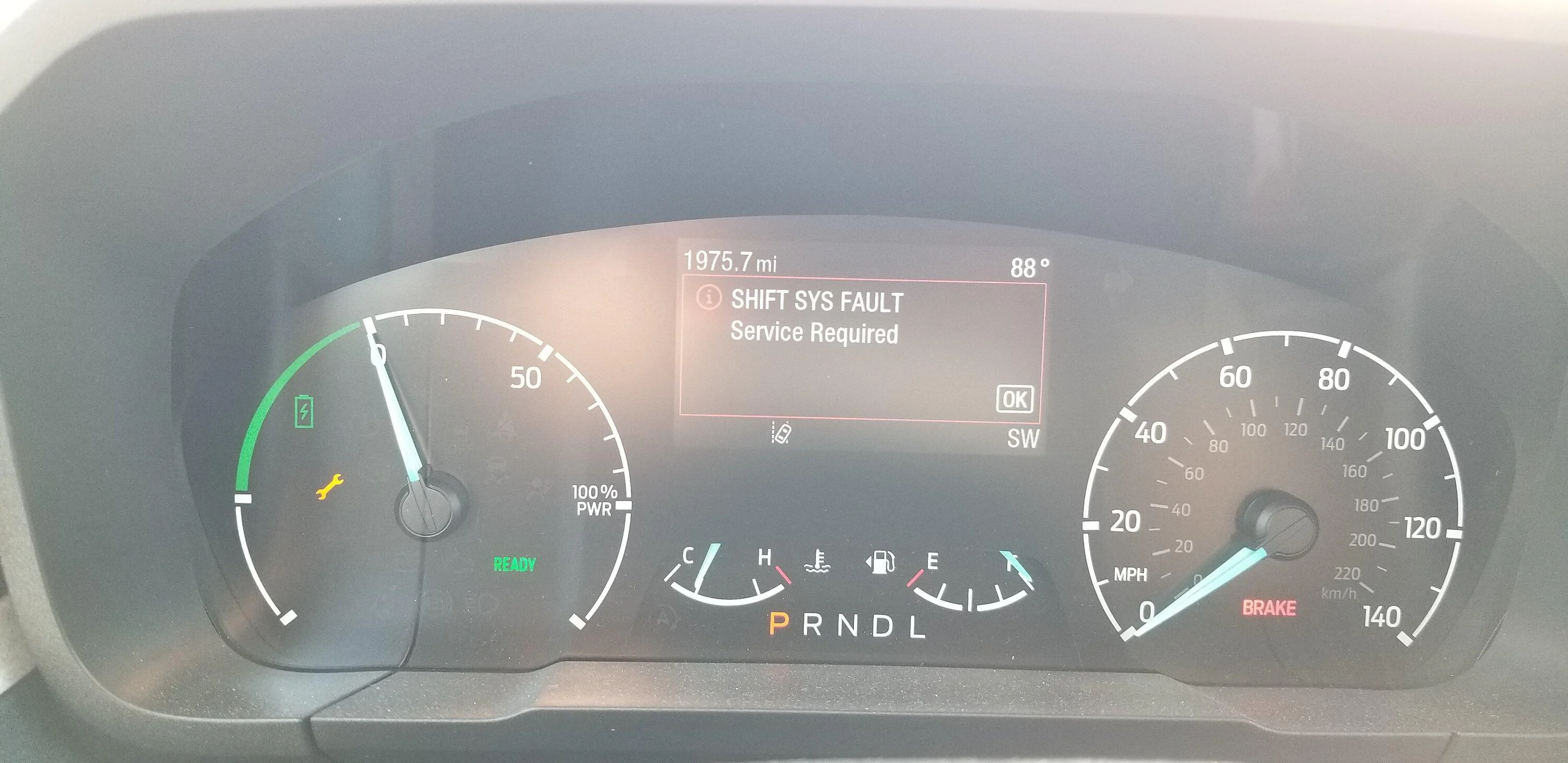

Anyone getting this "Shift SYS Fault" - "Service Required"? (Hybrid CVT)
When I turn the gear shift selector to "D", the parking brake comes on (and will not release), the "D" light flashes and the fault warning comes up on the display. Taking the key out and retrying several times doesn't help. If I get out of the vehicle and let it sit for 10 minutes then try, it tends to work and I'm on my way. Seems like it happens after a few stops around town and then it sits for 30 - 45 mins. This has not occurred when it is cold (first start of the day).
This has happened 6 times over the last 3 weeks so, I'm taking it in for repairs. (If the Service Dept. at Aaron Ford will ever answer or return my calls. They are the worst!)

Hi there, I'd be happy to look into your Maverick's shifting issue. Will you send us a message with your VIN and dealership info? I can look into things on my end.

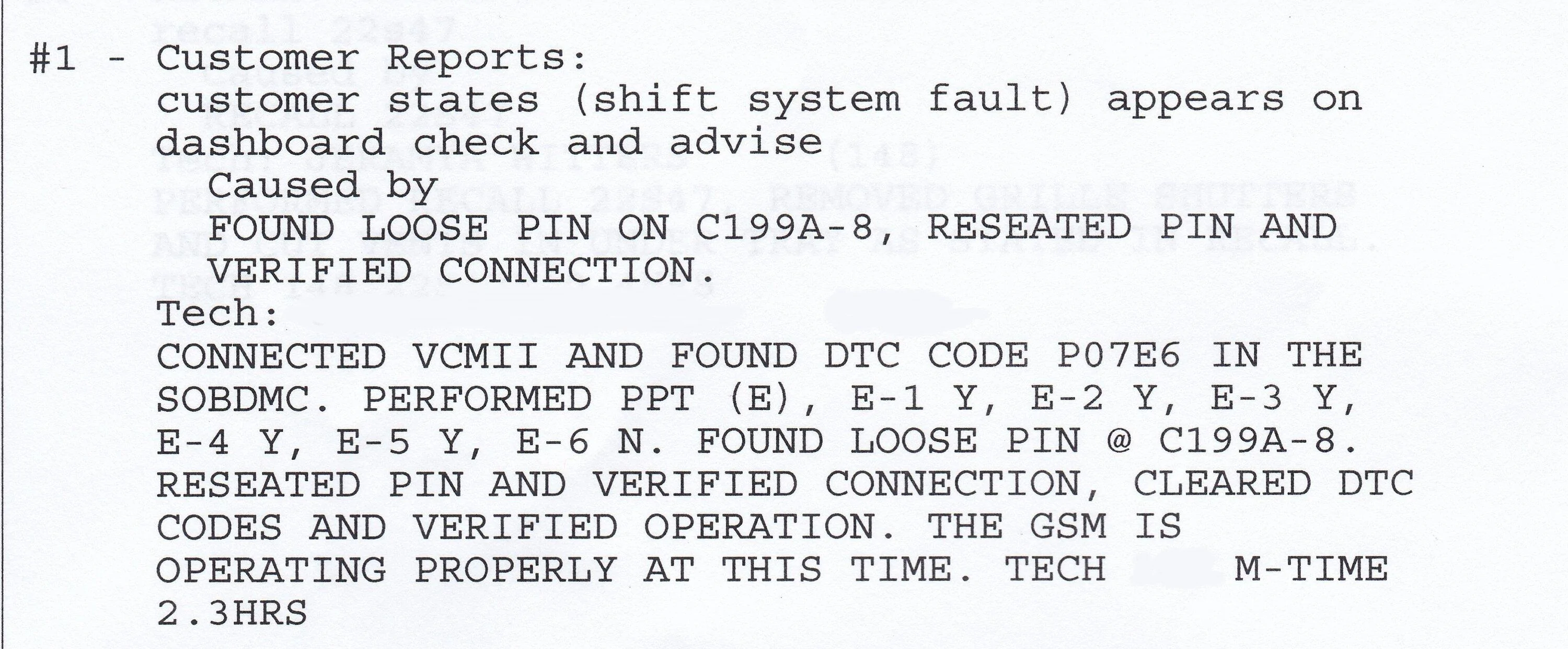

I got my Maverick back from repairs. Here's the report in case anyone else has this issue. I'll update the post if it Fails again.
Ford Maverick Shift SYS Fault - Service Required (Hybrid CVT) Shift Fault Fix

I agree with The Weatherman, the issue with my truck was a loose connection to the GSM (gear shift motor). Once it shifted into Drive, everthing worked until it shifted to Park and then failed to shift out of Park. There was never any "Charging System Errors".

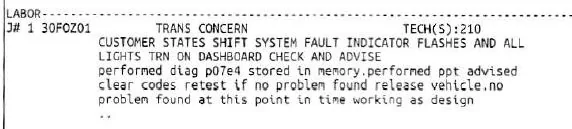

So I took my Maverick back to the dealer (Sept 13), they had it for a week and advised that there were "no active faults" and everthing "works as designed" - - come pick it up (Sept 19). Also, to bring it back if it happens again. So, after a brief rant, I got into the Maverick to go home and lucky for me, the gremlins woke up. The "Shift SYS Fault" happened right there at the dealer for the 10th time since I began counting.
I didn't get a loaner car but they did give me a ride home.
The truck only has 2,312.7 miles and gets 20 MPG in town but somehow gets 34 MPG on the highway. Seems like this Fault triggers the system to go into emergency, reduced power mode in city driving. So, it's unreliable and gets lousy gas mileage. I wish Mr. Farley would get me a dependable Ford. Does anyone have his cell phone number?
