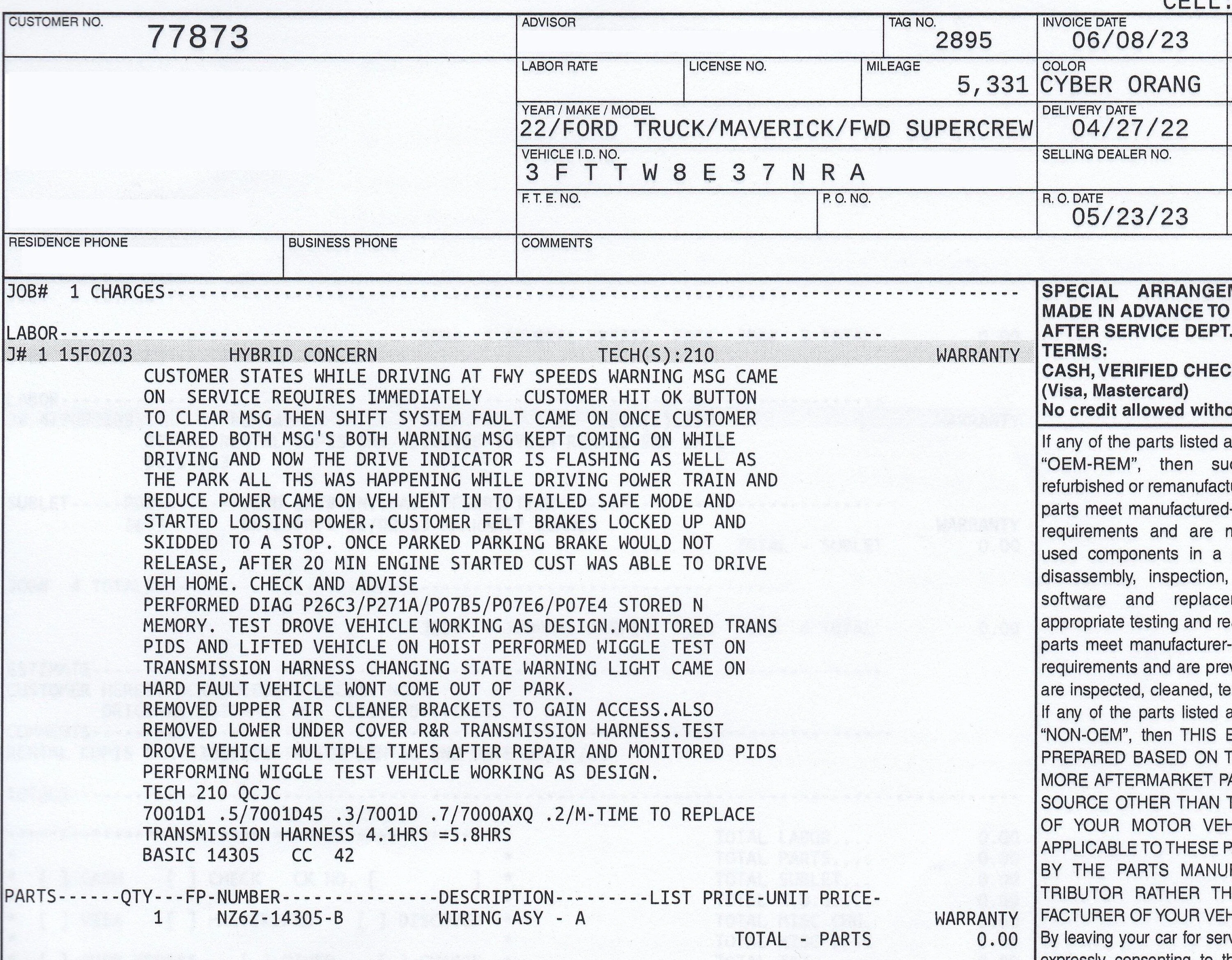

Hello, Jon! Send us a private message with your VIN and the name and location of your local Ford dealer. I’d be happy to see what I can do to assist with this concern. Thanks!Just got the same error on mine. I can’t say that it’s heat related because it’s 0 degrees Fahrenheit right now and it hasn’t been driven in 3 days. I now have a parking brake error, shift sys error, and constant deep sleep warnings. It has never died on me but I’m not sure I can trust driving it now. Sticking with the F150 until the dealer can get me in next month.
