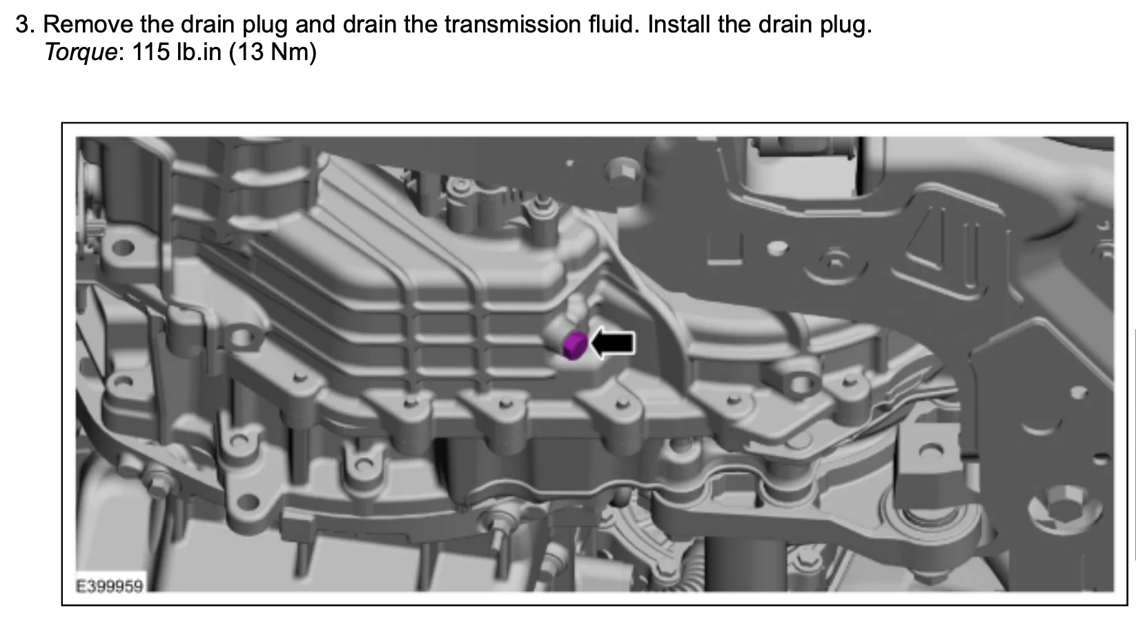

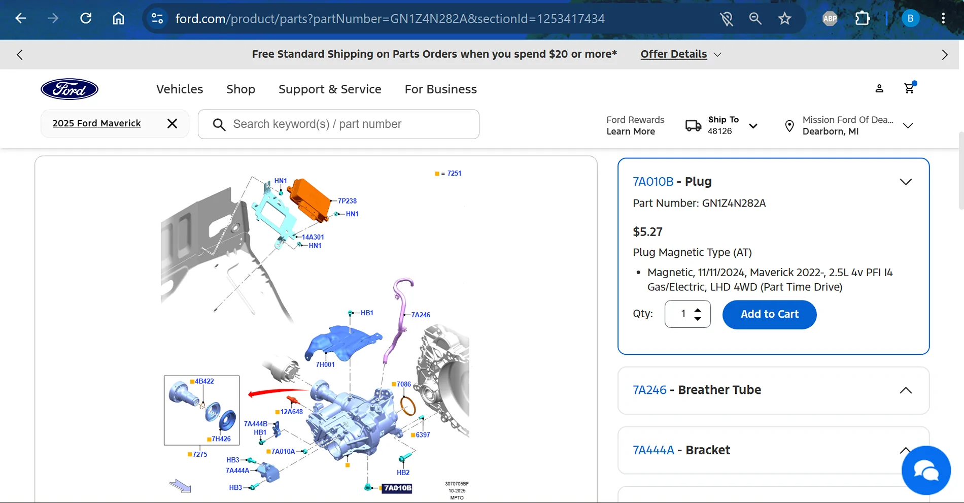

Thanks, BK007. Unfortunately, that's not the correct plug. That one is a magnetic drain plug with a 3/8" square ratchet drive head. Here is a screenshot of the plug from the service manual...
Ford Maverick What size/part number is the drain plug on Hybrid e-CVT? Image 8-7-26 at 6.13 PM
This is a magnified view...
Hmm.. That's strange. Is your eCVT a HF45 or HF55?

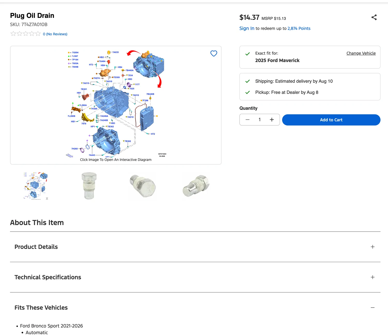

Maybe something similar to 7T4Z-7A010-B? That's what they show for the Ecoboost 8F35 transmission?
Ford's consumer-facing parts site is awful, I would go to a dealer parts counter or at least call them.
ETA: Another thing, I'm guessing there is a separate fill and drain plug?
