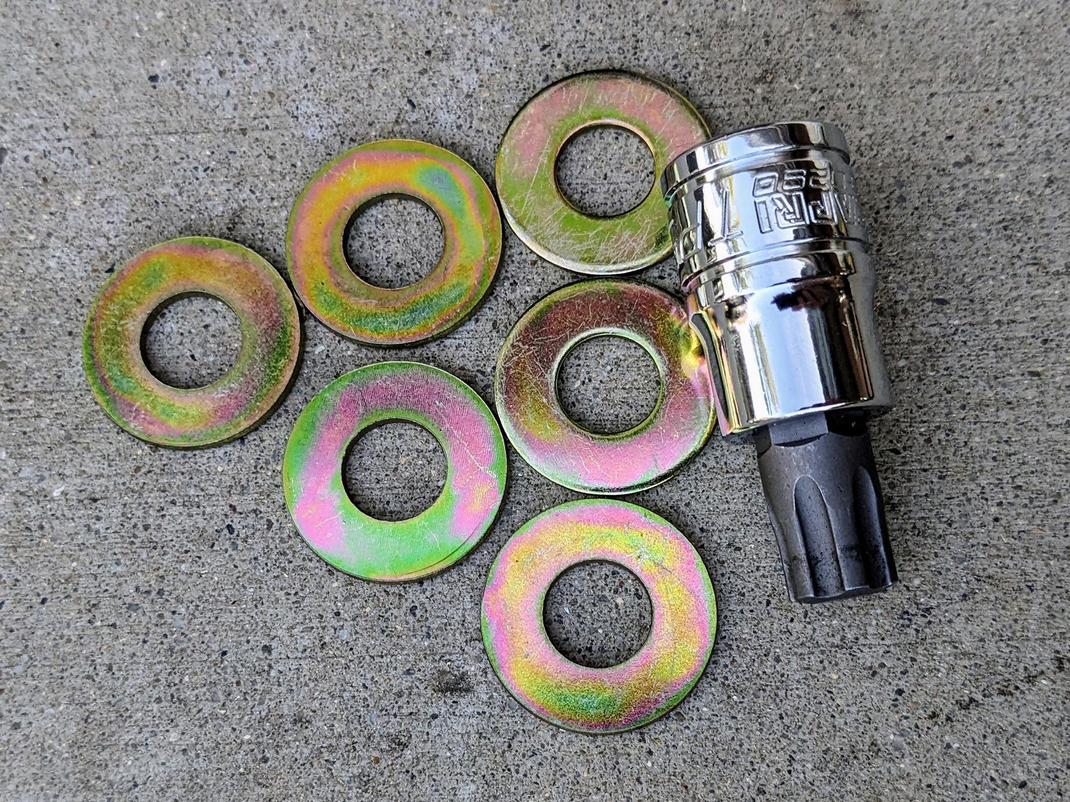

20 mins, including getting tools out and putting them away, and my driver's seat is more comfy.

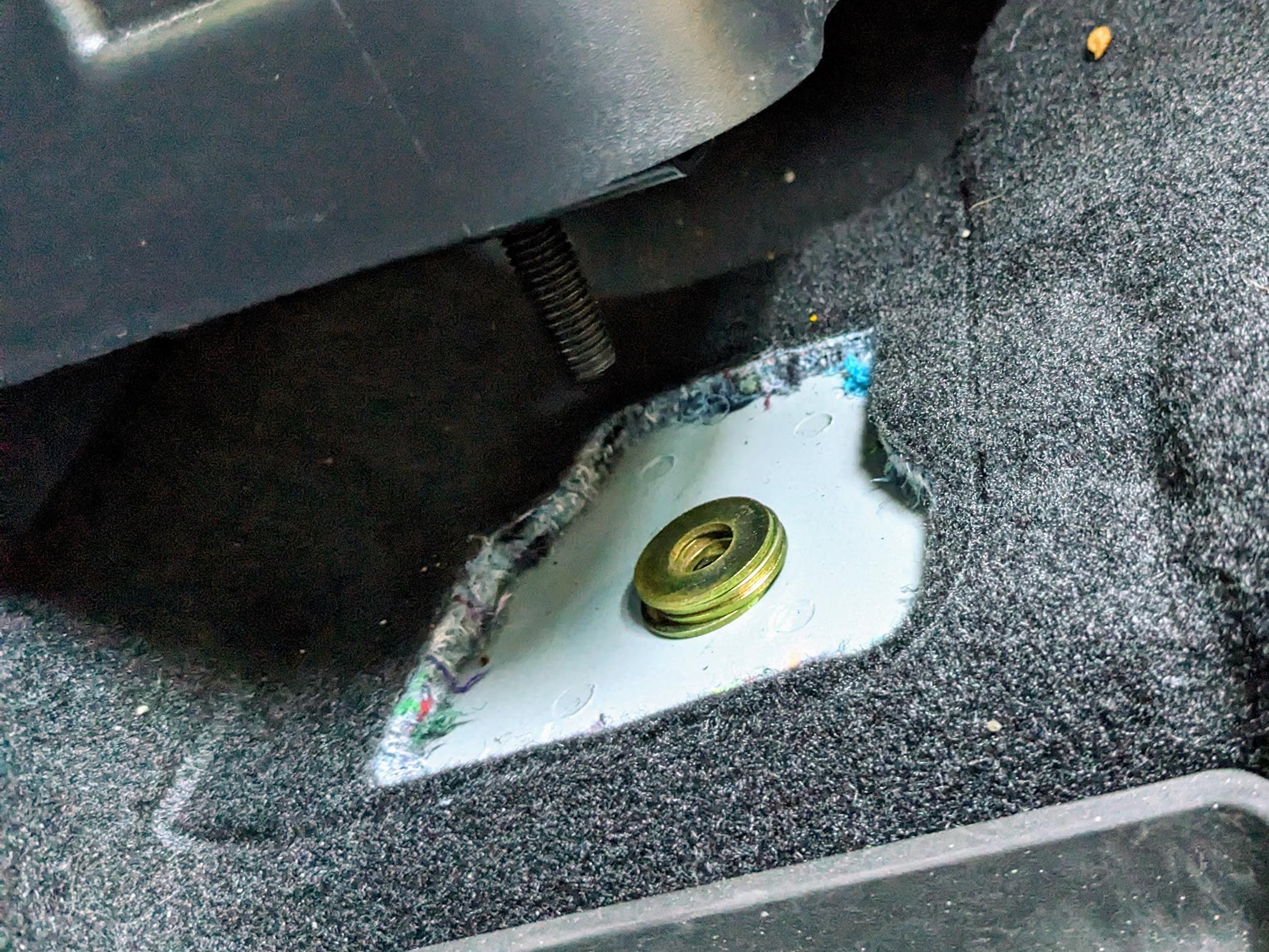

I ended up using 3x of the washers on each bolt. Tried 4, felt like too much. So just under a 1/4" lift is all. Reusing OEM bolts and not worried - the seat jackers instructions said you could reuse bolts with a 3/8" lift.
*SOLD* $8 if someone wants the Capri TP55 bit and 6 washers mailed to them, enough for one seat.
Ford Maverick Seat Jackers - anyone installed? PXL_20240419_010532330
Pic is 4 washers - felt like too much, enough so that I redid it - super easy compared to my VW 8 years ago.
Ford Maverick Seat Jackers - anyone installed? PXL_20240419_012647831
edit - instructions:
Slide seat forward/back for access.
Small / thin screwdriver to pop off the covers to access bolts.
Loosen rear ones first, to give some play.
Remove front bolts, seat tilted back and stayed perfectly, allowing easy lining up of washers. Put bolts back in and try to line up everything as you lower it.
Snug front bolts, tighten rear, then go back and tighten front.
My torque-wrist estimated ~40lbs was just right.
