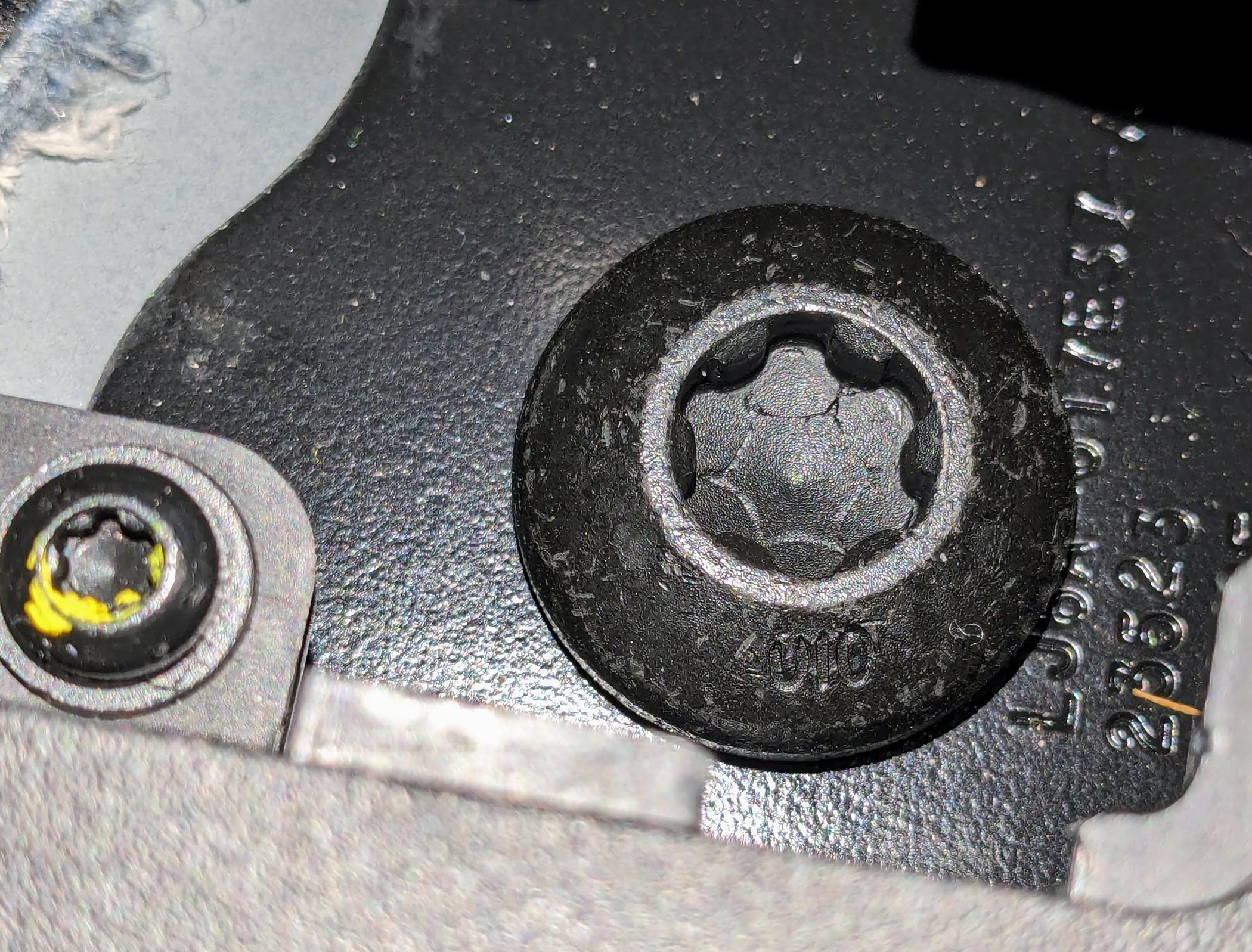

for $10 I'll try it...
3 washers per bolt gives ~1/4" lift. Or I can do 4 on drivers side and 2 on passenger. The seat jacker instructions state you can reuse the factory bolt with the 3/8" / single lift, so that was good info.
Ford Maverick Seat Jackers - anyone installed? husky-sockets-h3dhbst55-64_65
Husky 3/8 in. Drive T55 Torx Bit Socket
Qty: 1
$4.57
Ford Maverick Seat Jackers - anyone installed? flat-washers-807108-64_65
Everbilt 3/8 in. Yellow Zinc Grade 8 Flat Washer (3-Piece)
Qty: 4
$5.00
EDIT/UPDATE
looks like it should be a T55 PLUS bit.
https://www.mustang6g.com/forums/threads/front-seat-torx-bolt-size.135488/
https://www.jeepforum.com/threads/oem-bumper-hook-bolts-not-a-t55-but-a-tp55-bit.3578282/
Ford Maverick Seat Jackers - anyone installed? PXL_20240408_192947310
Might have to order it online.
