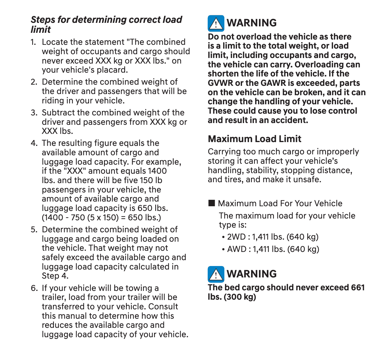

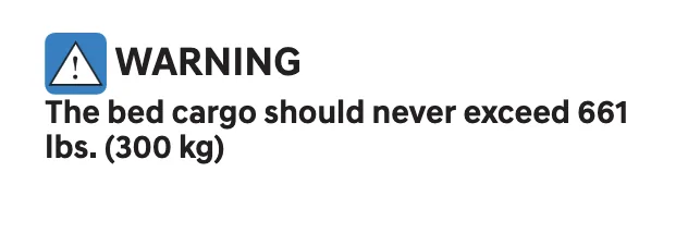

Hyundai says, in the manual, that the bed cargo should never exceed 661 lbs. It's page 6-67 in the 2023 owners manual.
Ford Maverick Santa Cruz, really??? Screenshot 2023-03-09 at 11.10.01 PM
Ford Maverick Santa Cruz, really??? Screenshot 2023-03-09 at 11.10.15 PM
This is clear. Total payload applies to the entire vehicle, including the passenger compartment. Hyundai is making it very, very clear you cannot put more than 661 lbs in the bed though, regardless of the amount of weight in the rest of the vehicle.

Read the preceding information to the warning which number 1 thru 6 and they tell you clearly how that number was calculated that they used 661. 1411 payload minus 5 passengers at 150 lbs each ( 750 pounds total) and subtract it from the 1411 payload and the number comes up 661 pounds...wow what a coincience...

I've read the whole page. I don't think you understand the context of the warning.
But go ahead and put more in there. If you want to break your Santa Cruz by consistently ignoring the limits clearly listed by the manufacturer, I won't stop you.

Like even if the manual is wrong about it, wouldn't that make it worse? If they're printing inaccurate documentation (even while slightly updating it), why should you trust any of the truck's stats they say?

It's funny how Ford Fanboys can't add 661 and 750 for 5 150 pound passengers and come up with the payload rating of 1411. Here you go at the approximate 5 minute mark and watch the message from Hyundai in the split screen

See, I know that. But then they didn't clarify that in the 2023 manual.
In fact, they made it even more clear that you should only put 661 lbs in the bed.
What that means is that either you can only put 661 lbs in the bed, or Hyundai's documentation team can't be trusted. Neither is a good look -- and in any case no one should be blamed for "spreading misinformation" (which is what this whole discussion was originally about) when it's in Hyundai's documentation.

It was explained but a number of folks on this site wouldn't listen and ignored it. It was explained how they came up with the 661 lbs which aligned with what many of you argued about when it was explained to you . So now there is no argument Hyundai wrote this reviewer and explained it. The Payload is on the door sticker. In my case 1411 pounds payload and I could have it all in the bed sitting in my driveway with no driver or passengers . So there you have it. The bed can take 1411 pound payload on the top model 4WD loaded truck and more on other level models.

Yet they continued to print an UPDATED version of the same warning in the 2023 manual long after that review.
As I said, this discussion started because someone said the source of the misinformation was from "ford fanboys," when it comes from the current documentation supplied by Hyundai. My objection was to someone thinking anyone seeing that warning was at fault for believing it.
Regardless of whether it's true, you should be asking why Hyundai is still printing this warning still long after they've "clarified" it. And your issue should be with Hyundai continuing to put it out there.
