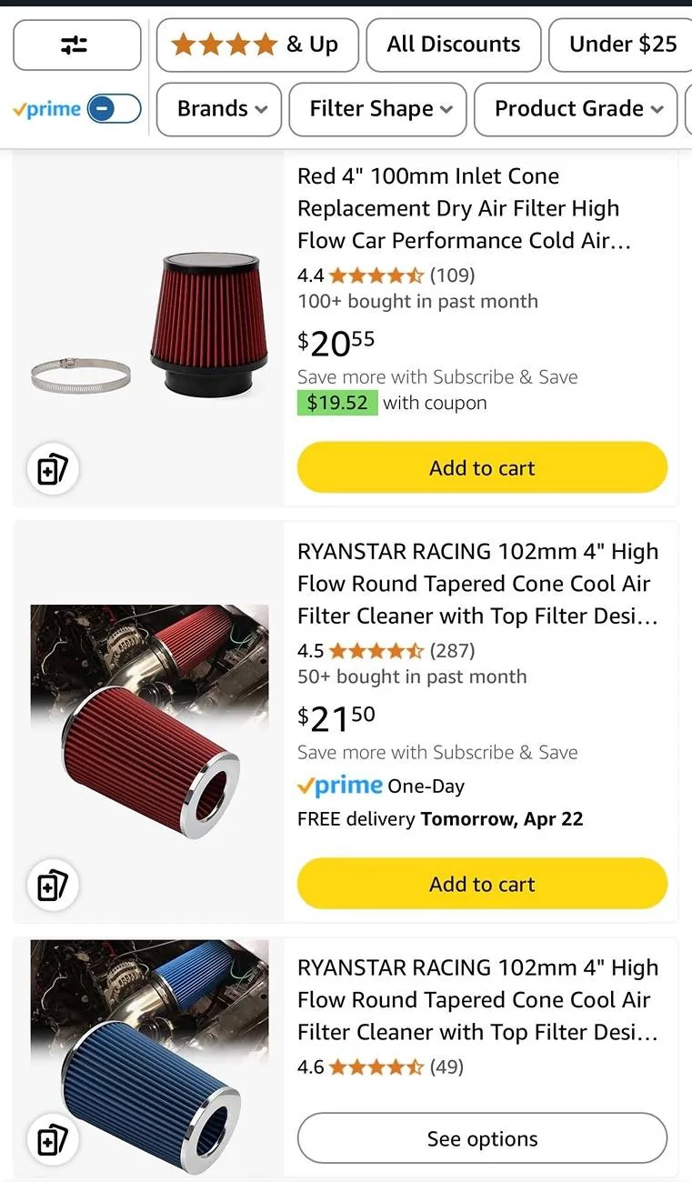

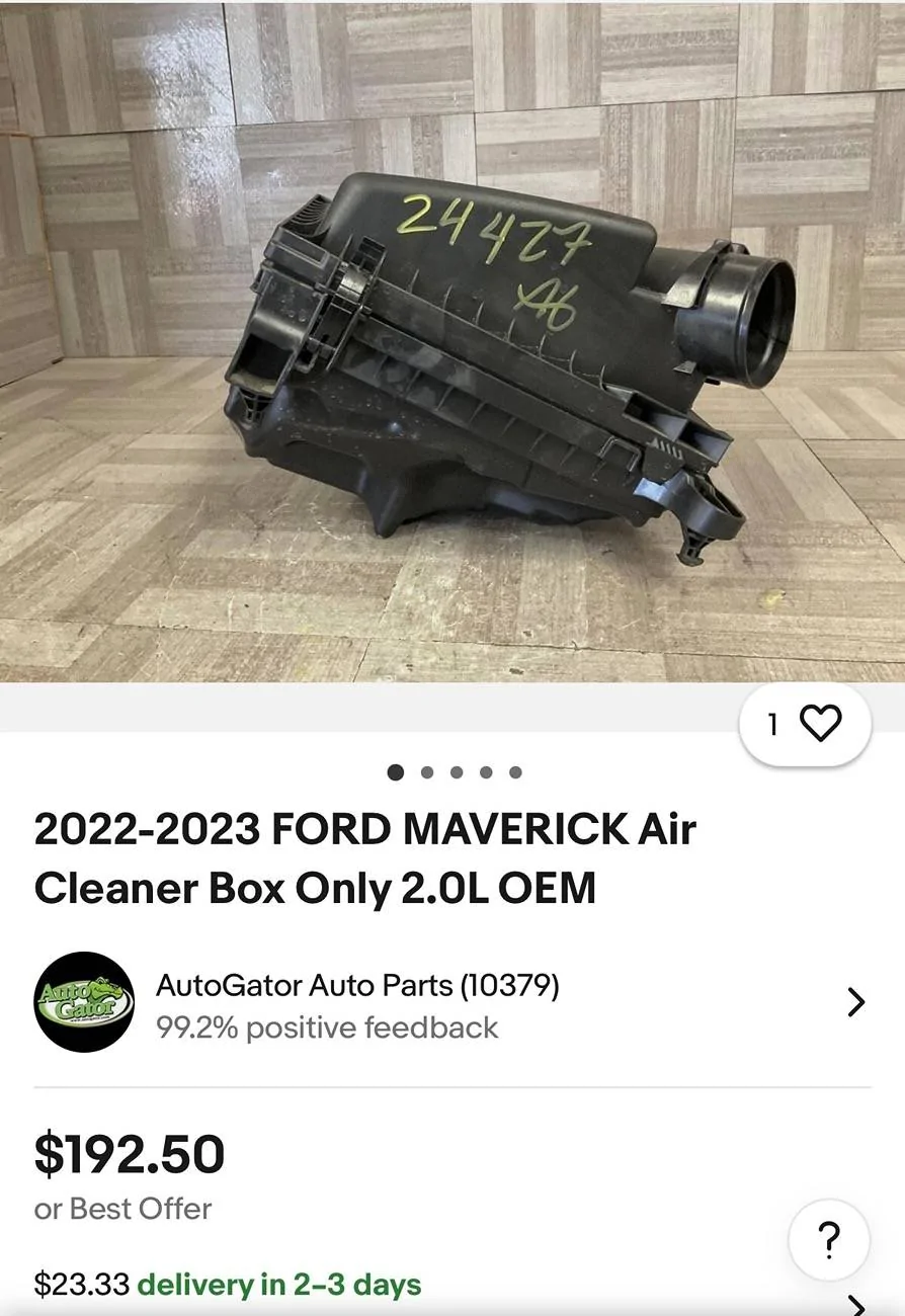

Here’s your solution:
You remove this
Ford Maverick S&B intake installed. What a difference IMG_2271
And install this:
Ford Maverick S&B intake installed. What a difference IMG_2272
The only time “it’s not legal” comes into play in California is when getting your smog certificate to register your car with the DMV. New cars are exempt for the first 8 years, then you get tested every 2 years.
When you need to get smog tested, put the stock air cleaner box back on. Don’t even bolt it in. When smog test is complete, put the open element air cleaner back on.
A $20 open element filter gets you the same results as a $350 cold air intake: increased intake sound and no change in power output over the stock configuration.
The stock filter flows all of the air that the engine can take, with virtually no restriction. Any claims of +25 hp or whatever, are just made up. If you could get 25 extra hp from a bigger air cleaner, Ford would have already done that. When your 250 hp engine costs $5,000 per unit to make ($20 per hp), an extra 25 hp is worth $500. A bigger air cleaner box would only cost $20 more than the one they are already using. It is a no-brainer for them to put the correct size air box on the vehicle. They may have made those type of amateur mistakes in the 1950’s, but that was 75 years ago.
And the whole “but it is a COLD AIR intake” argument doesn’t bear out any change on the dyno. It’s true that the power output is dependent on the intake temperature, but in a turbo engine with an air to water intercooler, the intake temp is ~170F, regardless of whether you’re getting 70 F air from the fender or 110F air from under the hood.
