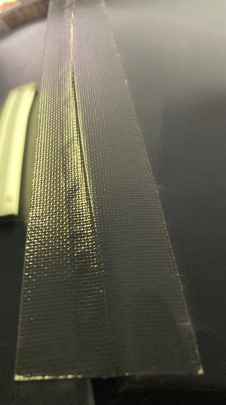

Unfortunately, there have been a few other posts from members having the same issue. One less serious than this post and another one worse. The member with the big bad bubbly spot was having issues with his dealer if I recall correctly.
After reading those threads I put some gorilla tape on that gap. Could cause problems instead of prevent? Anyway, I’m going to peel it off soon. BTW, I used to have tape holding my eyeglasses together. Genuine Nerd…🤓

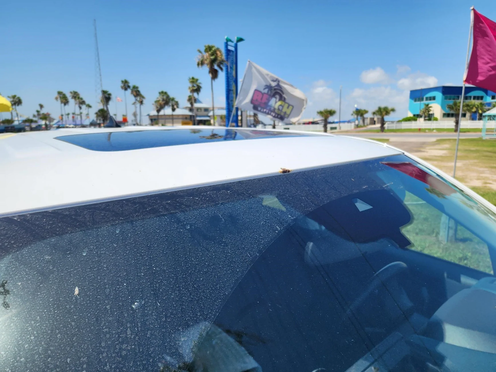

GenMaster
May 25, 2026
122
251
Victoria Texas
2026 Ford Maverick XLT Hybrid
Not sure how to treat this and living on the salt water doesn't help, so looking for a remedy to repair/fix this....
That's all from living in South Padre? I'm in Victoria, 35 miles inland. I see zero rust here. Whew. Good luck 🤞

This can't hurt anything as well. Go to a reputable, independent body shop first. Get a formal written estimate from them, and explicitly ask the shop manager to write down their professional opinion on what caused it and whether it rotted from the inside out.
Take that official paperwork straight to the Ford dealership with you. When you have a professional body shop backing you up stating it's a structural failure/perforation issue, the dealer can't just casually brush you off and claim it's a regular old rock chip that caused the damage.
Outstanding suggestion, thank you so much!
