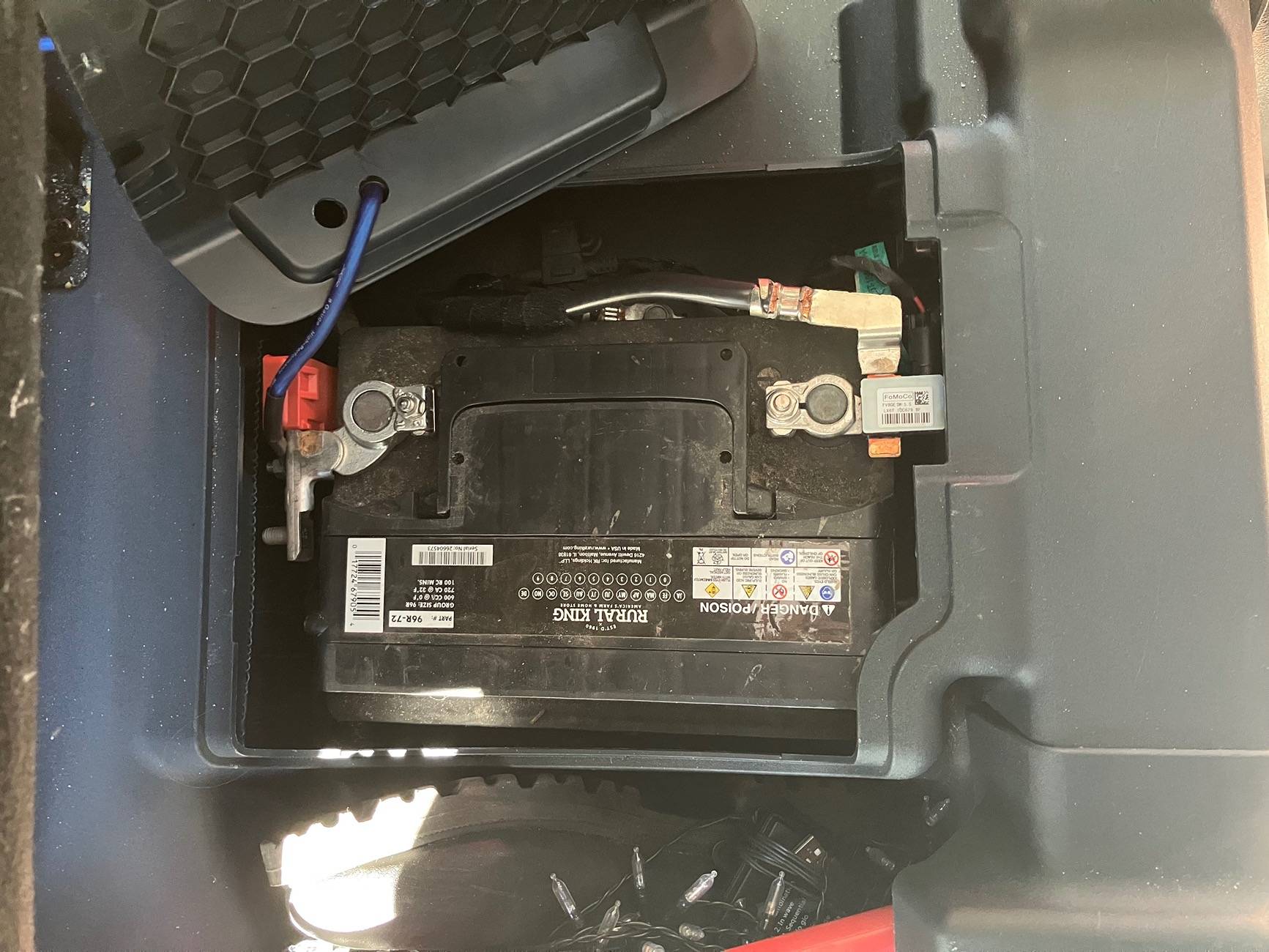

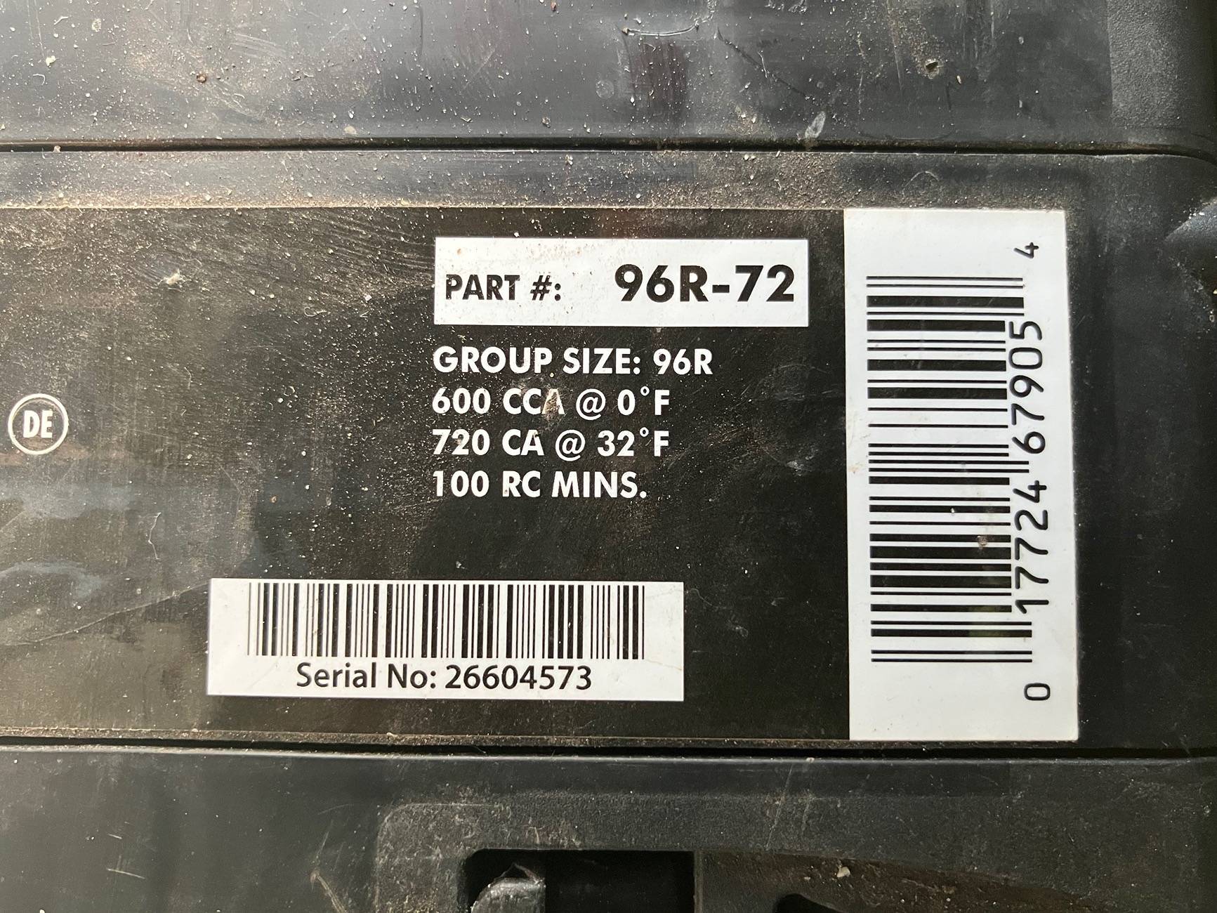

I’ll get an AGM battery eventually, but I had a Ford battery laying around and decided to try it. If anyone also wants this battery, it’s still FLA and larger (size/cca/etc), but still fits.
$99 at Rural King.
