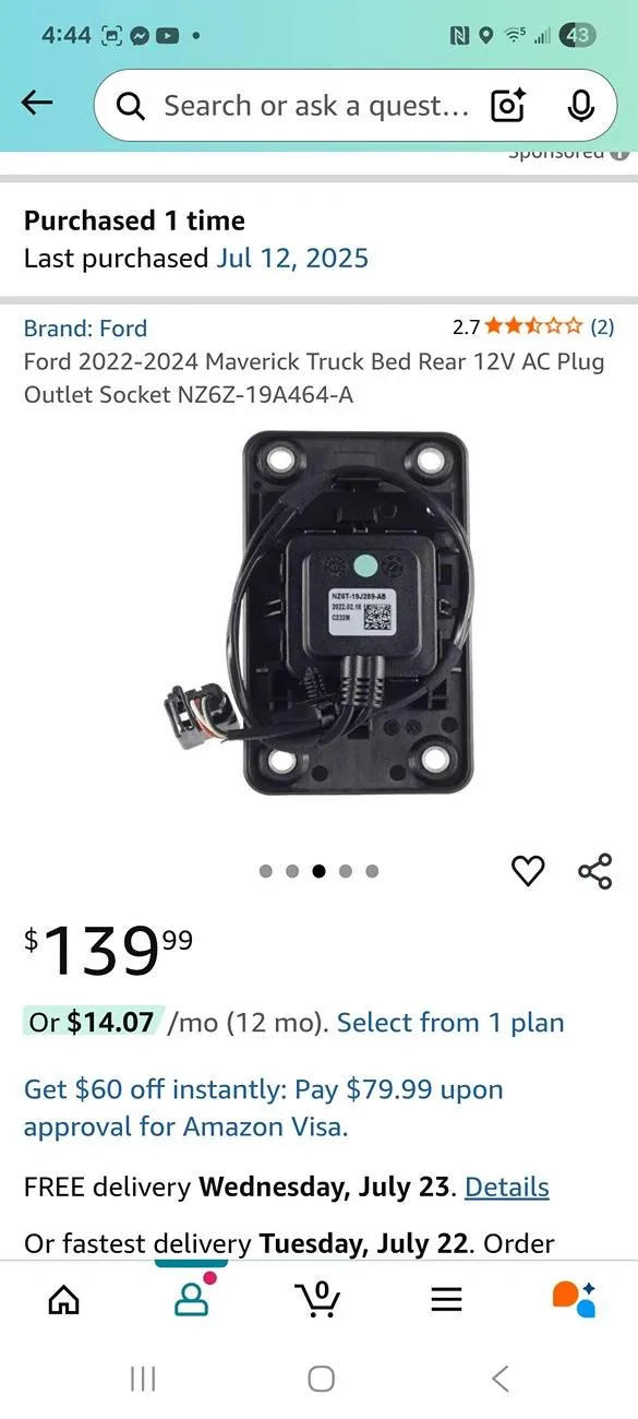

Is it your understanding that this kit includes the inverter, and all you need to do is feed 12V DC to it (like the FlexBed tap)?
HRG

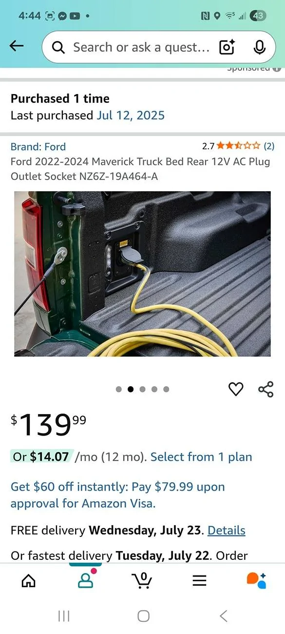

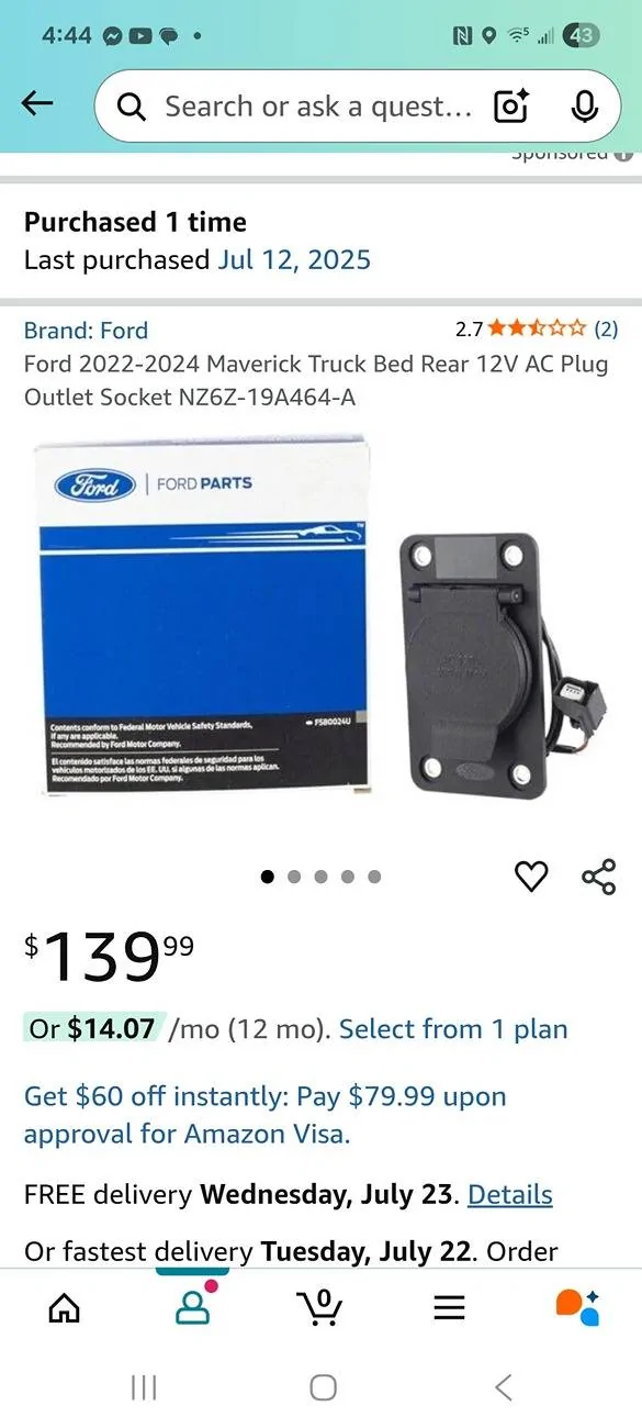

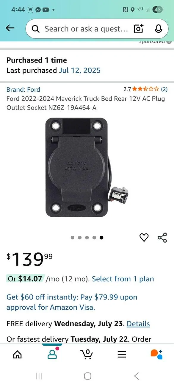

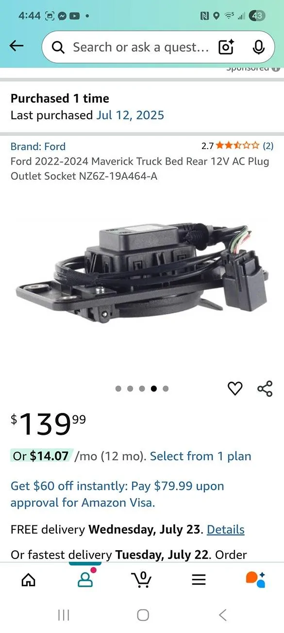

No. It's only an outdoor 110V socket.
Amazon's description says 12V AC Outlet. That's not right.

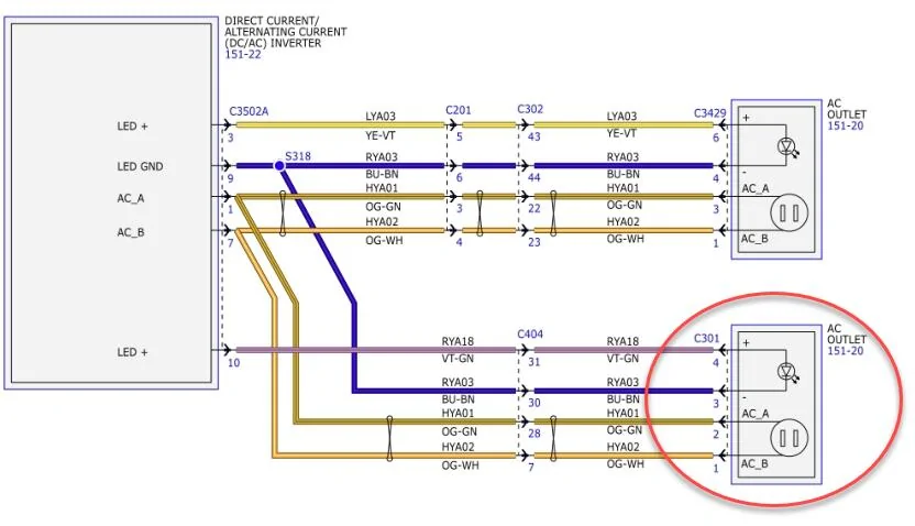

Ford's parts descriptions can give the wrong impression also w/o looking at the wiring diagrams.

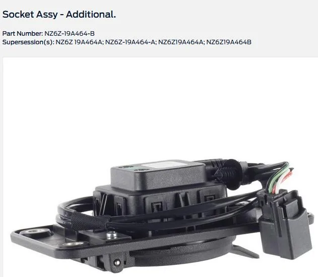

Power Inverter #1. = It's used with the 400W Inverter.
Part #: NZ6Z19A464B
This is the outlet that pairs with the interior socket on the 2023 XLT w Lux package or Lariat where you have the DC/AC 400W inverter under the floor console that feeds both the inside console 110VAC outlet and the outside 110VAC bed outlet.
Same idea as the post above where a Ram 1500 400w inverter is used to feed 110VAC to a Nissan Titan bed outlet.
110VAC AC Outlet Socket Part #: NZ6Z19A464B

Thanks! I thought that could be the case, I was hoping you could (and did) clarify this for people who thought this was all they needed to add a 120V AC outlet.
