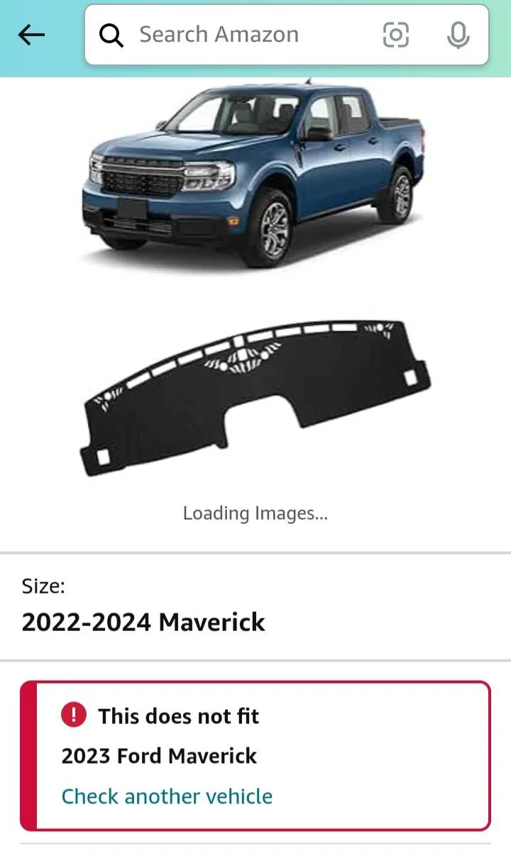

I have found Amazon to be wrong at times such as in the ad below👇

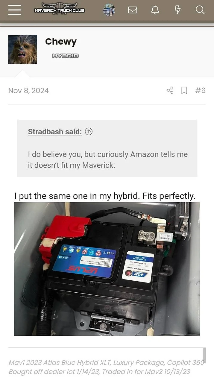

I have been able to replace my OEM battery with the one pictured. I love it, thanks to everyone. But I have not been able to finish the replacement of the bolt and hold down. Does anyone have any instructions to pull the cubby out? I can’t find any links to any.

When I do mine I'll probably go out and buy a magnetic socket.
Try not to snap anything I heard it's easy to do. Good luck.
Have you read the beginning of this thread? I listed tools that should help you.

I ordered the same battery a week ago and it arrived Friday. When I ordered it the seller questioned me about the size and fit. When I provided diminsions and a picture they shipped it the next day. Amazon just doesn't have a hybrid qualifier. I had to pay 130. You can use a 3/8 drive and you don't have to remove any plastic trim.
Amazon does not recognize an AGM replacement battery for the Maverick (2022-24) because it isn't an OEM battery. However, as you discovered, it fits perfectly.
But the OEM battery was an AGM battery. Amazon just doesn't distinguish between hybrid and ICE for battery selection.
Just for later readers of this thread.
No - the OEM battery on the 22-24's hybrids (which this whole thread is about) was NOT an AGM battery.
The OEM battery on the 25 hybrids is AGM.
The OEM battery on majority of 22-24 EB's was AGM, and a recall to replace the ones that got FLA happened.
The points about Amazon is the fact it won't think the listed AGM battery which is the correct size to replace the OEM one, is correct. Because OEM was not AGM.
