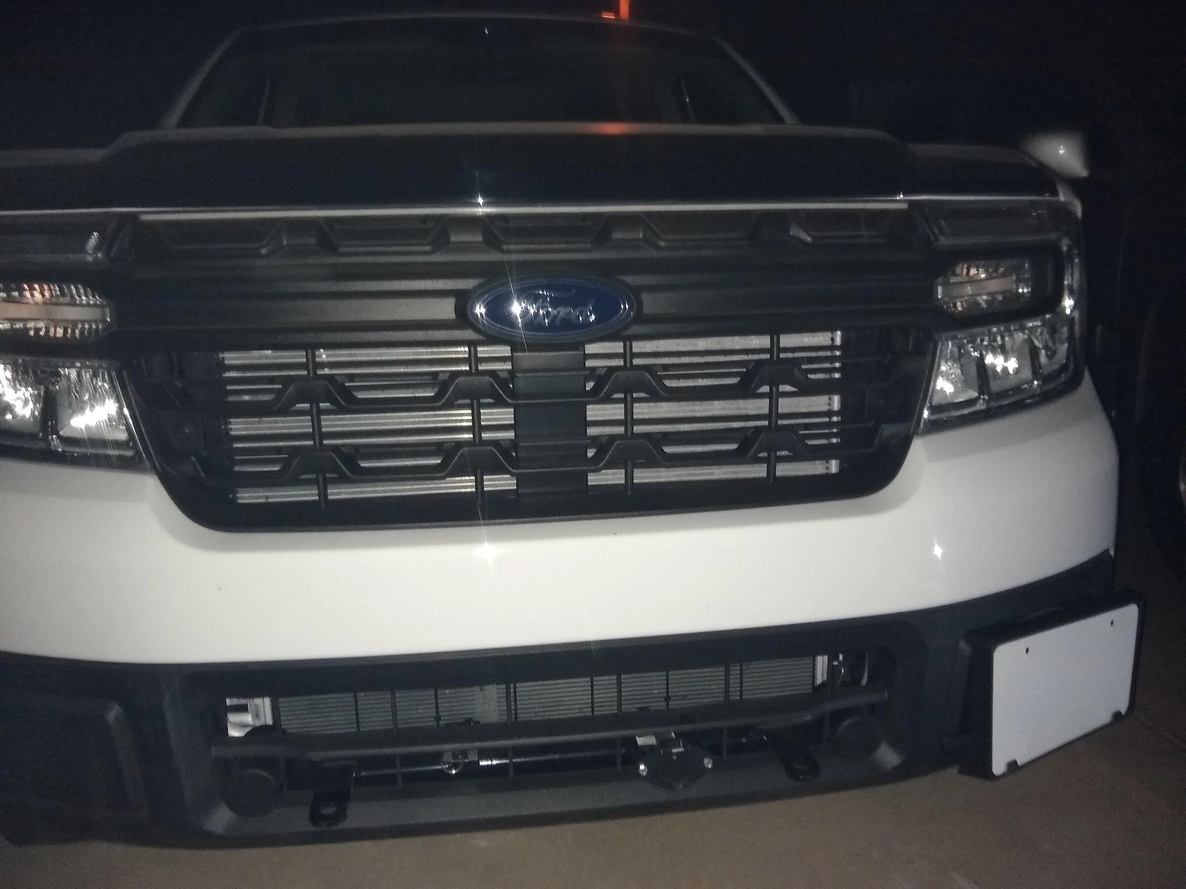

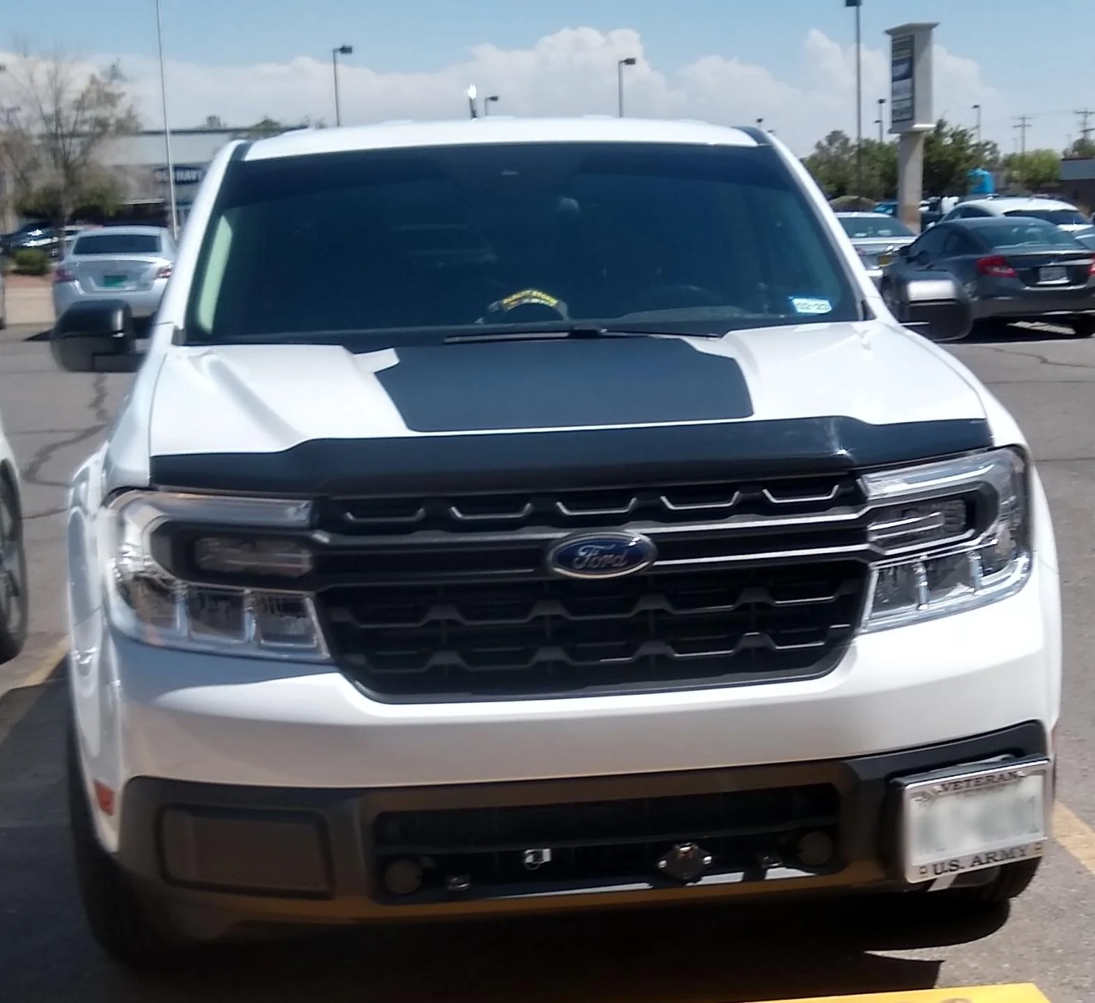

Anyone happen to know - if you opt to mount your front plate off to the side like some pictured, is it beneficial to have it on the passenger or driver side? and why? The rear plate is to the passenger side, so I'm leaning toward the passenger side with the front as well, but I'm not sure if theres a side that would lessen the hassle of getting pulled over for something so stupid. Cops in my area have nothing better to do sometimes 🤷‍♂️
FYI, The plate above using the universal plug can be installed on either side. It has the same hole on both sides. Good luck.

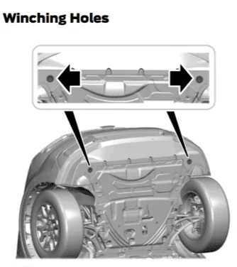

Just wondering if I could easily fabricate a simple arm bracket using one of the winching holes on my hybrid. I'm in Texas which requires a front plate but I didn't let the dealer install it and have been driving around like an "outlaw". Don't really want a grill-attached front plate, and I don't want to drill holes in the front bumper.

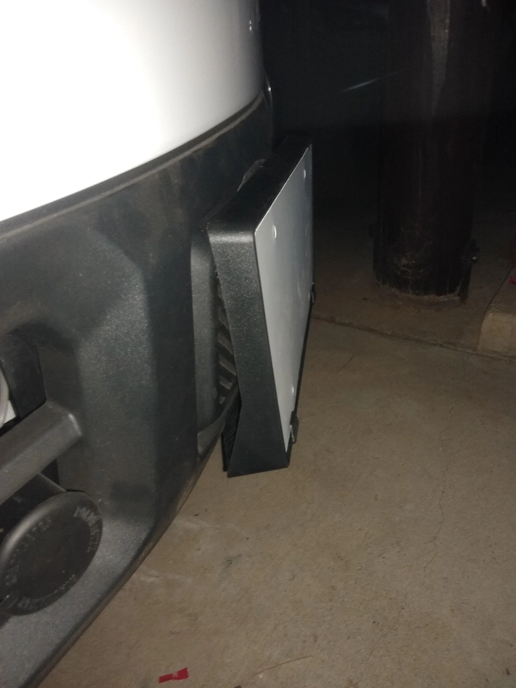

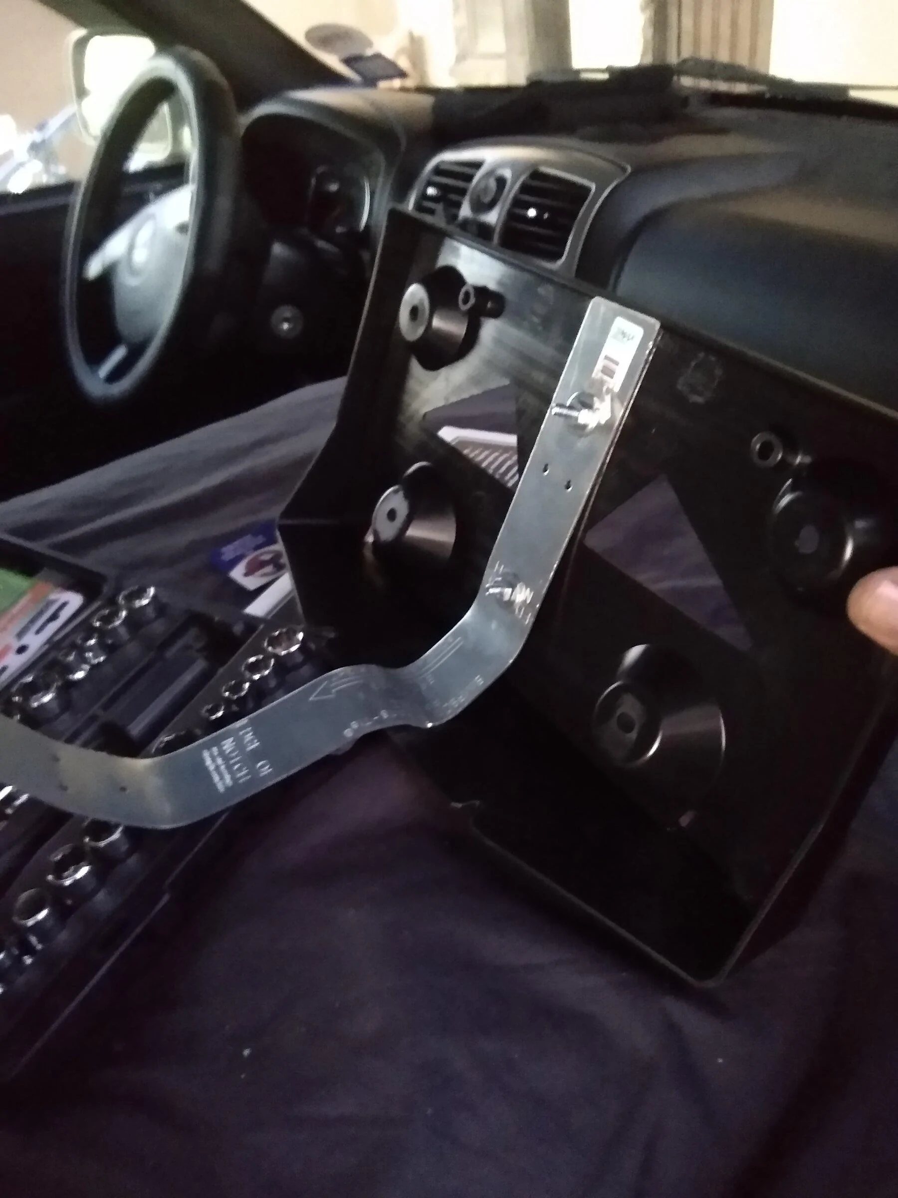

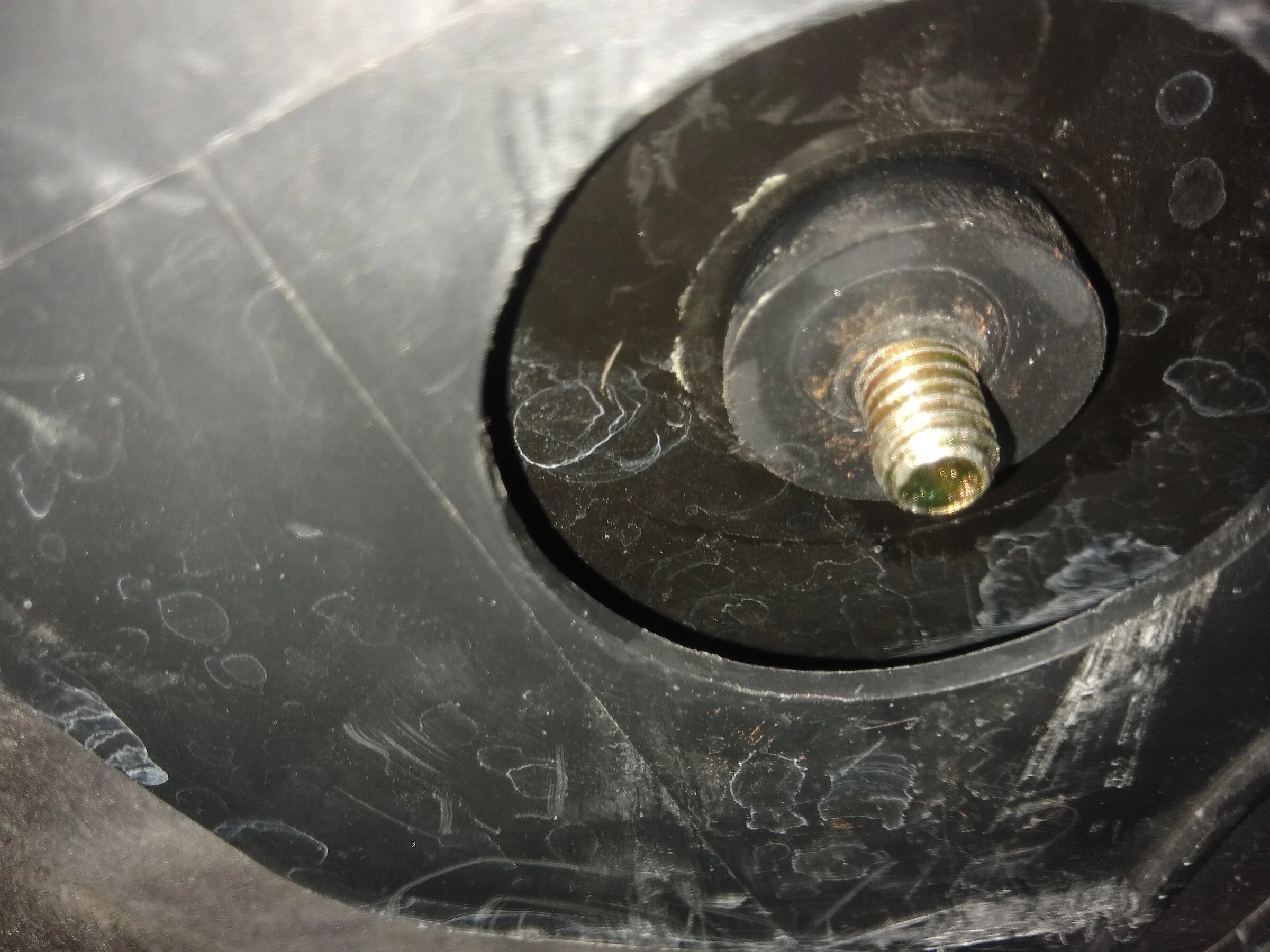

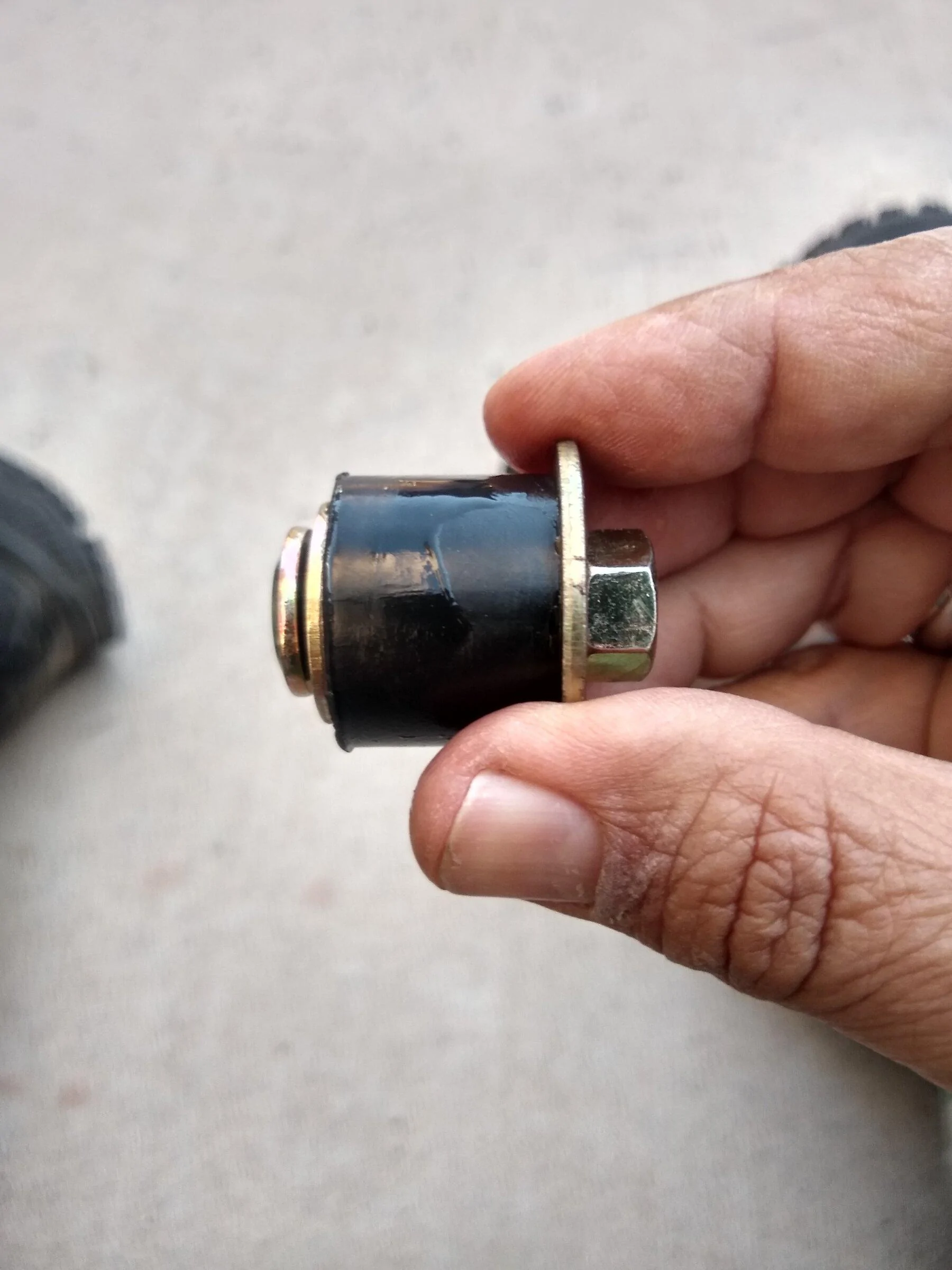

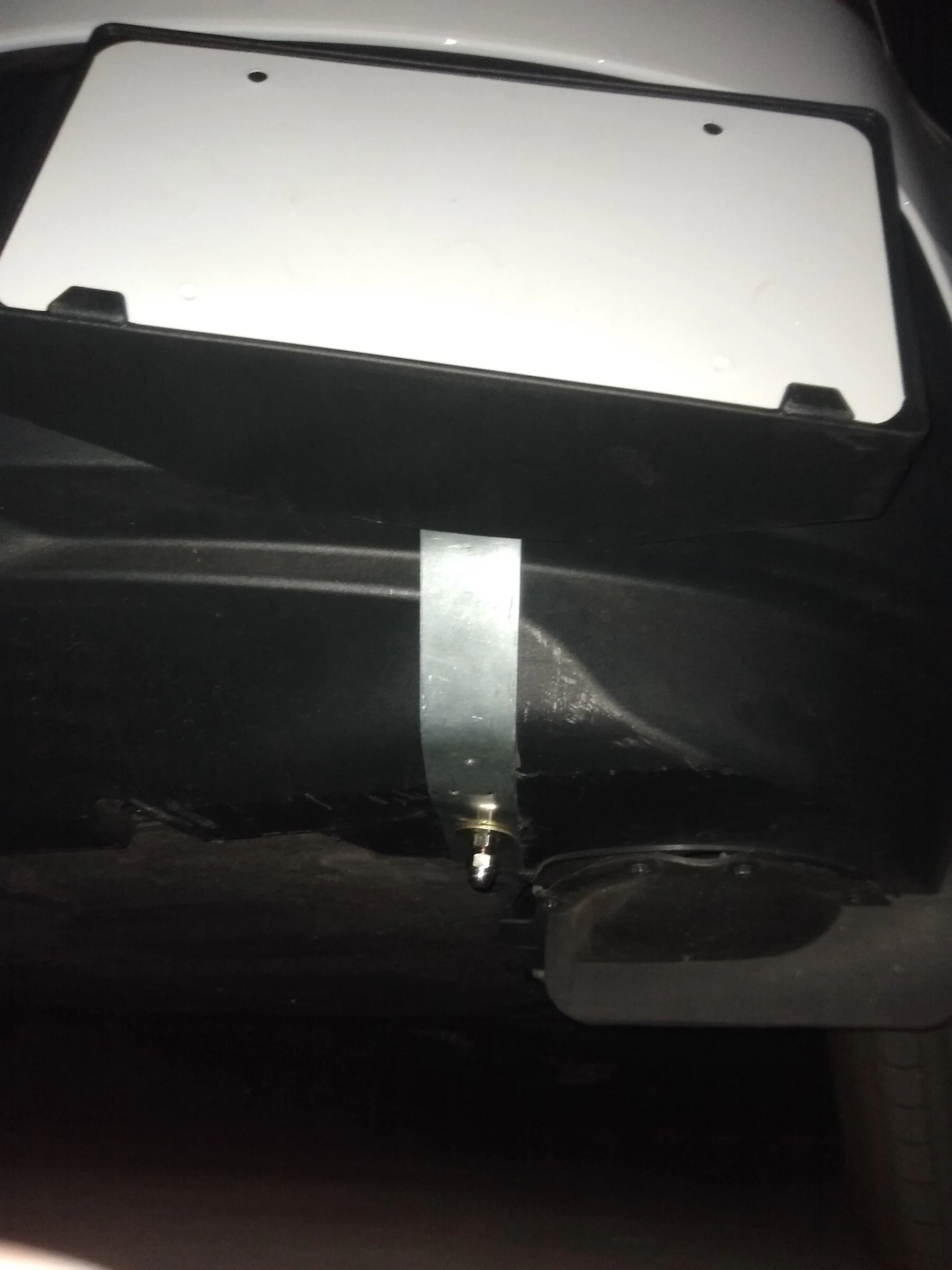

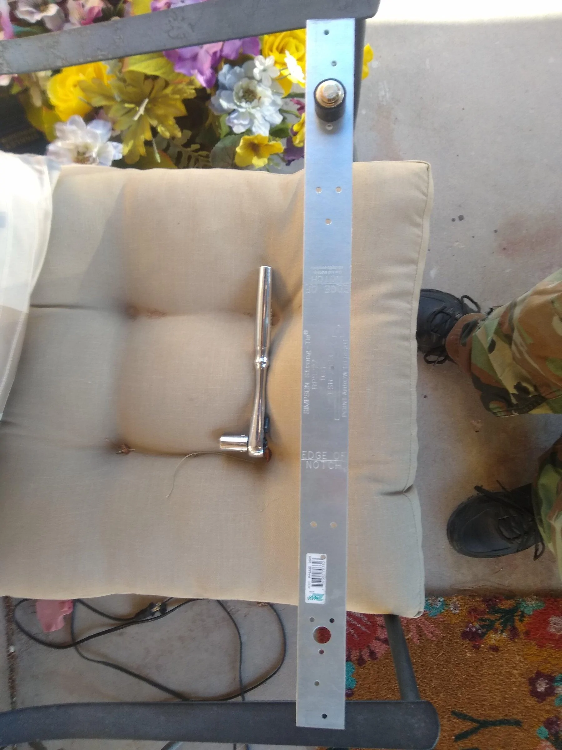

I just completed mine following your first post and using a piece of metal from Lowes and a 1" universal plug from AutoZone, along with the factory plate bracket. Still have to test it out. Thanks for the idea.
Added some 3M take so it won't flap with strong winds. Went for a 45 min drive at 75 mph, accidentally entered a brush car wash, it was too late for me to back out. The pate/bracket stayed perfectly in place. I would say that was a good test! :) See last pic.
Where did you bolt it to?

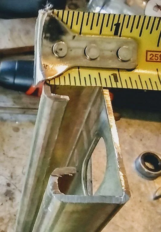

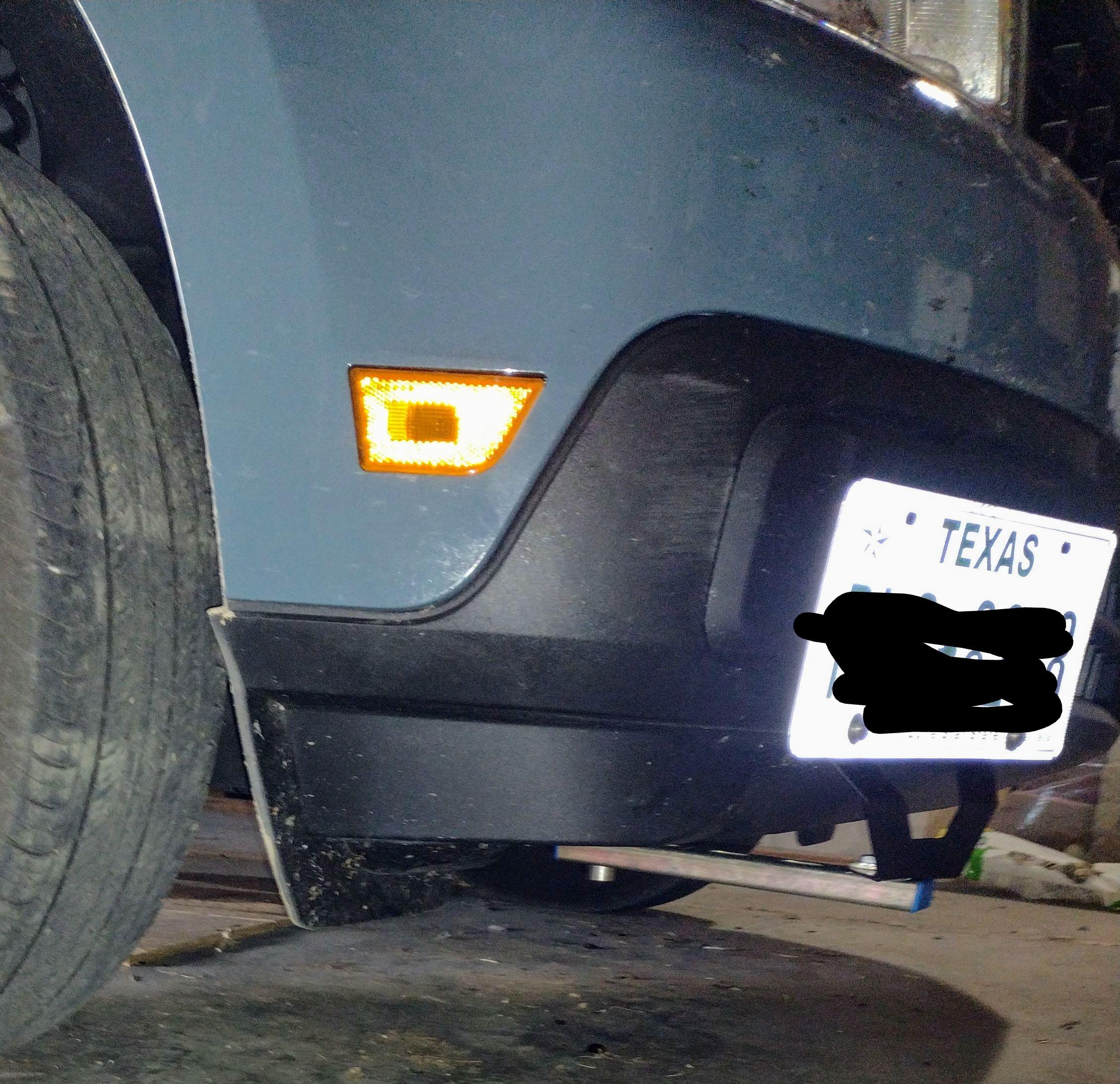

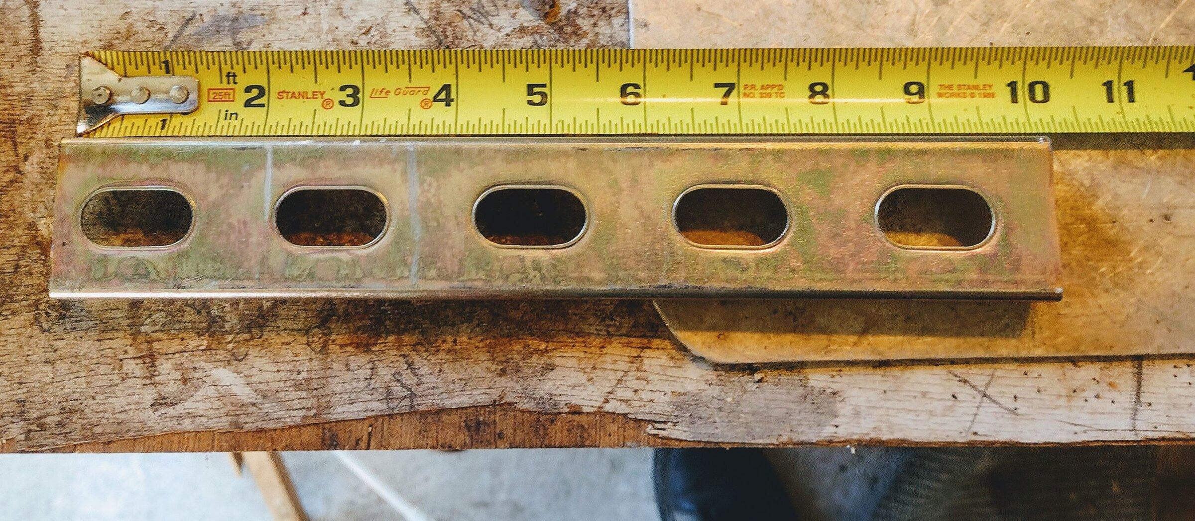

Yes, I did make a bracket out of the leftover rail I had after installing the DIY tie down rails in the bad, and a cheap license plate bracket. Right into the winching hole on the passenger side. It does *NOT* stick down as low as the little front air dam in front of the wheel, so, seems acceptable to me. The bracket I bought on Amazon has the nuts on the side that I wanted to mount to, so I just use some fender washers and spread the load on the back of the license plate so I could mount the bracket backwards (ie; on the nut side)
Could you give us an update and let us know if your front license plate bracket has stood the test of time? Need to get one installed and I’d like to go this route if it has worked well for you..
