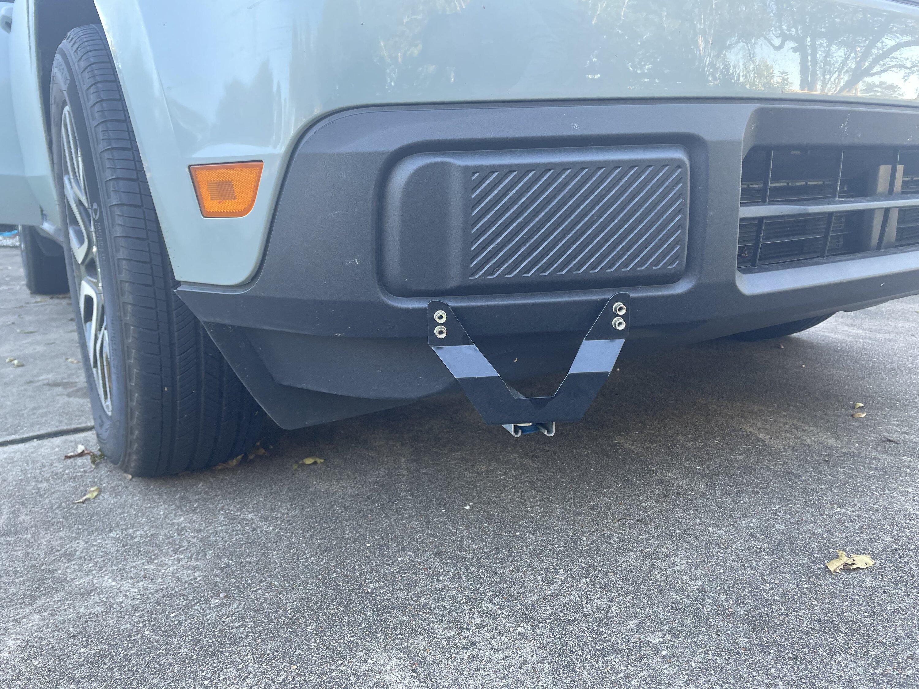

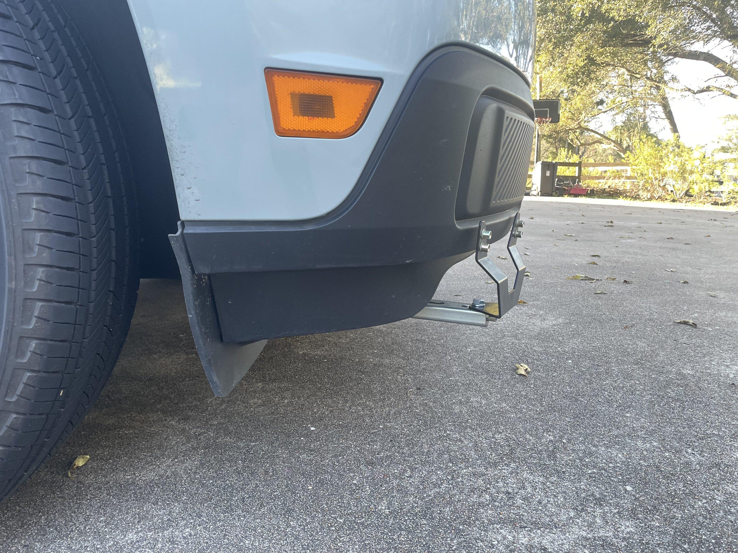

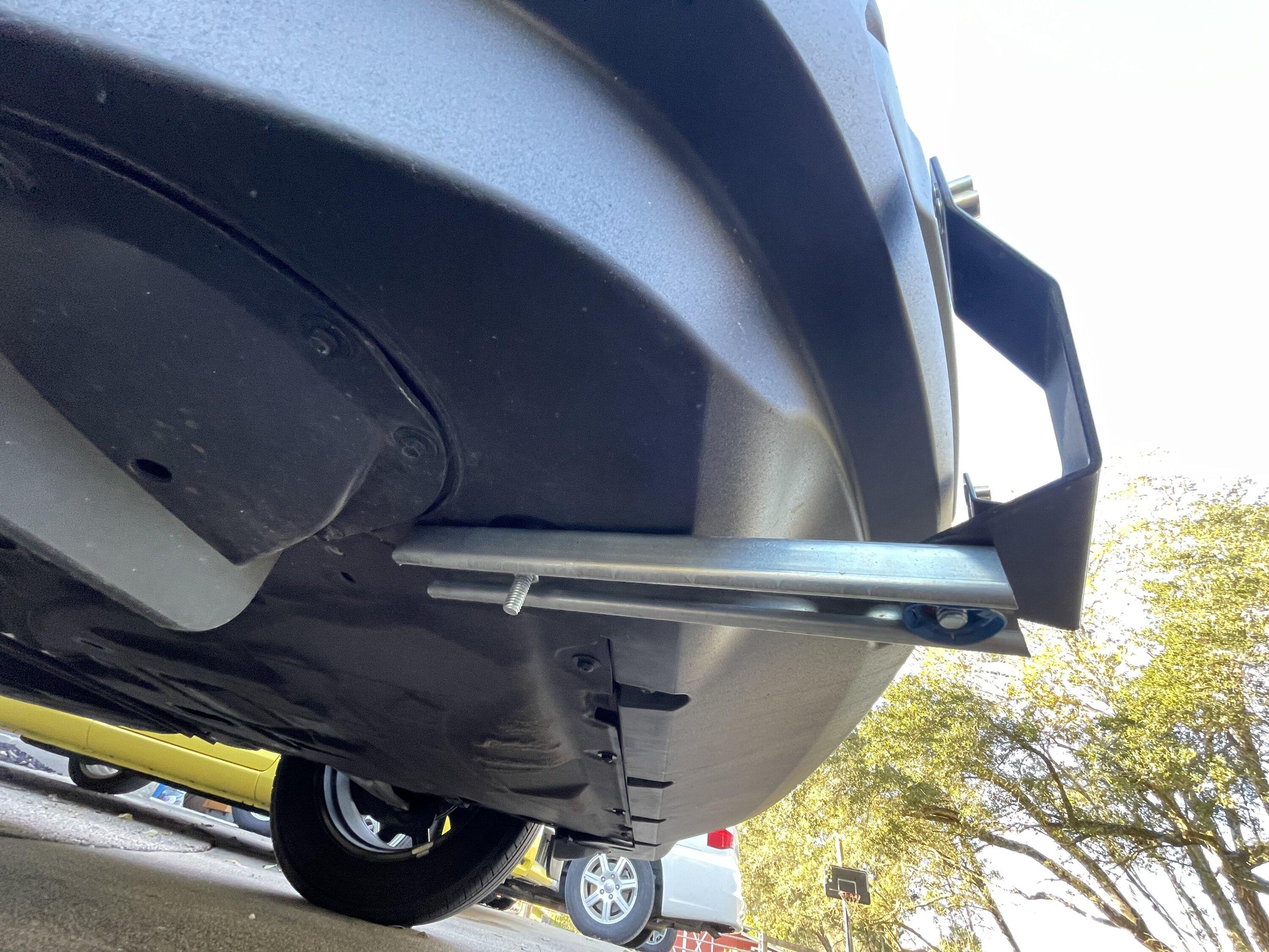

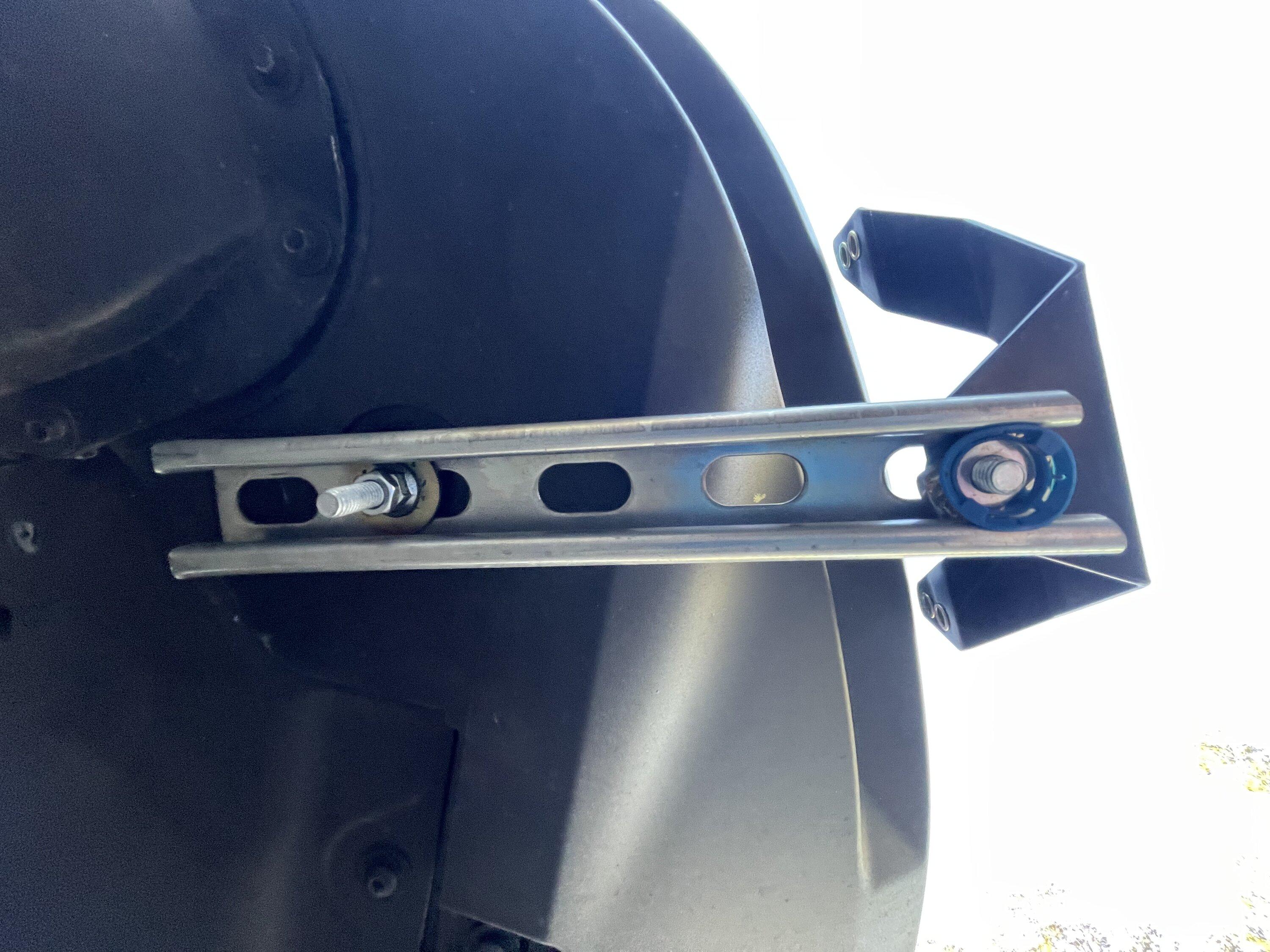

Pretty much exactly duplicated the most-excellent @Dman no-drill front license plate bracket set-up. It is sturdy and has not moved a milimeter in over 2 weeks. Still waiting for the actual license plates to show up and get a final verdict, but I expect it will be solid with the plate installed as well. Will update with some final pictures once they arrive.

Sorry but that just looks super janky with the kindorf strap.....I know you're looking for a certain amount of rigidity but there has to be a better option than the silver kindorf?

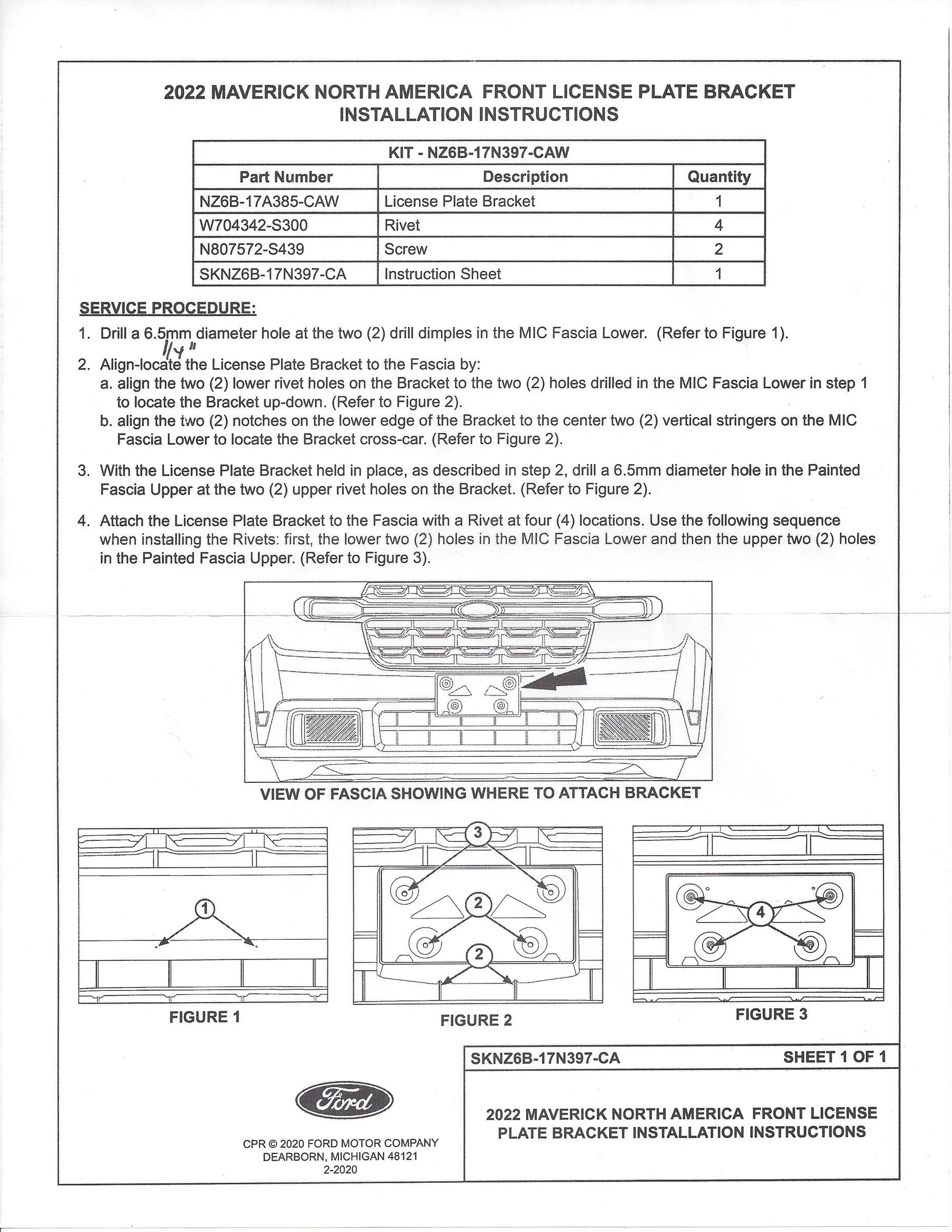

I installed the front license bracket supplied from Ford myself by drilling only the two bottom holes in the black top portion on the lower grill area and am using small velcro squares to hold the top portion of the bracket.
So if Texas ever stops requiring a front license plate I can easily remove it and just plug the two holes in the black top portion lower grill area with black rubber stoppers which will not really even be noticed.
I have attached a copy of the installation instructions.
In the procedure I did step #1 then put the small velcro squares on the back of the bracket over the top two mounting holes then did step #2. I did not do step #3 and in step #4 only did two screws on the lower two mounting holes.
Ford Part Number is listed in instructions:

I went the velcro route and it worked very well. Thanks for the reccomendation.

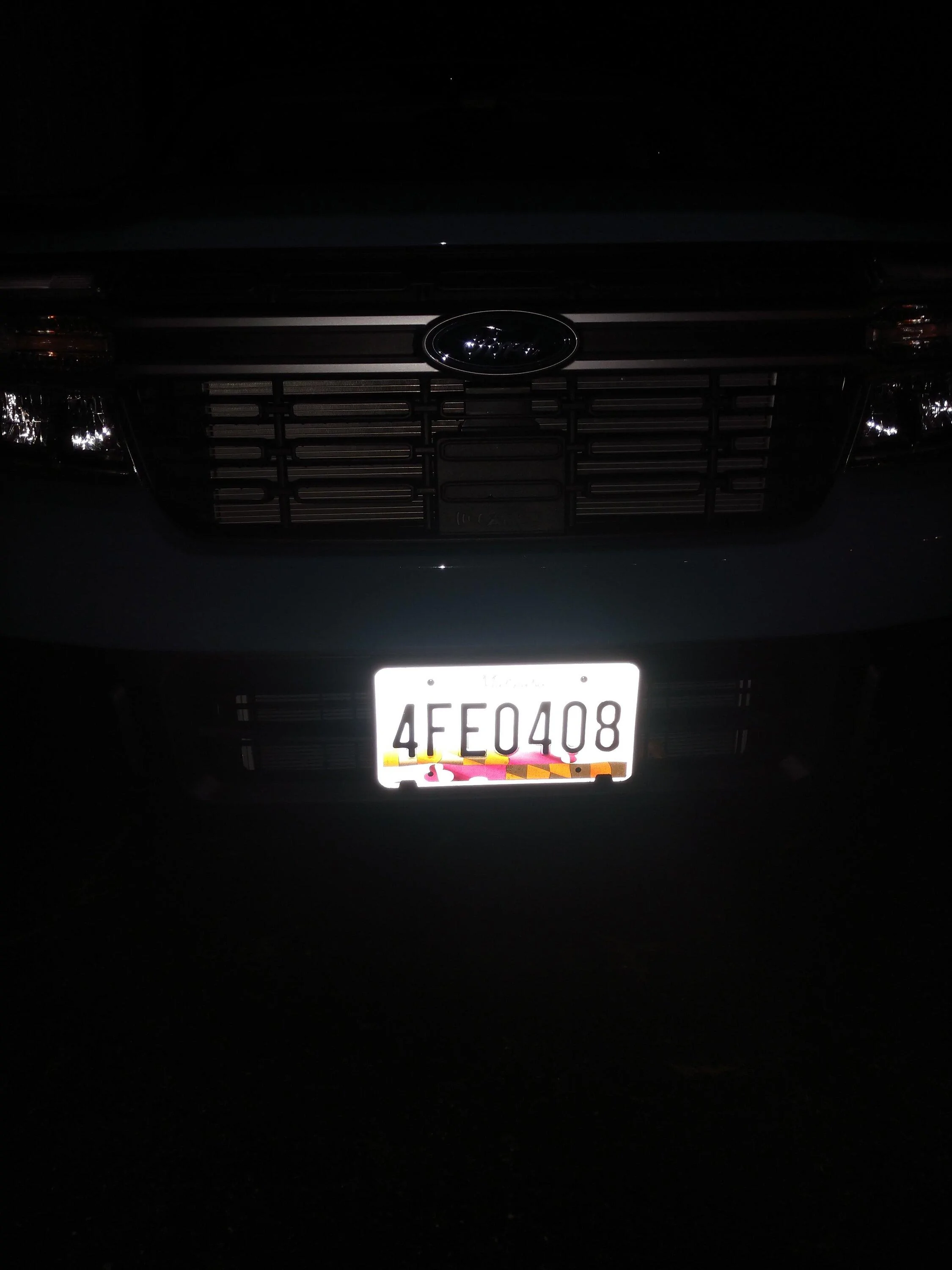

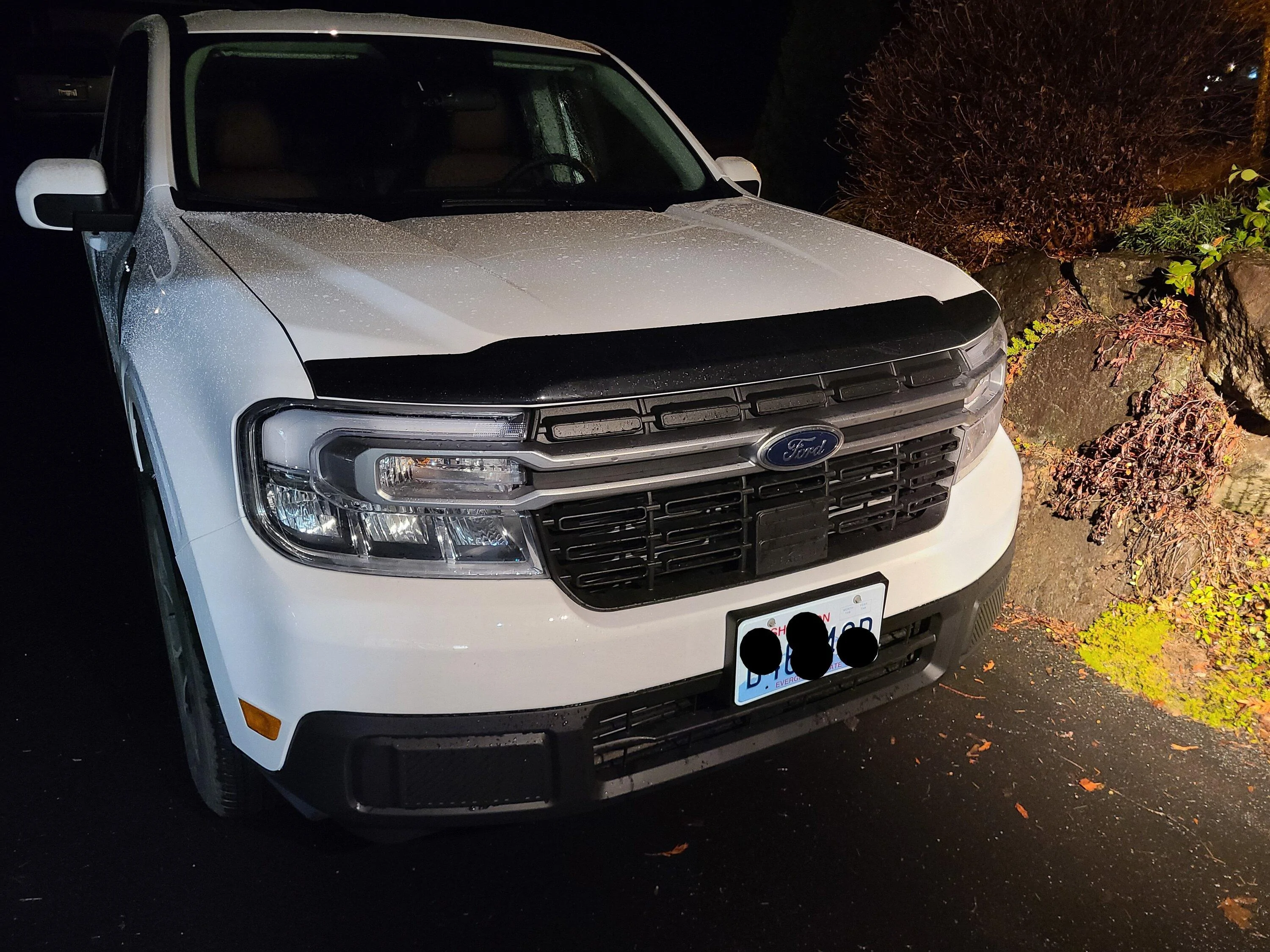

I used three long cable ties around the lower black grill to the license bracket, and it fits perfectly with no drilling and is nice and secure. Very easy.

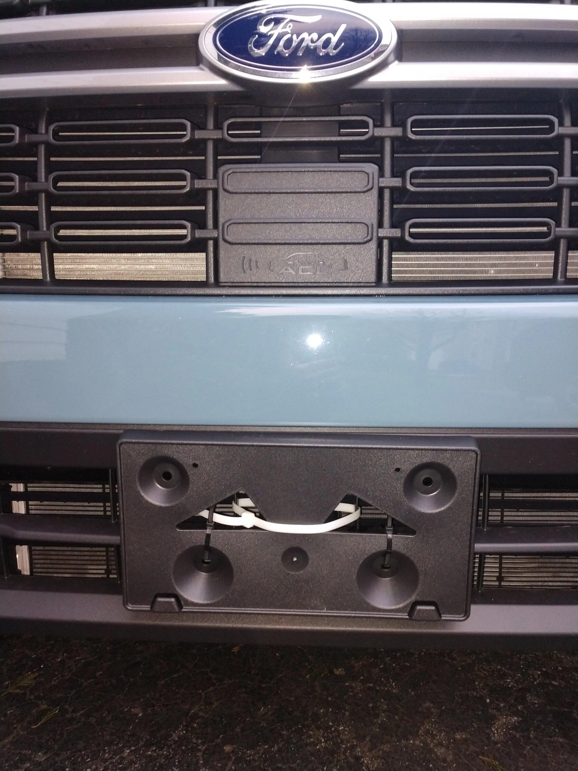

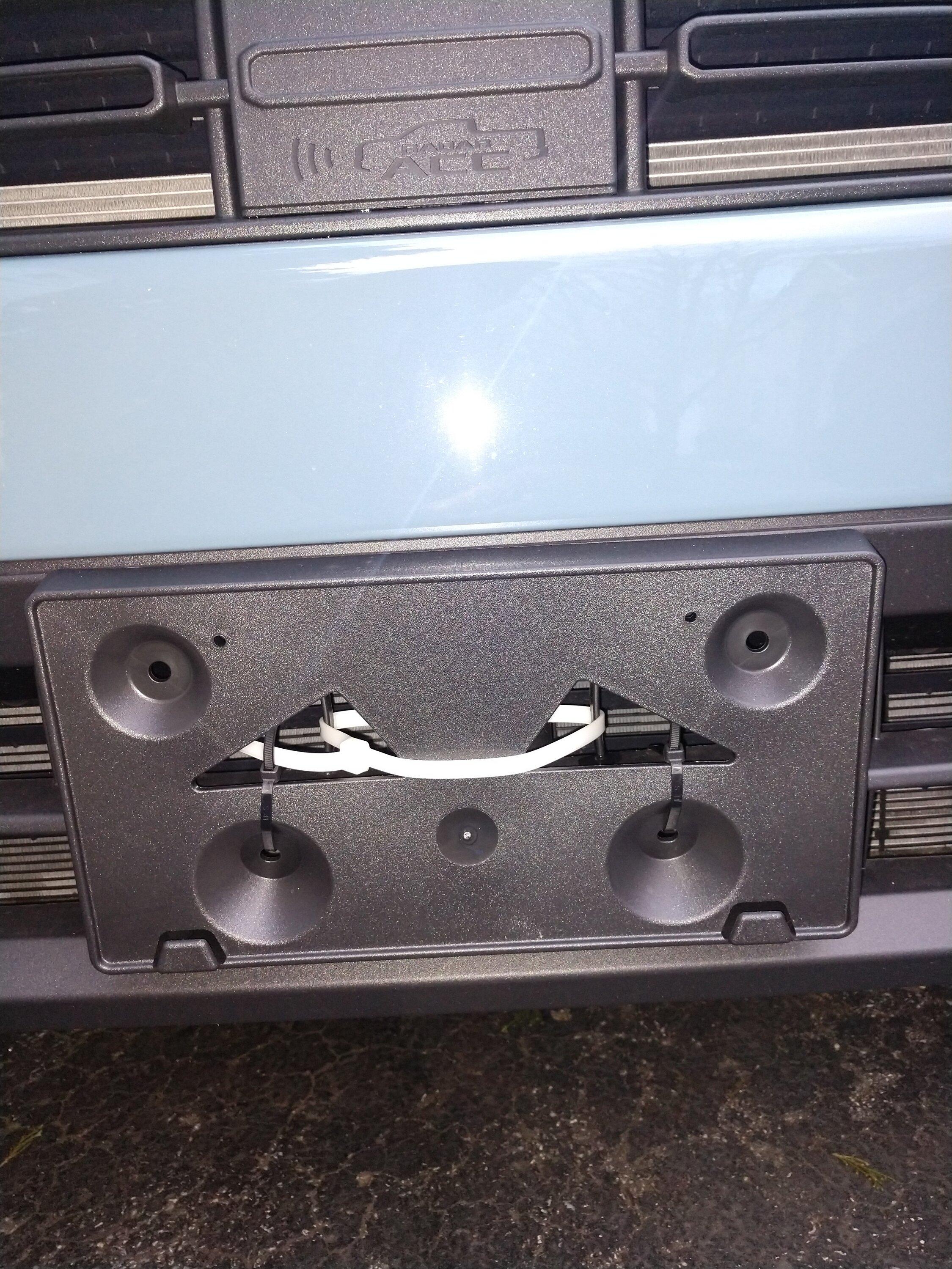

Looks like it blocks some sensors ?Could you take another photo in day time?

I checked for sensors and didn't see any, also checked the manual, which shows two sensors above it so I'm pretty sure it's not blocking anything. If you know otherwise, please let us know.
I took the plate off so you could see the cable ties I used, which hold it fine.
