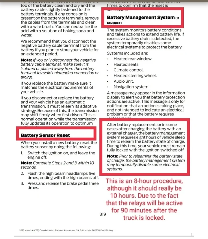

🤔 Fact your battery is close to 4 years old👨🏼‍🦯 ??
If you have access to a battery charger. You may try charging your battery up as much as you can. Then doing the the relearn sequence.👇
Doing this may or may not give you extra time on your current battery.
If you already have a charger it's worth a shot. Keep us updated.

Yeah, I may have to look into this. The phone app has been a little wonky lately and I didn't know where to look first. Thanks.
