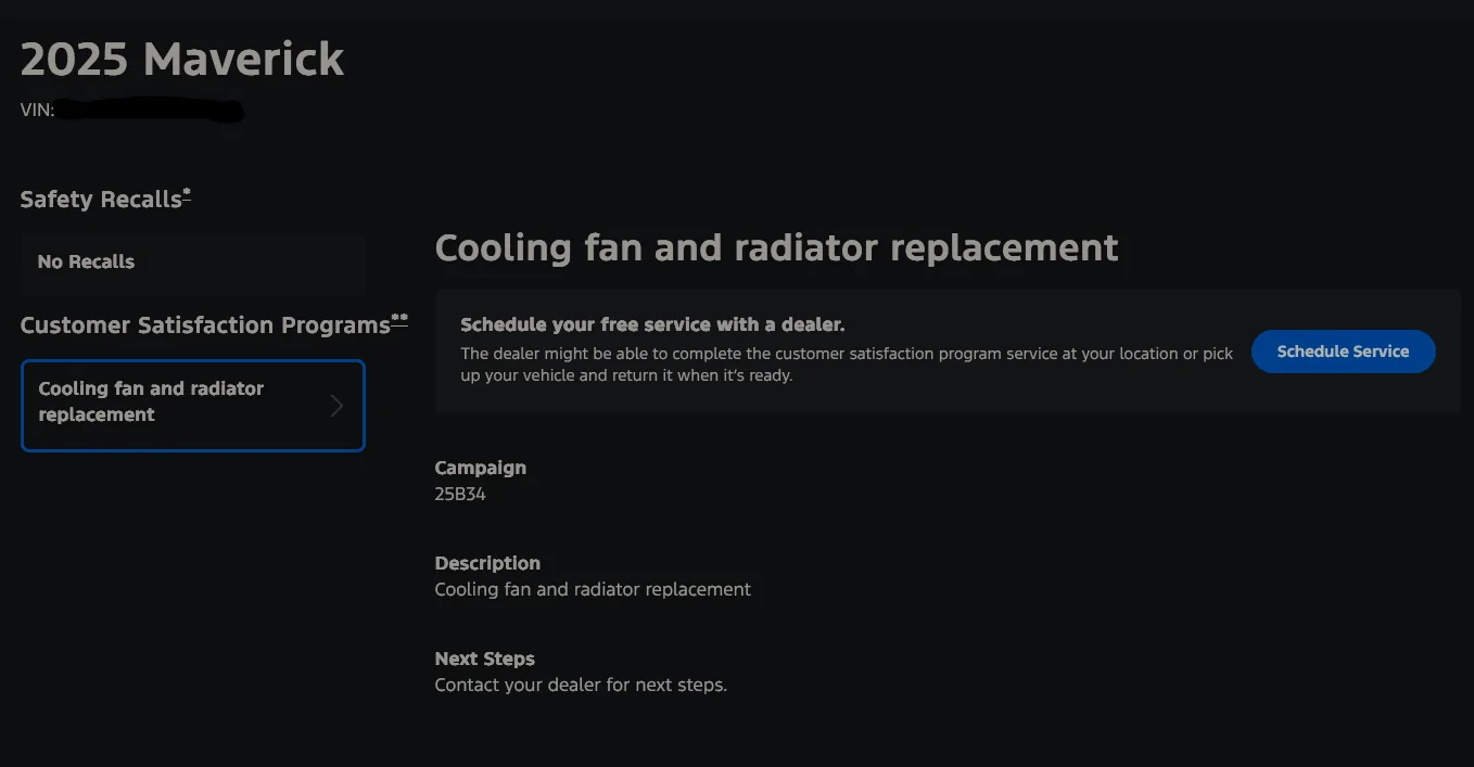

My dealer called it a “customer satisfaction recall”….Thank you sir may I have another!
But then we all agree that dealers are dumb, so there's that....

Ford should know how to properly build a vehicle by now, its not like this is something new for them...
For a startup or even company with only 5-10 years, sure sorting out processes takes time.
But Ford probably has assembled a car a few times before..
If I paid for one thing and received something else, I don't see this as optional.
I bought a Lobo partially for the reassurance of increased cooling capacity. Even if I won't be racing it, I expect it to include what they said would be included.
Or, give me a $5k rebate to compensate me, and I'll live with it as is.

This only applies to LOBO builds up to March 31. I believe most 402A's were later availability . I wonder if these are mostly 702A builds.
r0tax
Jun 29, 2025
558
807
CO
2025 Lobo 402A VB
Mine was built 2/2025.
