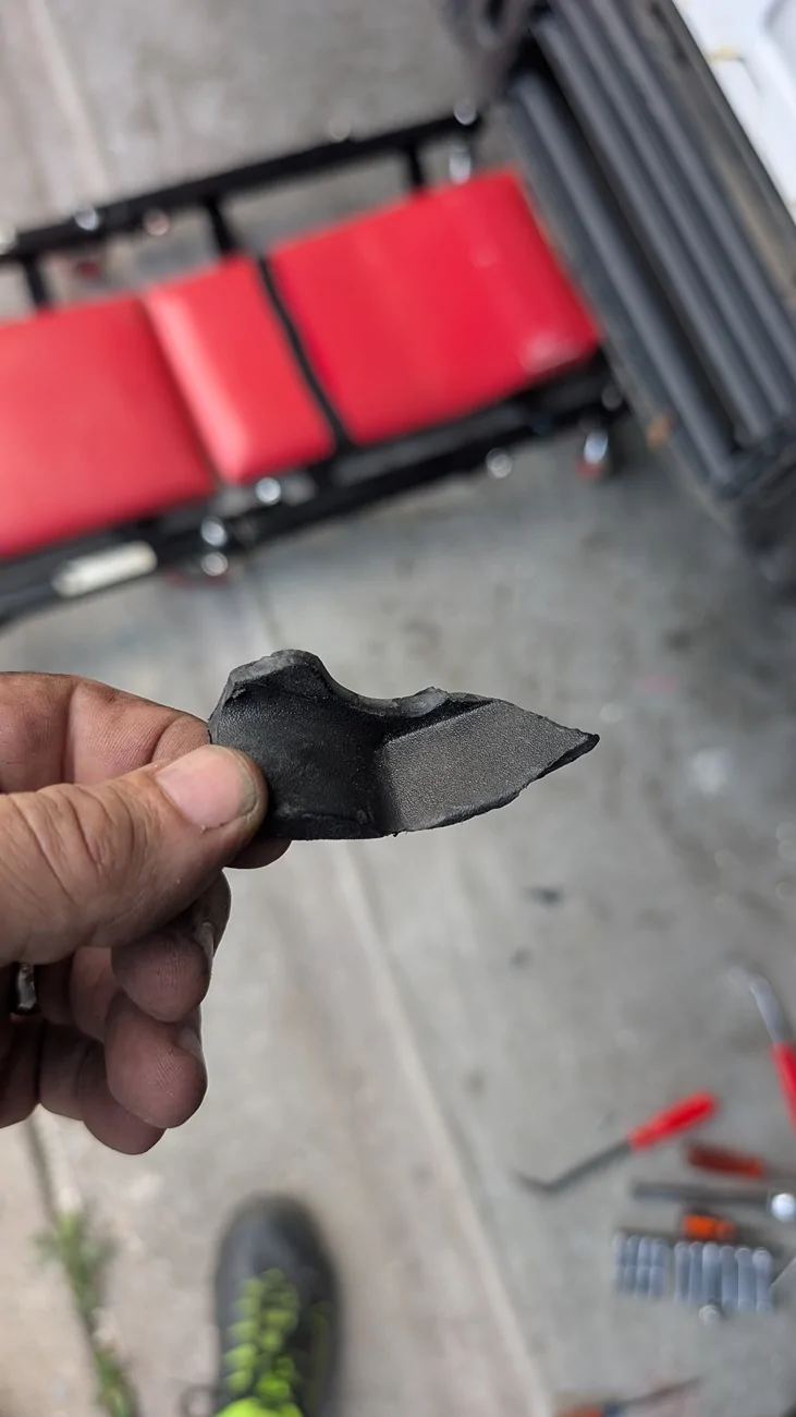

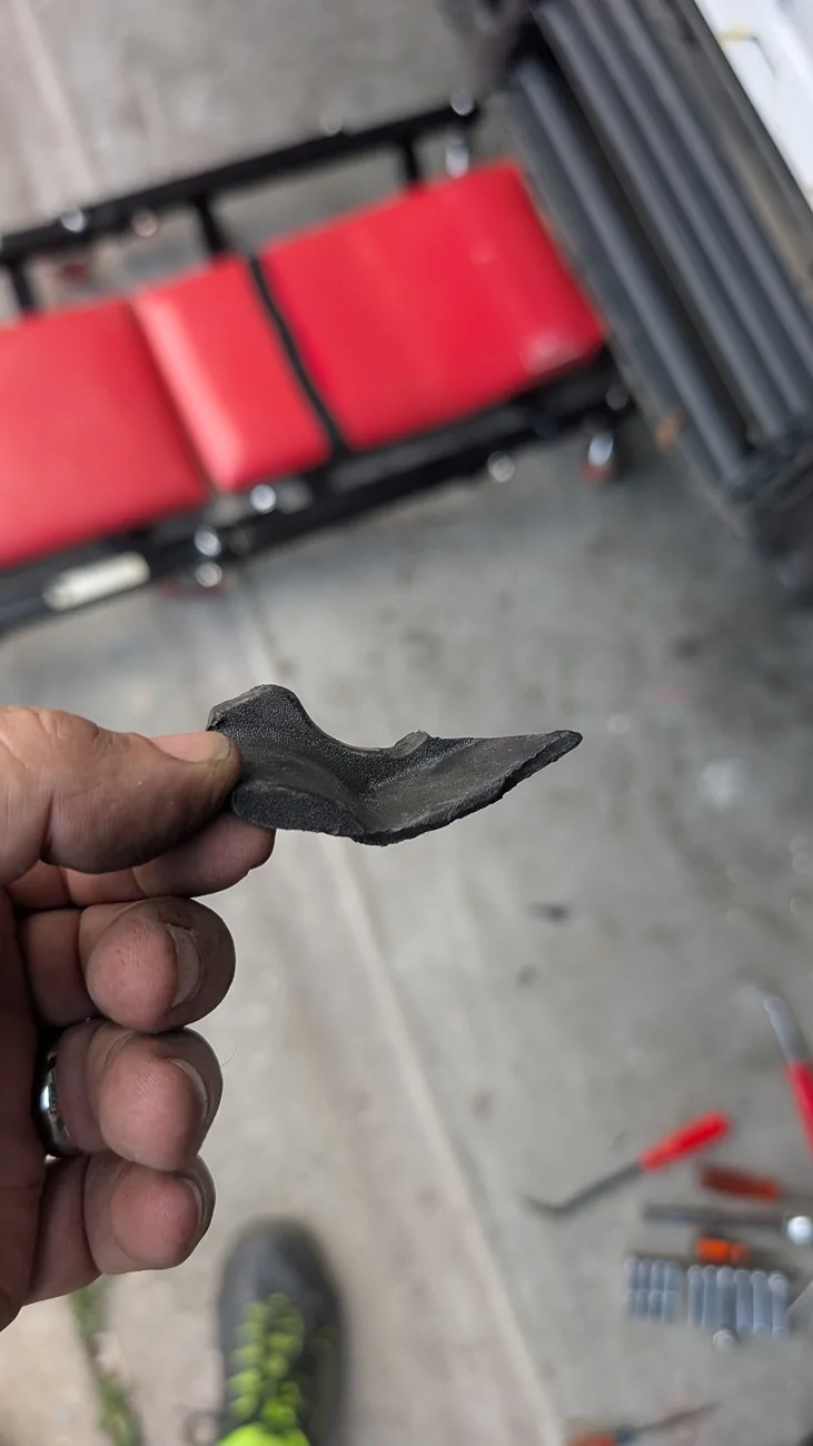

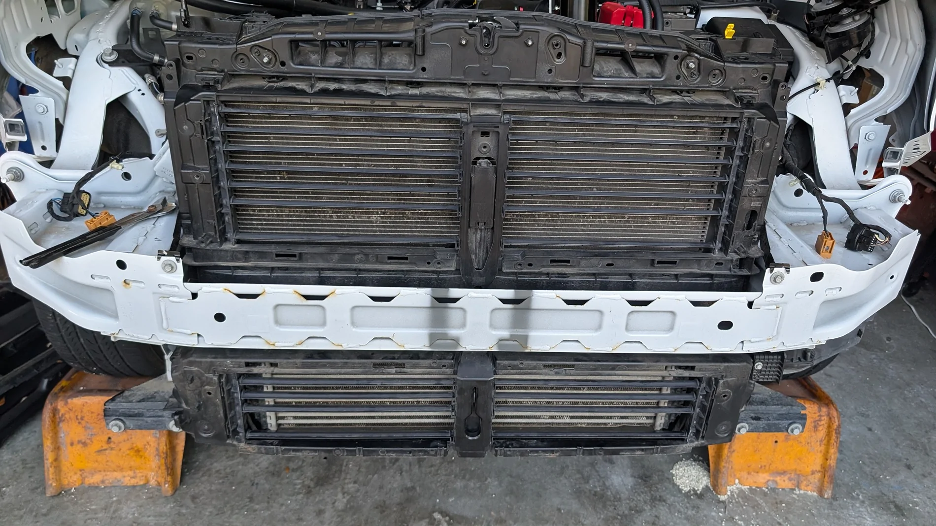

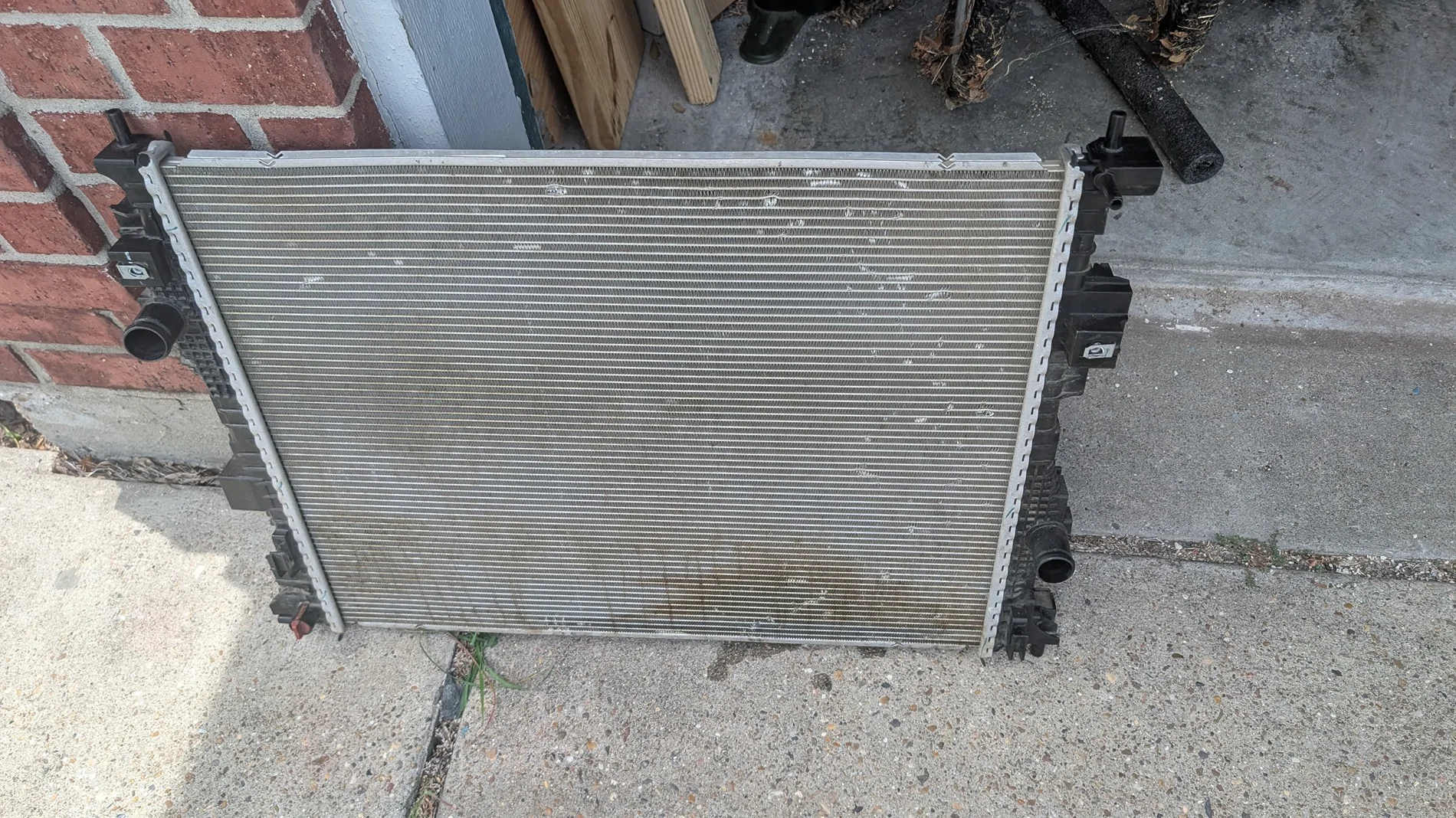

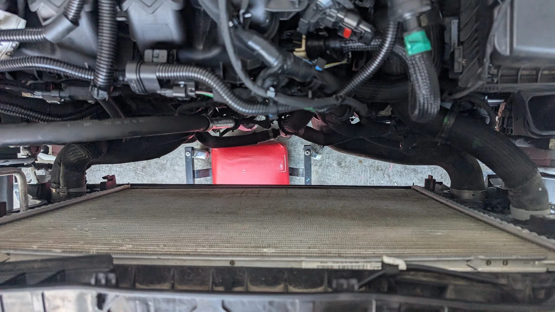

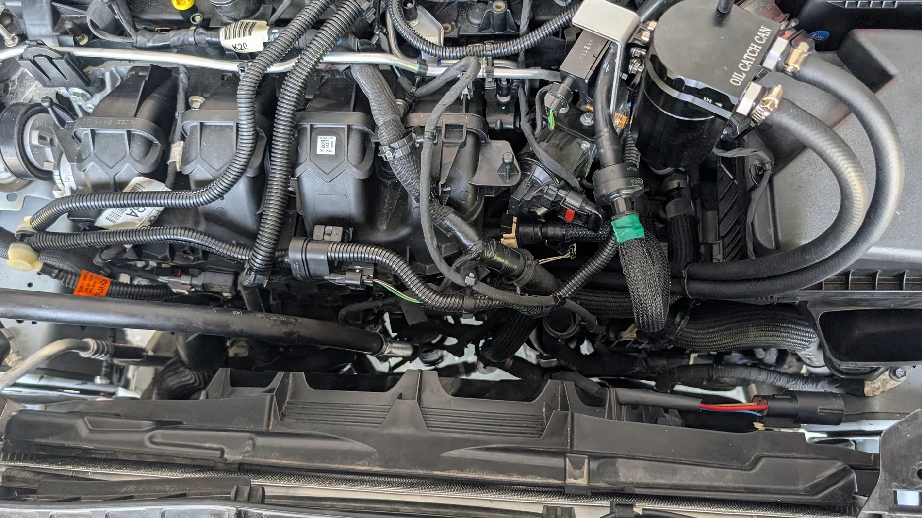

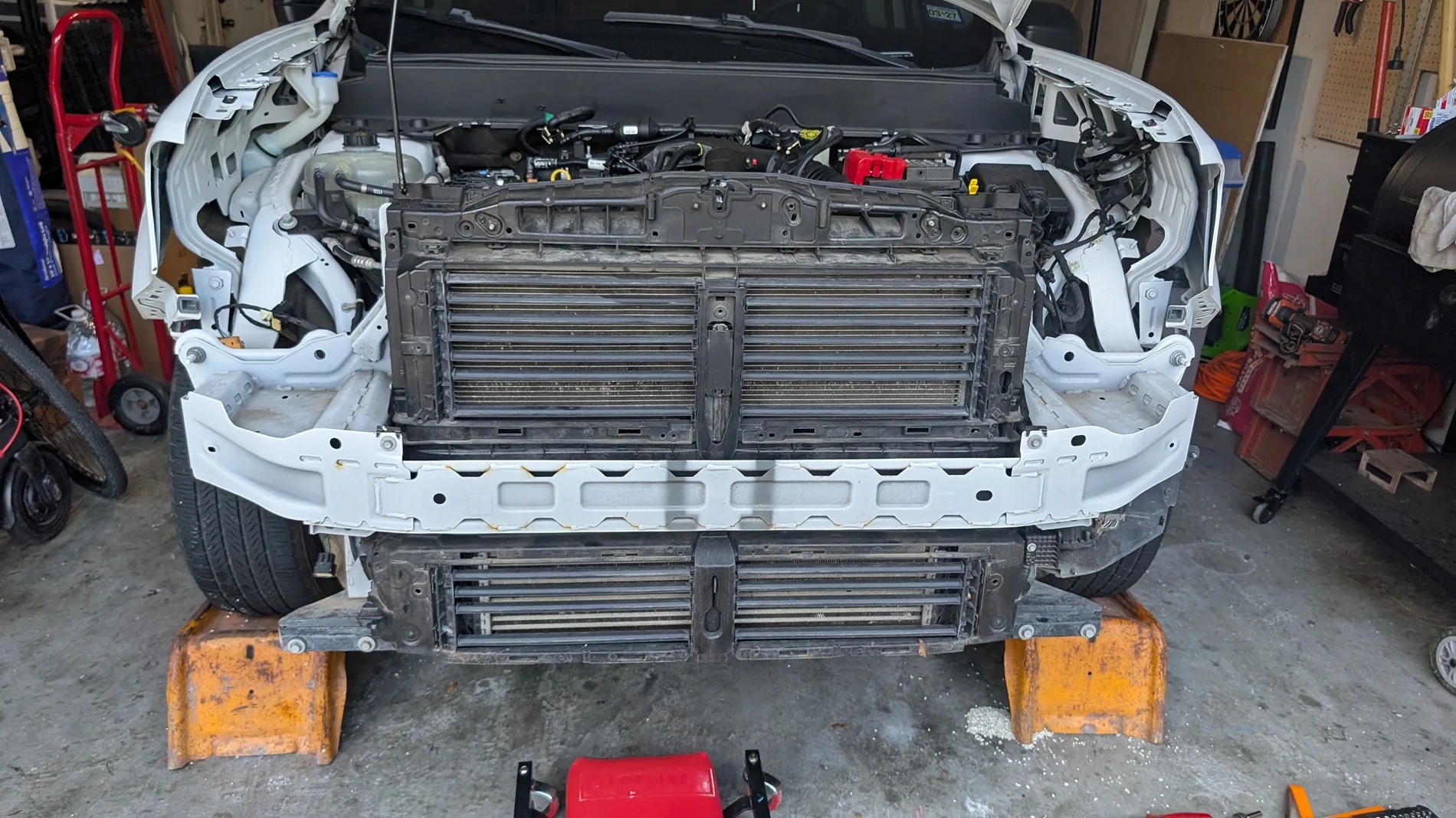

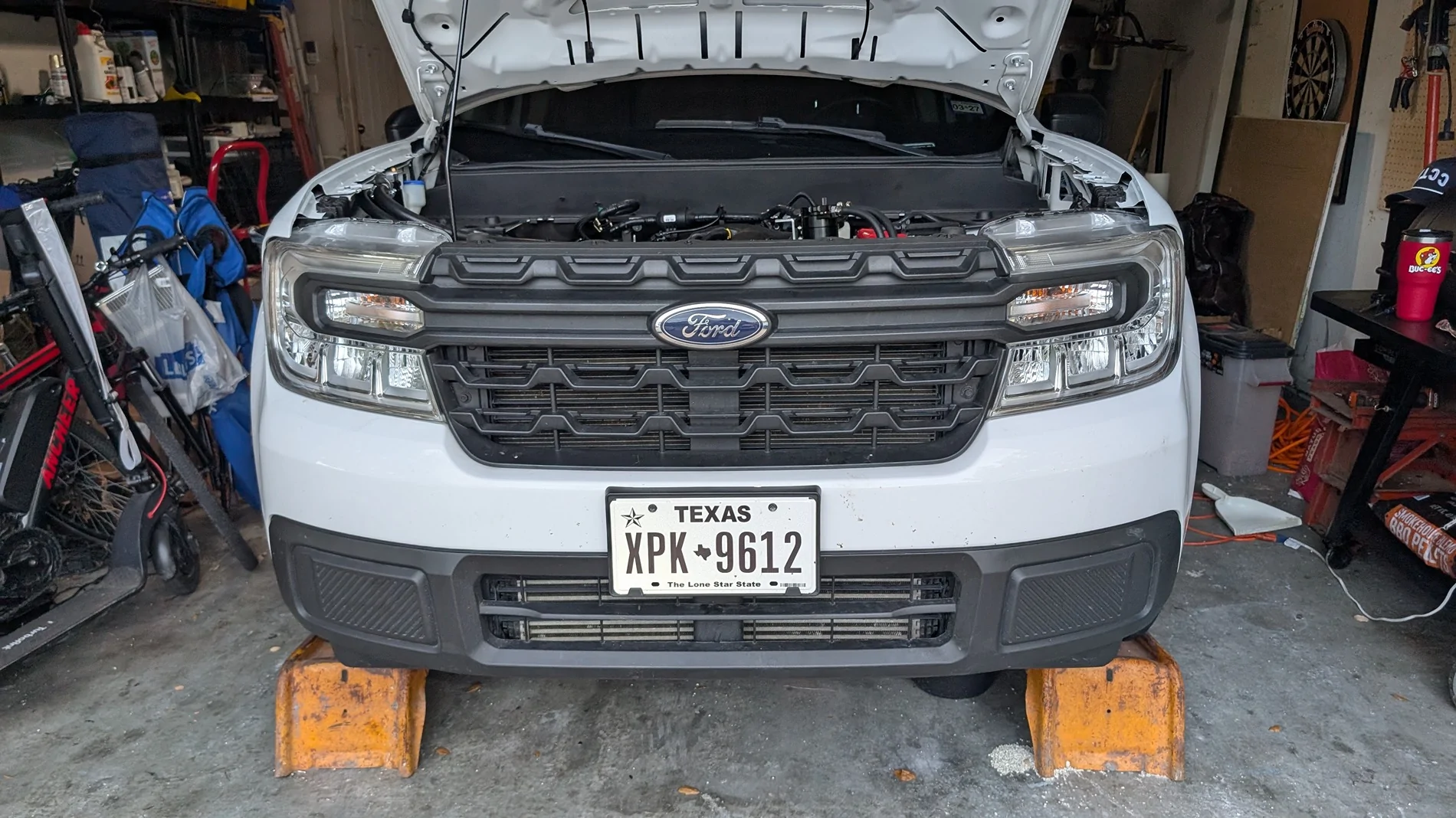

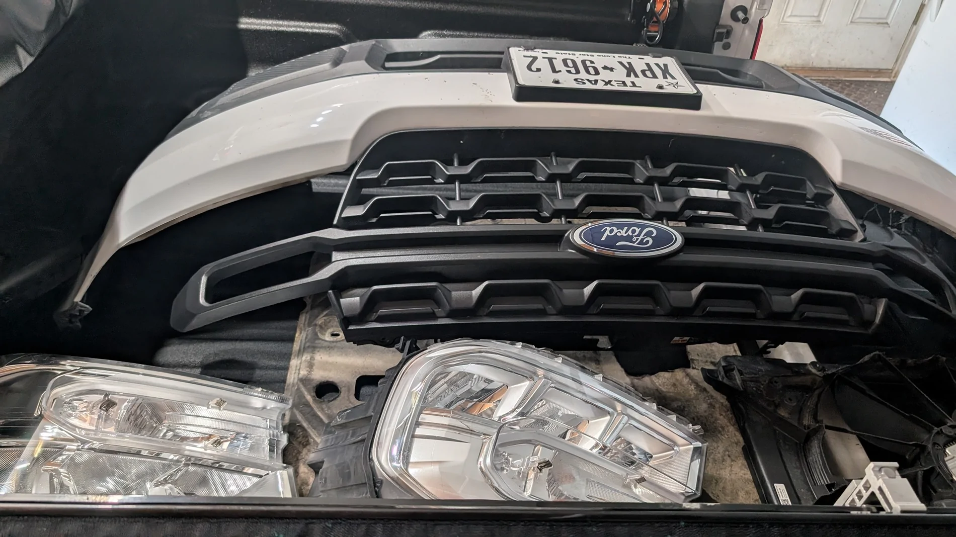

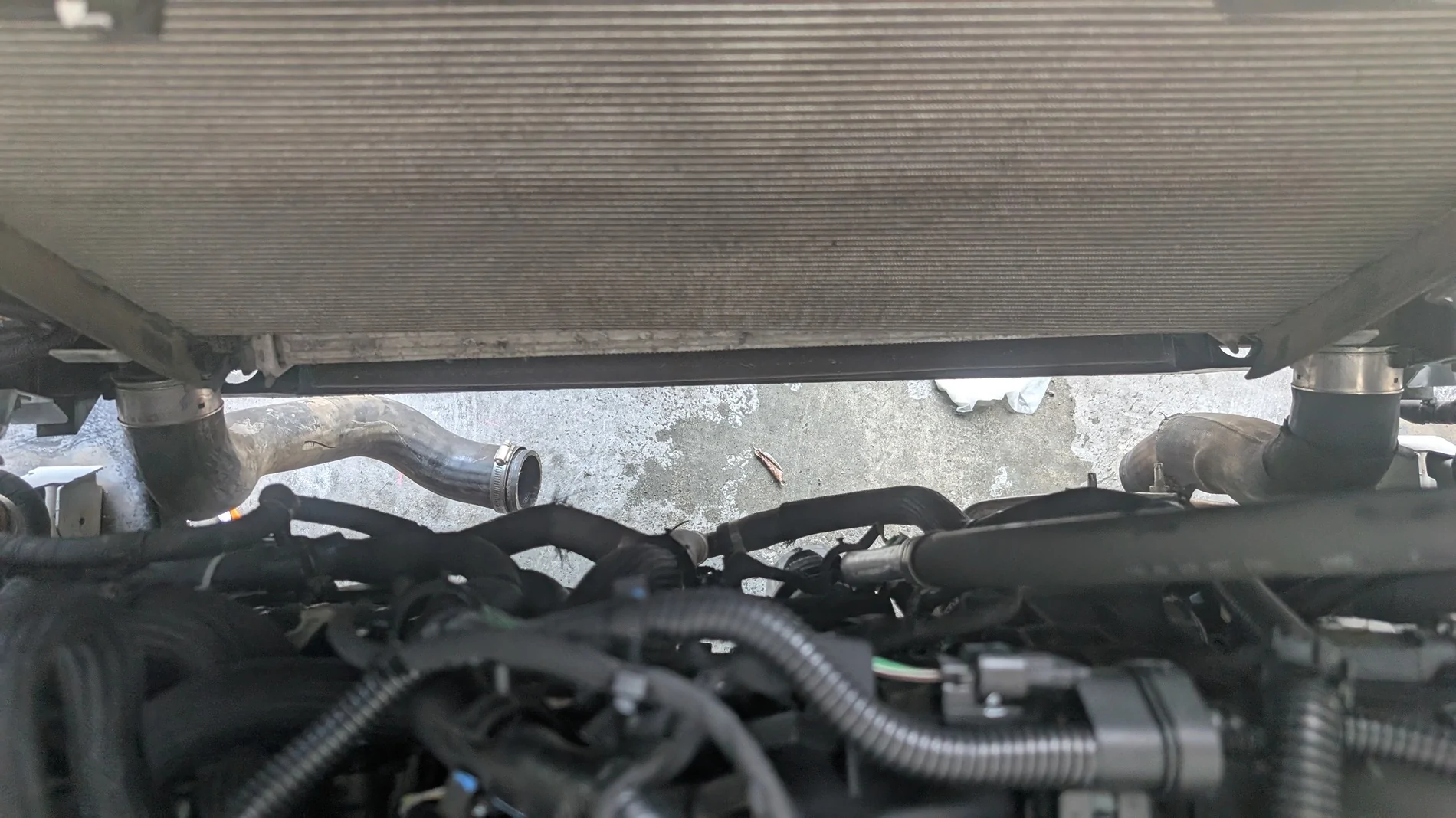

Just finished doing this in a 2022 Ecoboost we
bought used rebuilt title. A piece of plastic was wedged between fan and radiator that caused the leak
Very interesting, thank you for posting. 👍🏻
