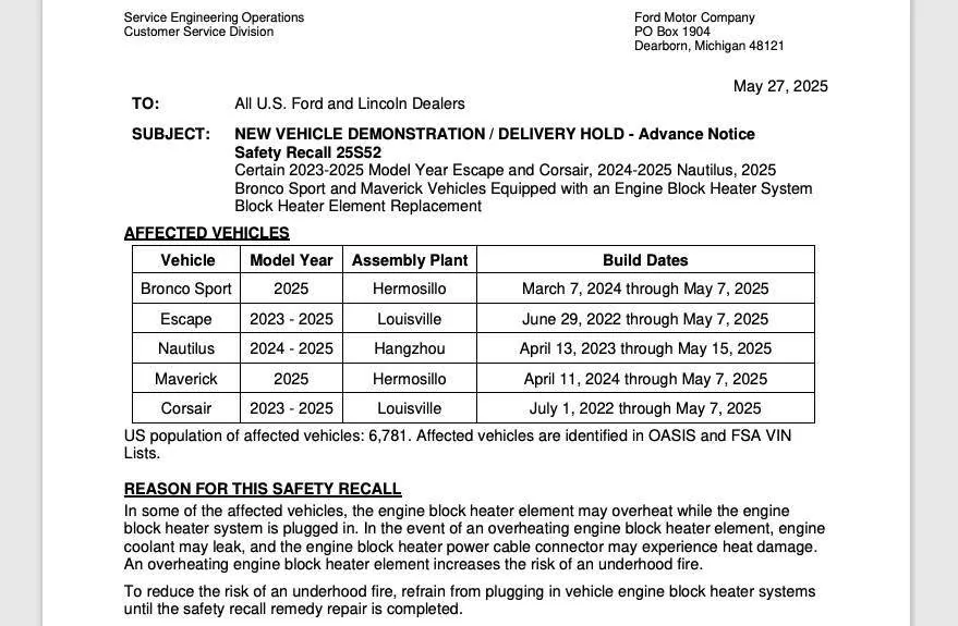

So far it seems the 25MY is NOT mainly software upgrades.
And this was the year of pulling samples off the line for extra quality checks.
I hope I'm exempt as my build date is 5/12/25 dealer told me they need to pull engine to replace,600$ to install at dealer,glad I ordered it as a option!

Mine is a 4/25 build and it does have the recall on it, hoping they don't have to yank the engine!

I highly doubt that they will need to pull the engine, at least with the Ecoboost, to replace it. If you follow the plug wire, the heating element is on the front right of the engine. Looks to be fairly easy to get to.

My Maverick with a 3/3/25 build does not have a recall on the engine block heater.

Last I heard it seemed like there was a supply problem on the engine block heaters where they couldn't get them and it is holding up orders. I don't know if that has been resolved or what the availability will be to get it replaced. It may be a wait on that. I would contact the dealer to get the skinny on it.

Has anyone received an update or heard of an update from Ford on this recall? I just bought a '25 Maverick in September and it had the airbag clip and this block heater element recall on it, the dealer replaced the airbag clip issue and I had assumed did the block heater. Until I pop my hood and find no block heater chord/plug. Searched my VIN and now it says its under a Consumer Satisfaction Program? I called a dealer (not the same I bought at as I'm annoyed they didn't tell me about this) and they told me that Ford will send me a letter when they have this figured out basically. So we're just not going to have block heaters in a Canadian winter??

I took my 2025 in for Oil change and what I thought was a block heater replacement. Turned out my Dealer has been instructed by Ford to REMOVE the block heater until a fix is available. I have read today, nothing coming soon, maybe February 2026!! Not good living in Manitoba Canada for our cold Winters!!

Due to the block heater issue, we can't use our block heaters. This is not the end of the world though they are nice to be able to use.
Your truck should be fine.
