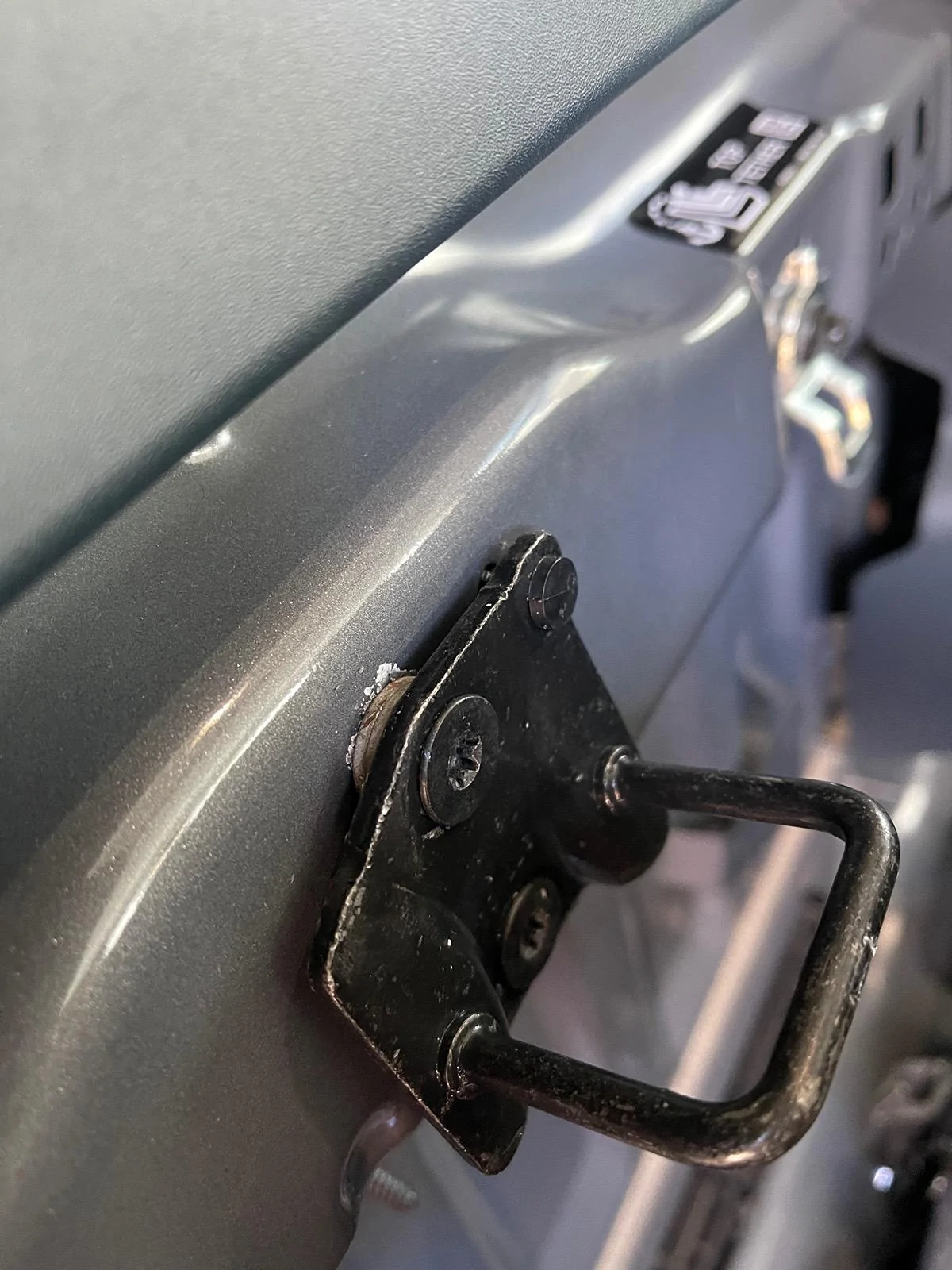

I cant figure out why the rear seat will not latch back. There are no obstructions and the pull cord returns when you pull it. It wont lock in place. Anyone else experience this?
JUST UNSCREW THE BRACKET OF THE CAR AND ADD 2 WASHERS TO SPACE OUT THE LATCH , I DID FIX MY DOING THAT.
