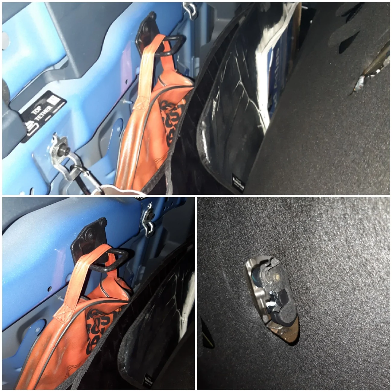

It took 4 years but this finally happened to me last night. I heard rattling noise coming from the back seat. Somehow it became unlatched. I had to sit on it near the latch pull and push back to get the latch to work. Easy fix! Lol
I wonder, why some seat backs are so hard to latch? I have a lot of stuff behind the seat back and it latches fine.​
