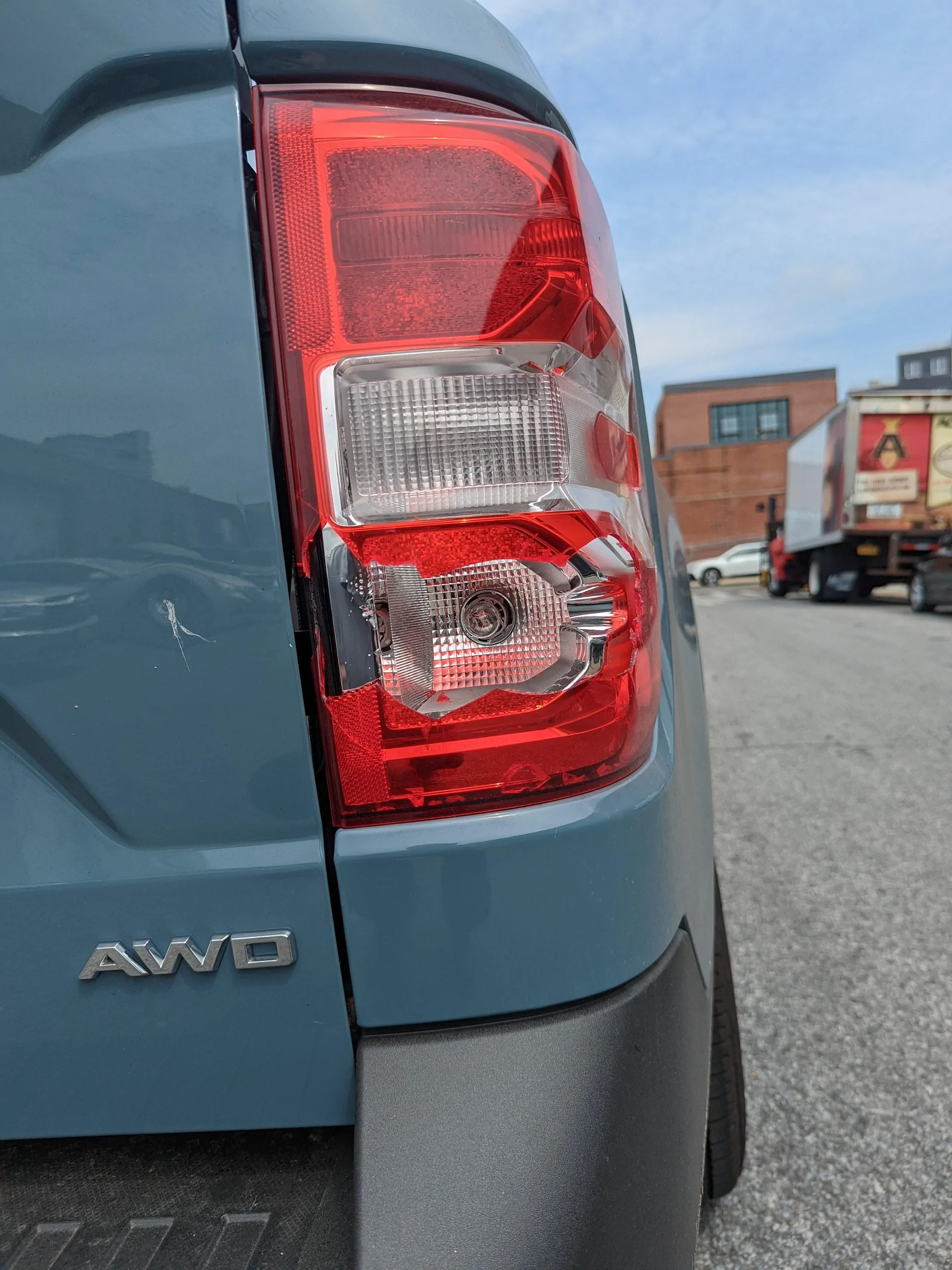

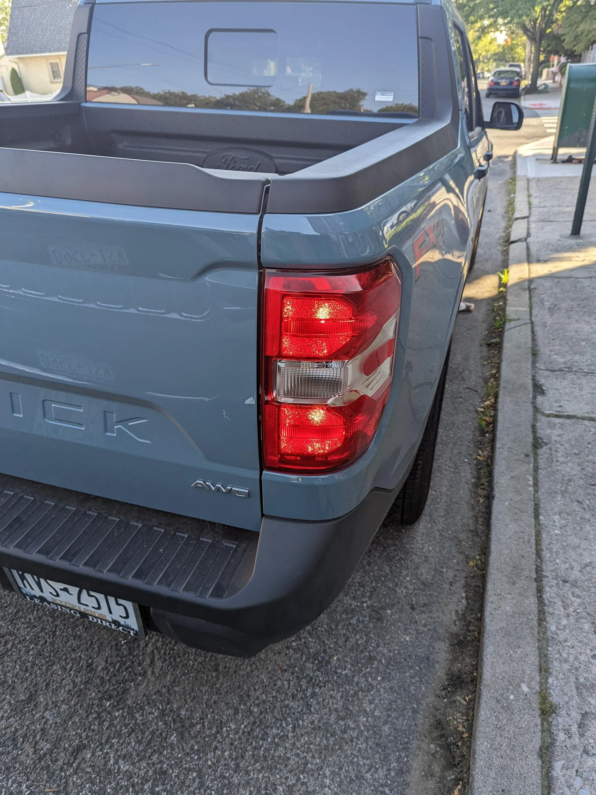

So long story short, as I was driving at 7 mph in traffic in Brooklyn, and an EBike rear ended me while trying to squeeze between a city bus and me.
He didn't quite make it. His left hand went through my passenger side tail light.
Ford Maverick Rear Passenger Tail Light Damaged by Ebike Screenshot_20220710-144758
(Image is reversed)
On the pics can also see the dent/scrape his handle bar left on my tailgate.

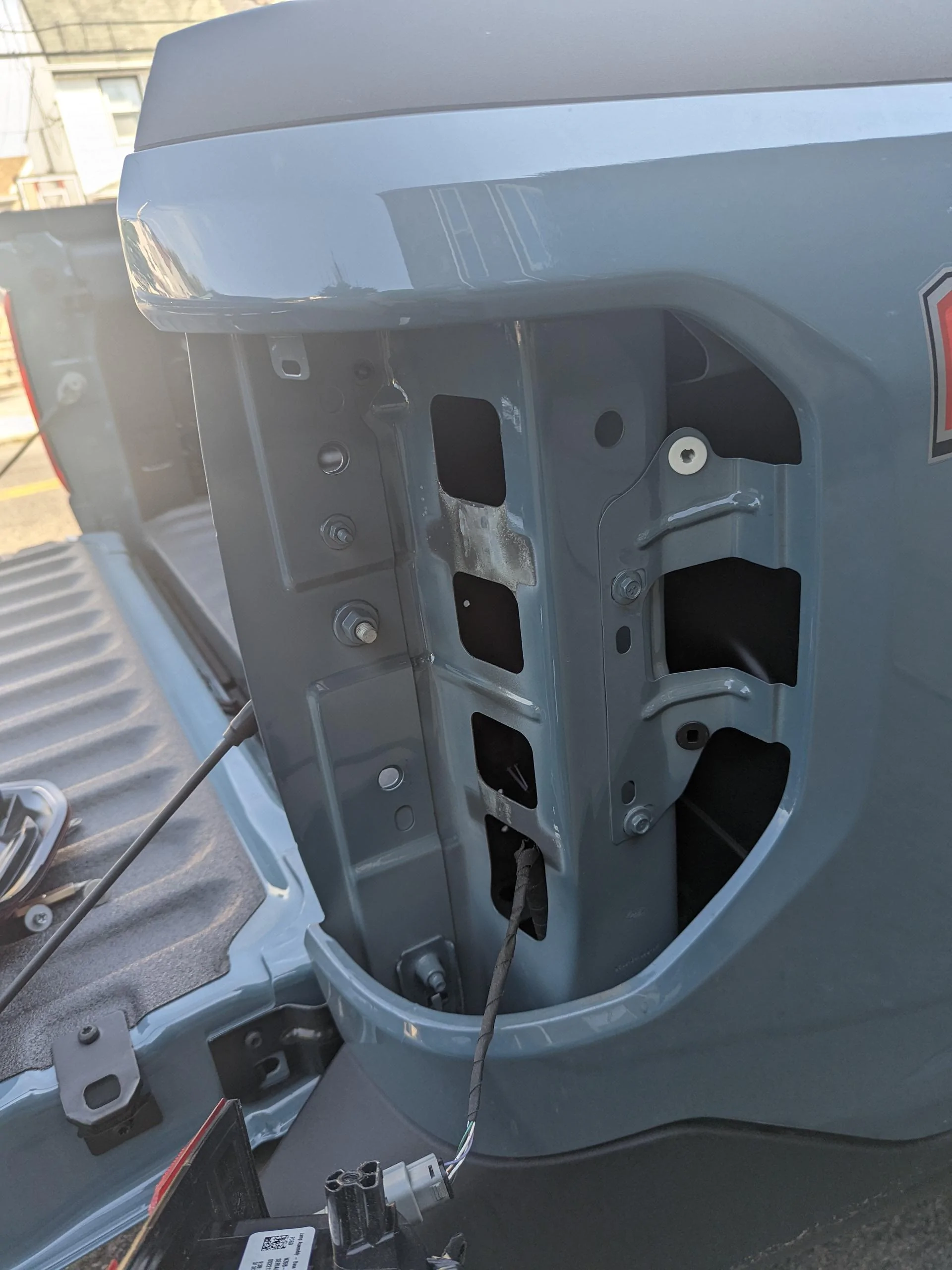

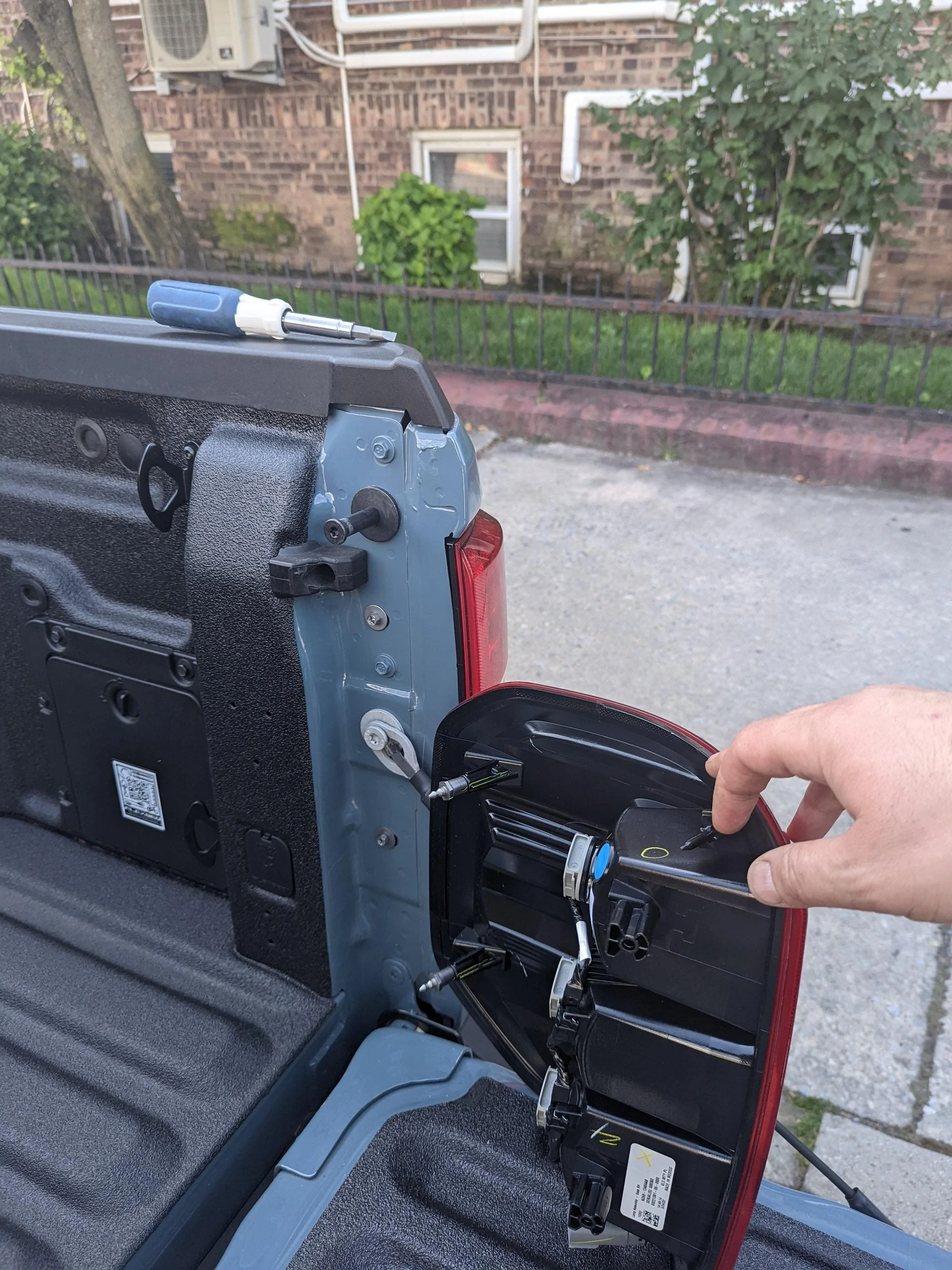

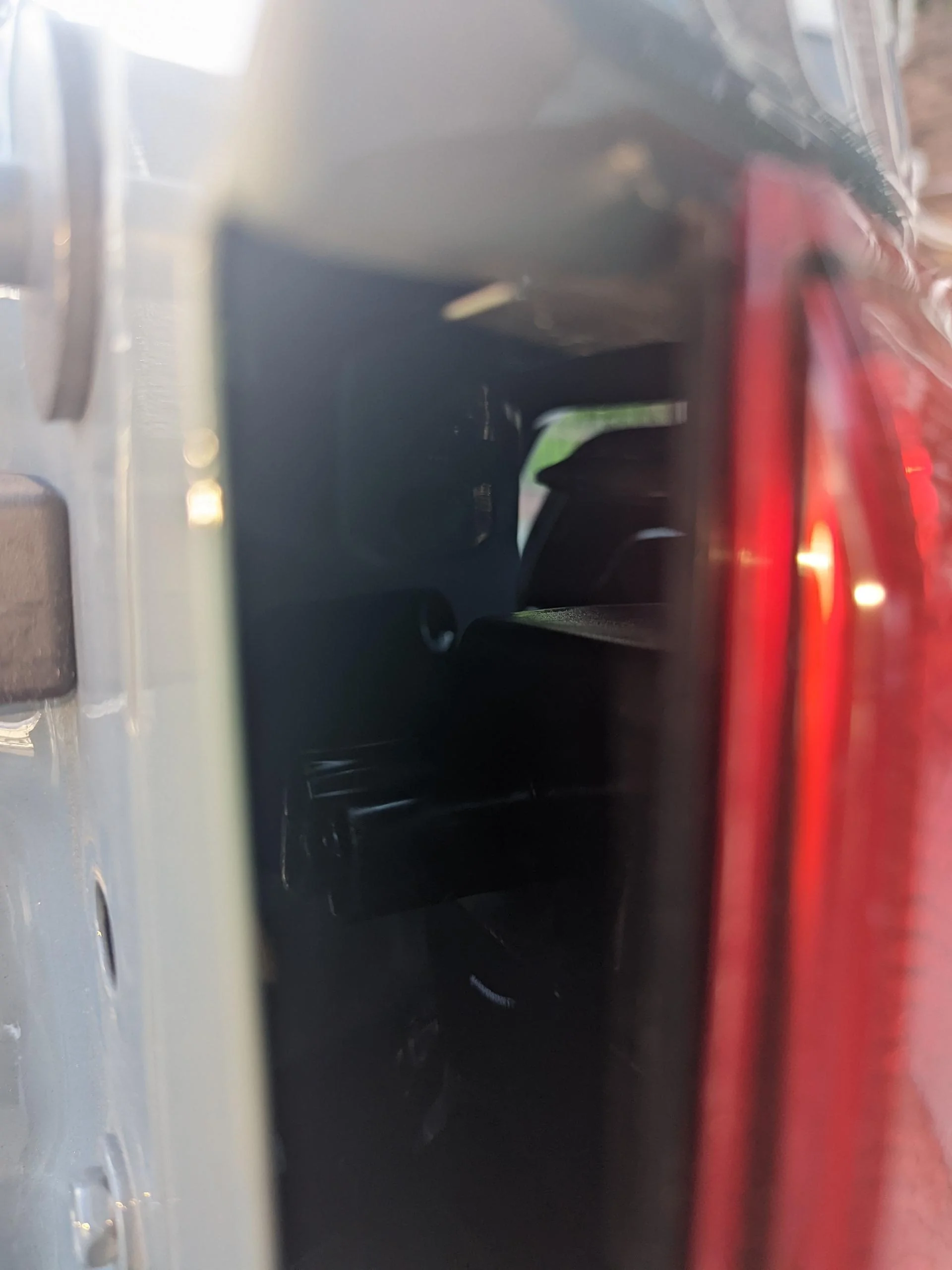

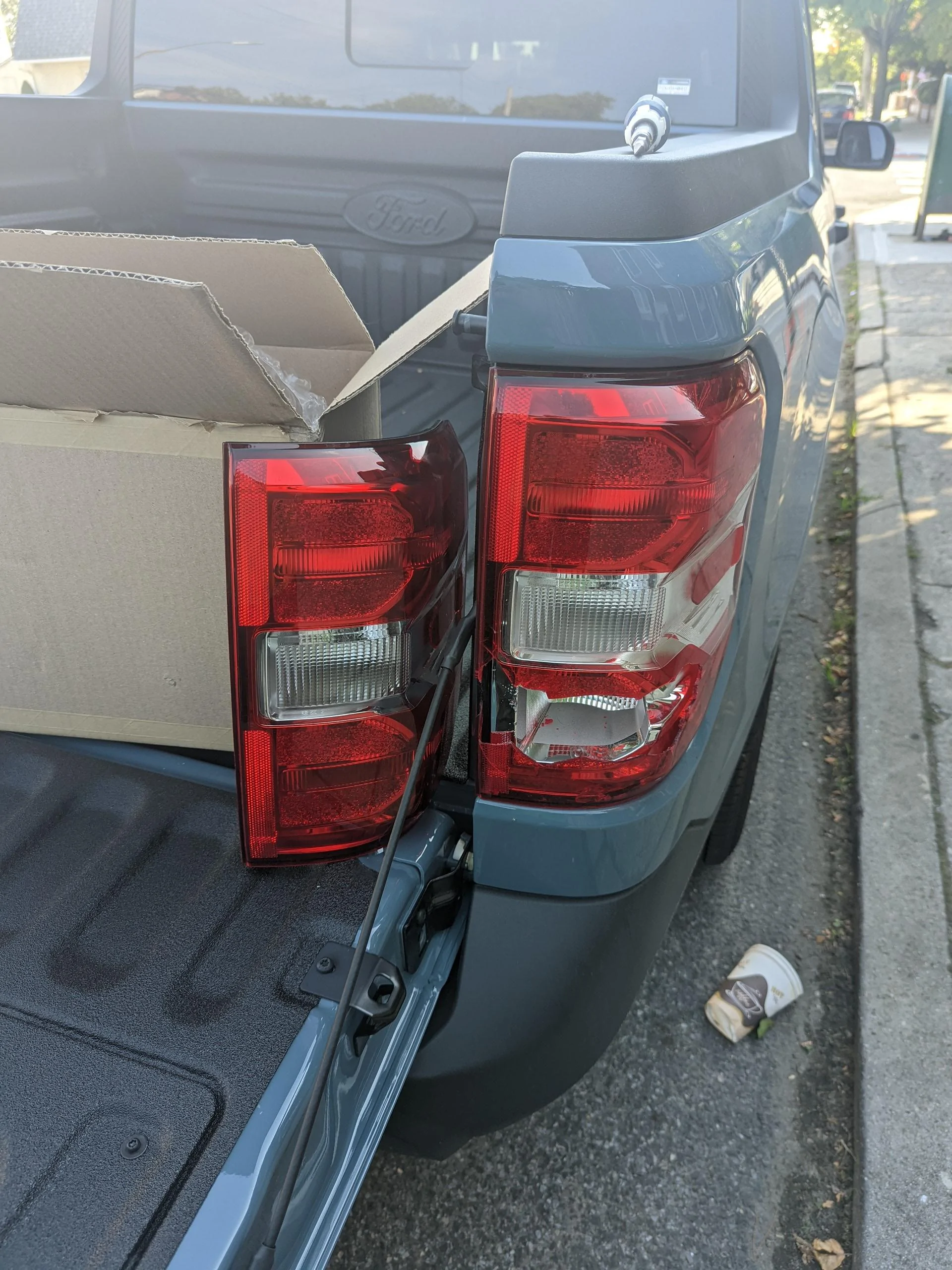

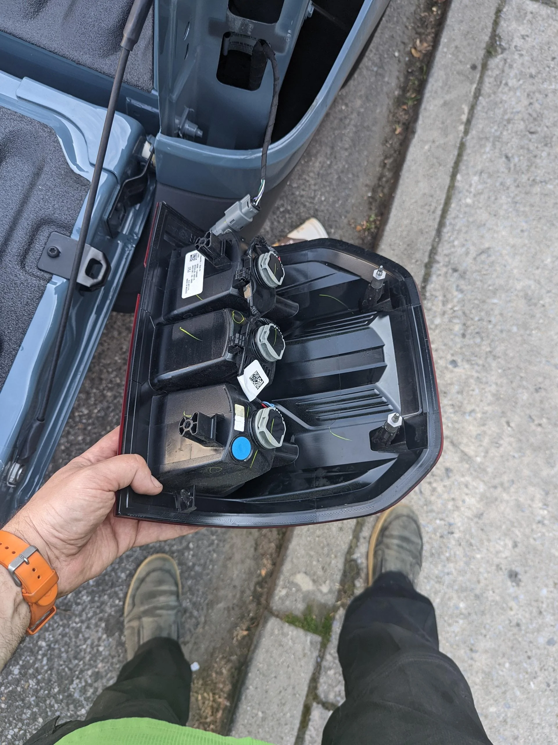

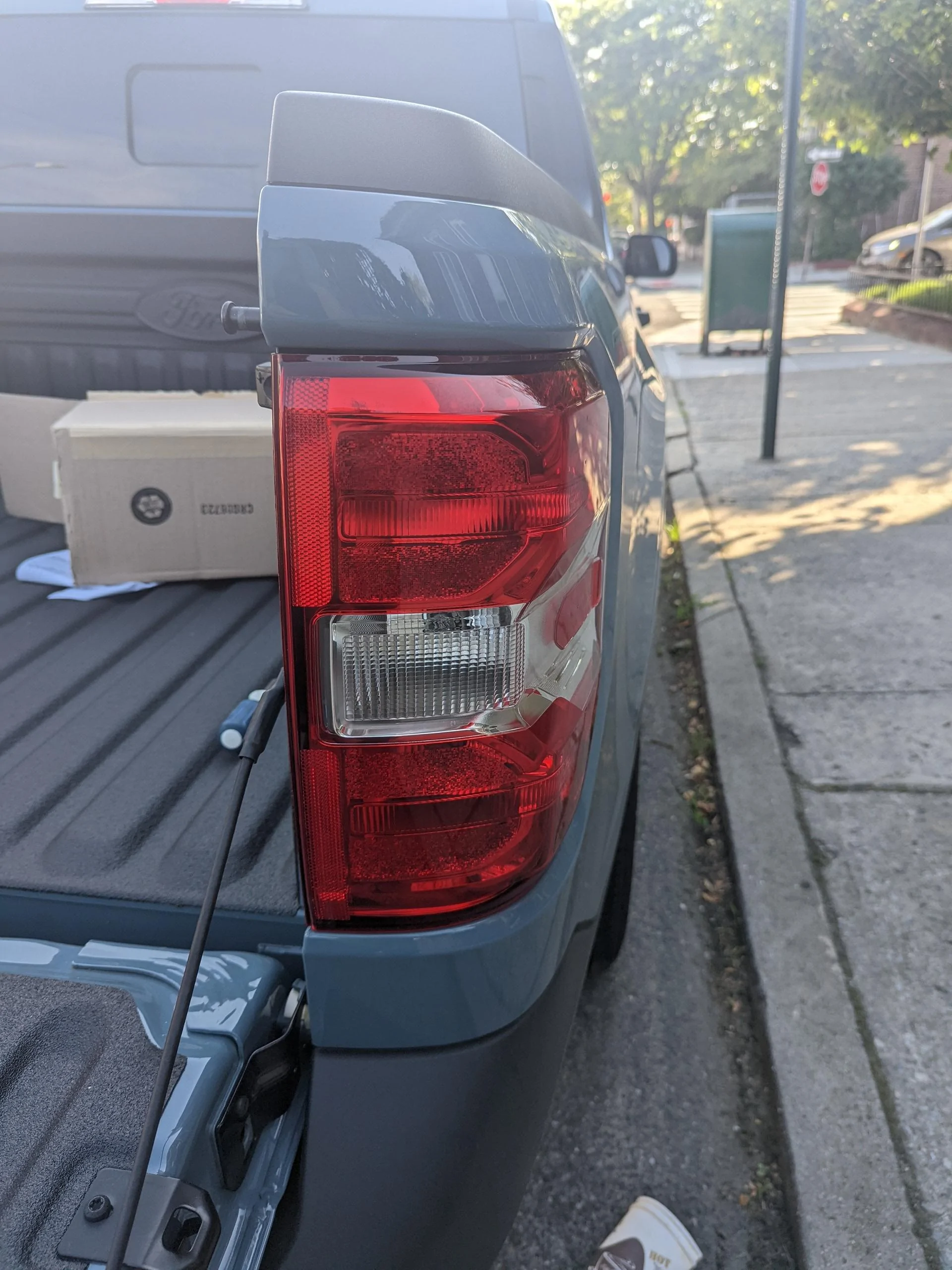

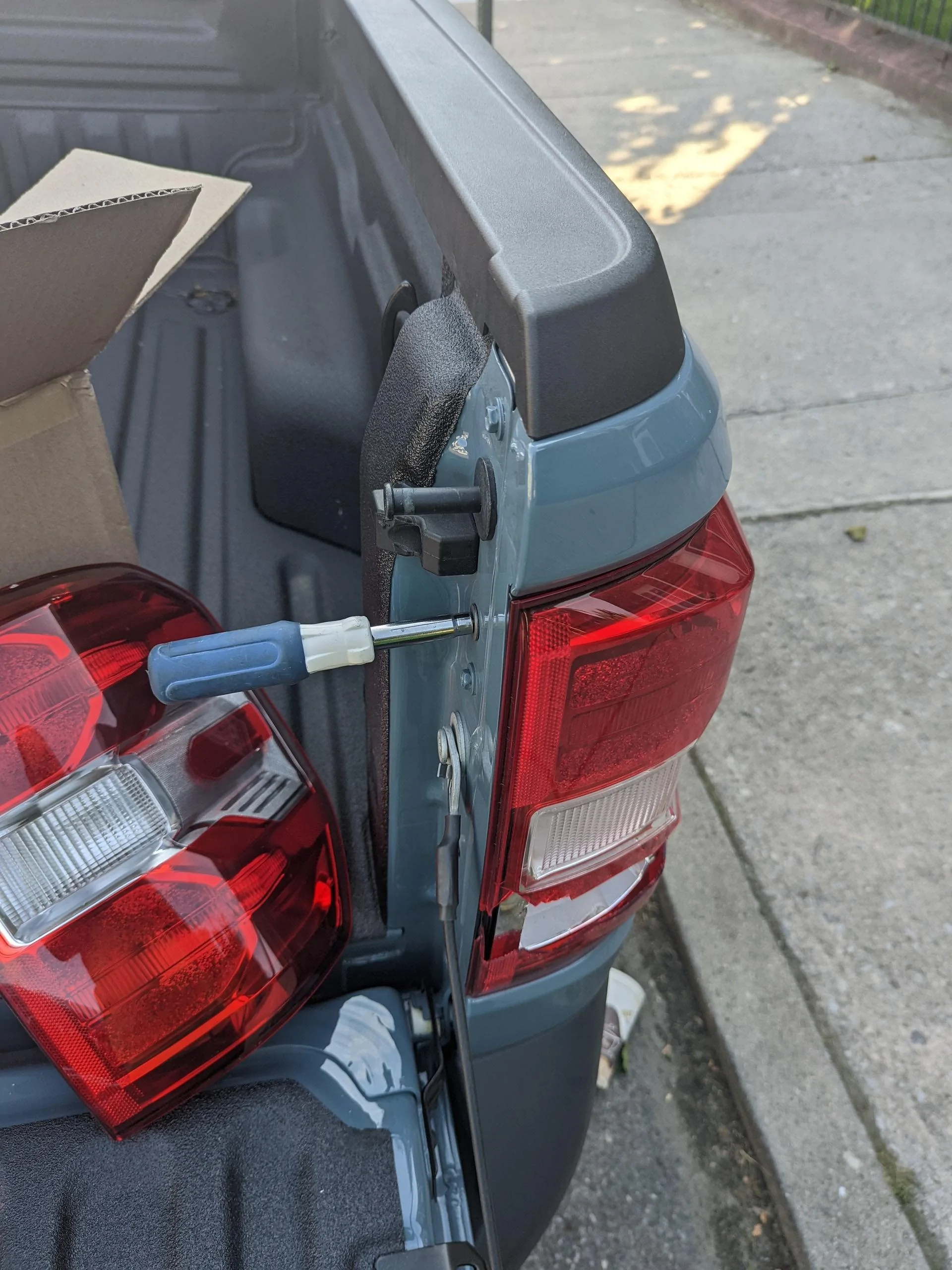

Repaired.
Here are the pics. Took about 5 minutes (plus 10 minutes to fish the bolt I dropped that fell into the bumper and then into the plastic undercarriage).
Here are the pics

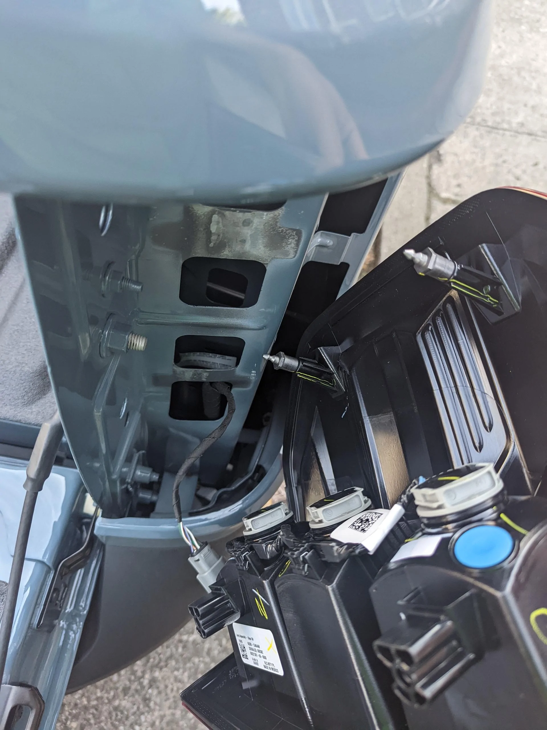

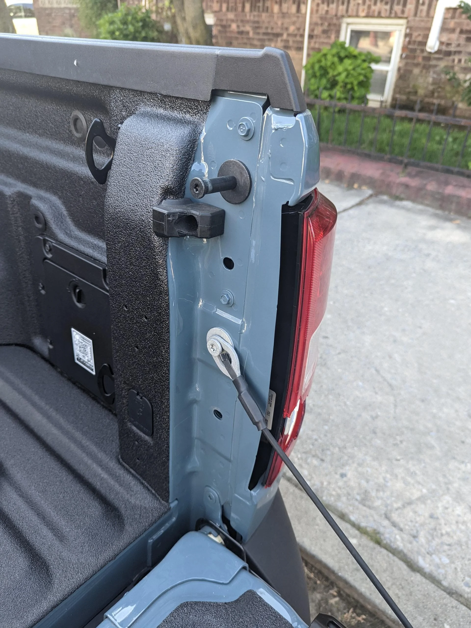

Sorry to hear about that. I hate city driving. Glad I live north of the woodchucks.
Ford seems to like leaving bare metal inside the tail light housing supports. Gonna be the first place I check in about a year or so on my truck.

It looks like there is only 1 electrical connector on the tail light, which daisy chains out to both brake/turns bulbs and the reverse bulb.
So where is the BLIS sensor? I thought it was integrated into the tail light assembly?
Bumper has the sensors (if equipped).

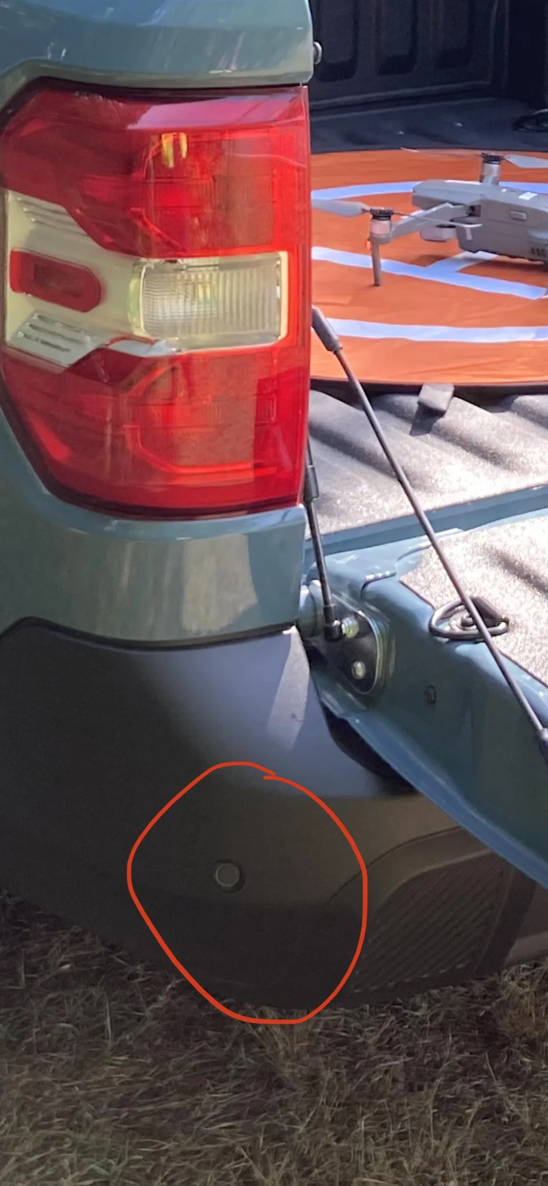

Not really a separate BLIS sensor. There are the backup sensors - 1 in each corner of the rear bumper cover and two in the middle. The ones on the sides help scan blind spots. Note the round black spots on this conveniently painted bumper cover.
