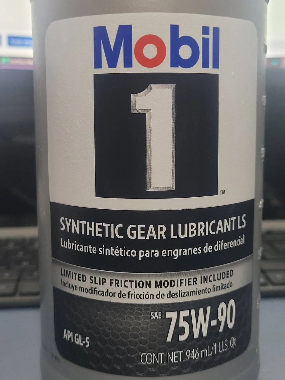

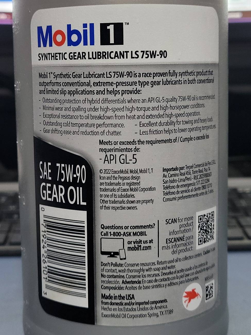

For the good of humanity, or at least the Maverick community. Thank you. How much is Blackstone's fee? And where did you get a quart of Ford 75W fluid for $30? One quart of the Mobil 1 was nearly $20.

For the good of humanity, or at least Maverick owners. Thank you. How much is Blackstone's fee? And where did you get a quart of Ford 75W fluid for $30? One quart of the Mobil 1 was nearly $20.

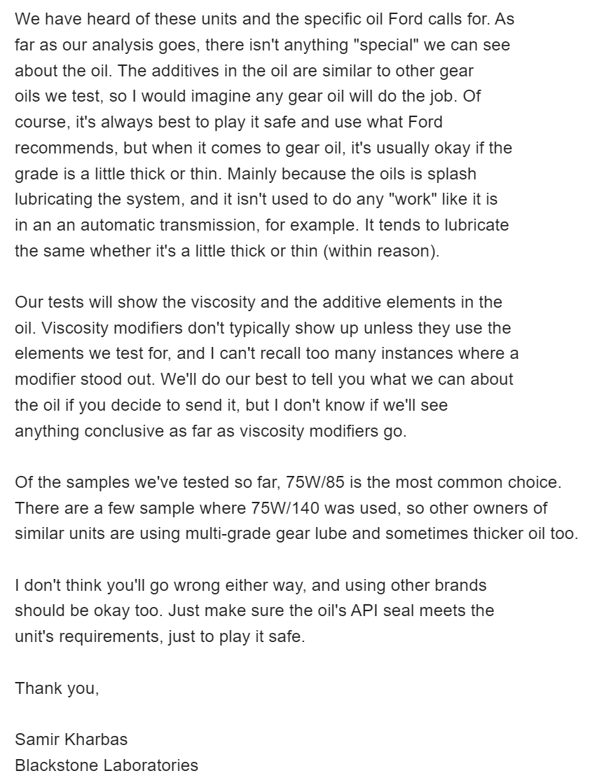

The response from Blackstone I got is pretty much expected. No clarification and I'll send them a sample to see what specific viscosity and additives are used.
Ford Maverick Rear FX4 Differential Fluid Screenshot 2024-08-23 134511
Literally all we want to know is the exact viscosity so we can shop elsewhere lol. It's crazy that FORD is even getting away with this. It seems very monopoly like to vaguely label a fluid this way. So I'll get it done and hopefully we get some clarification.

The response from Blackstone I got is pretty much expected. No clarification and I'll send them a sample to see what specific viscosity and additives are used....
[BLACKSTONE RESPONSE]
Wow, thanks for your efforts. That's pretty much how I felt about it. Nothing magically different about the Ford RDU and all the other diffs I've serviced over the past 50 years. A high quality synthetic gear oil with FMs should be fine. I am saving this response for future reference, in case Ford wants to tell me I should have used their overpriced monkey piss. And I feel fine using 75W90.
I run into the attitude all the time from dirtbike forums to pickups to cars, people who are afraid if they don't use the dealer recommended oil they'll void their warranty, regardless of how good the oil is. Example: it's a well-known fact that KTM has a contract with Motorex which is why they recommend it in all their bikes. There are many oils as good or better than Motorex, but chicken dirt bikers will pay double or triple to only use Motorex. Truth be told, that contract is very likely the result of KTM soliciting bids to supply oil for all their new bikes, and Motorex was the lowest bidder. The reality is a good oil that meets the minimum requirements, changing at recommended service intervals, your engine/transmission/whatever is going to outlive the warranty so it's a non-issue, PLUS the dealer is under a legal obligation to honor that warranty.
Thanks again.

Yea I just want to wait to see specifics so I know whether it's 85w or 140 or what. Given the fickle nature of the PTU and it's placement, as well as living in a colder climate. it's not something I care to guess on. Too thick and I'll have a putty inside my dif all winter.
I don't get it. Isn't it 75W, since that's what's on the label?

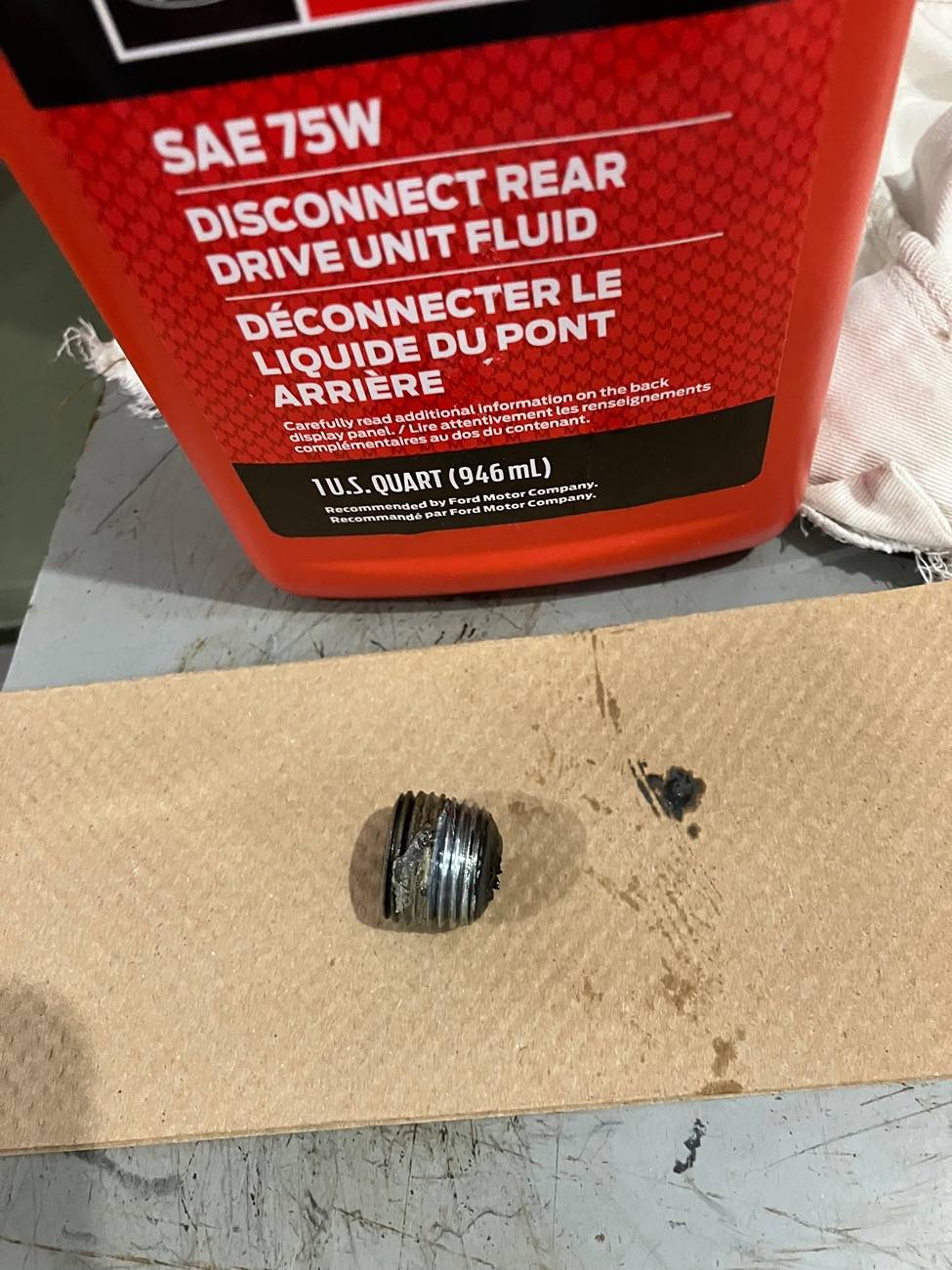

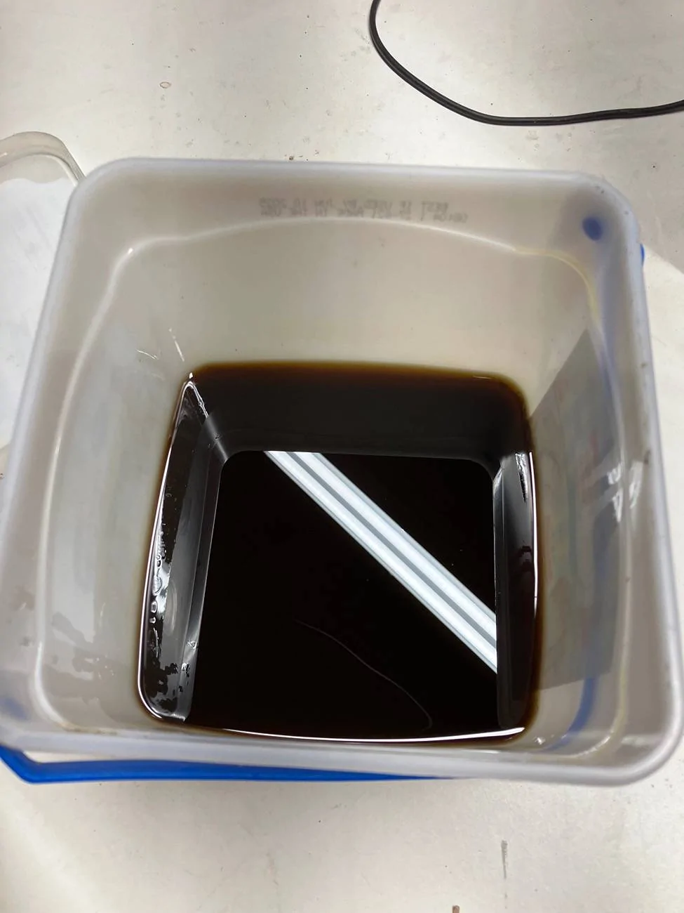

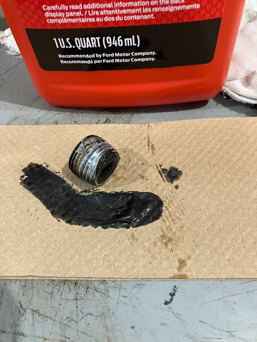

I've done mine twice now in 42K miles, the second time was noticeably cleaner. I'll probably do the third at around 70-80K.
