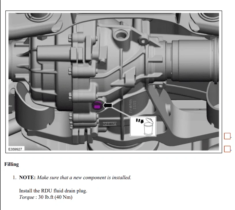

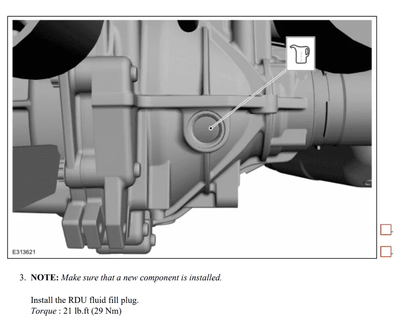

is there a tq spec for the drain & fill plugs?
