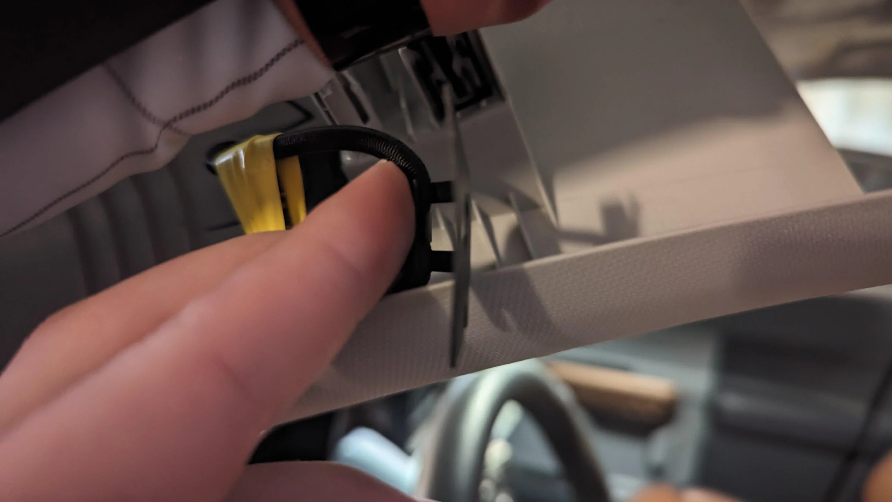

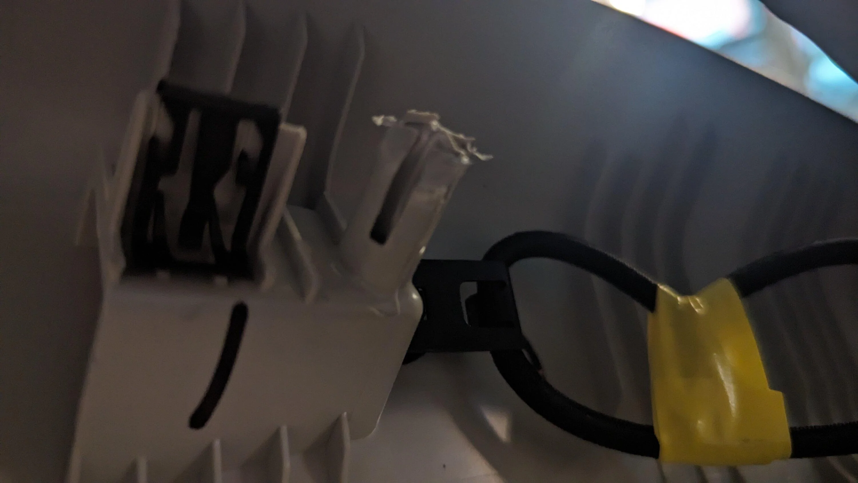

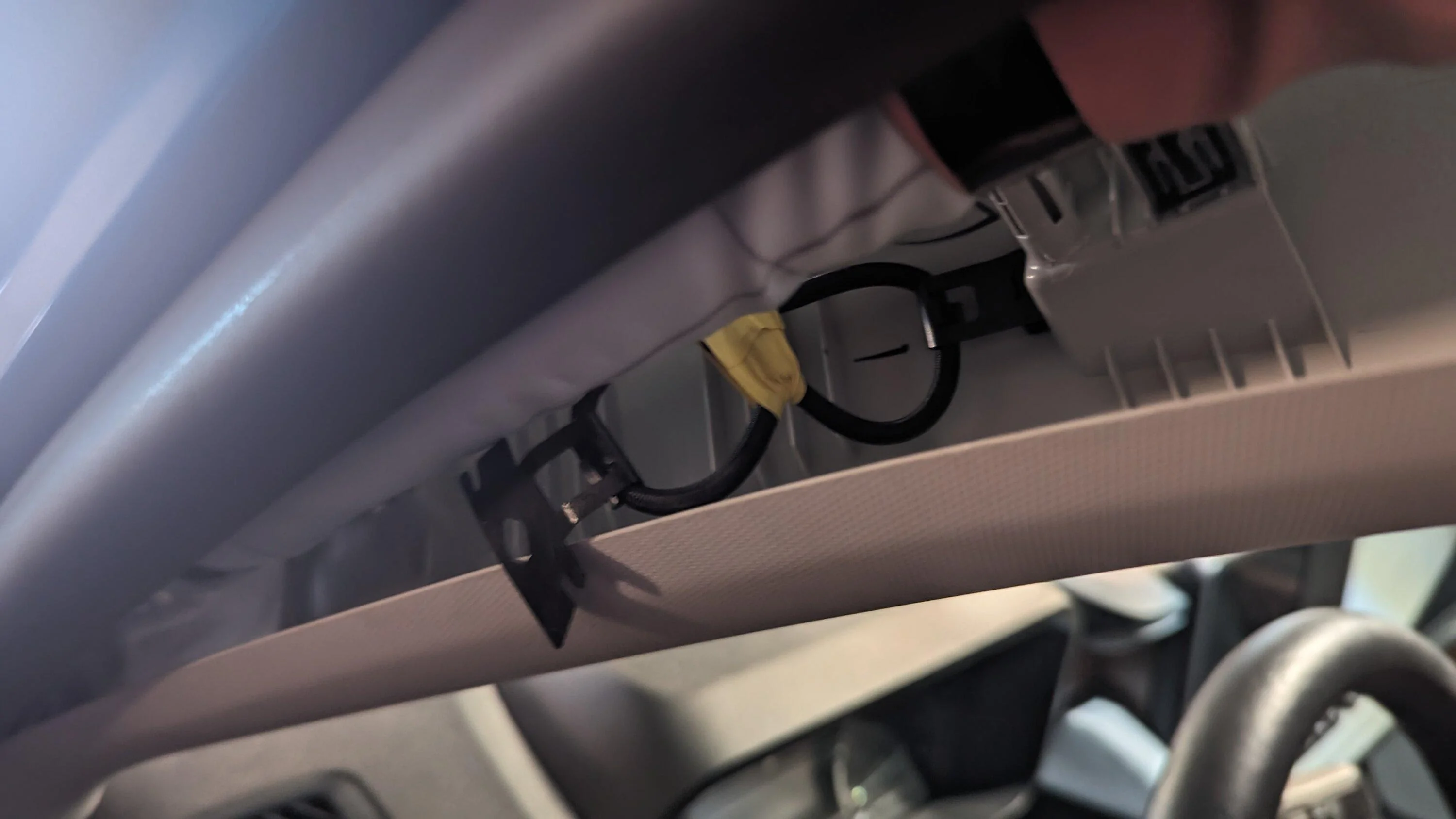

Absolutely not. Because here's the razor-blade like piece that's been dangling between the A-pillar plastic and my airbags on both sides for almost a year after the airbag recall. Caught this in December. There are two missing nuts with torque values specified that they did not put back.
In a best case scenario, the airbags would deploy in a way that's not consistent with Ford's engineers' design.
In a worst case scenario, that slices the airbags or me and my passenger.
Ford customer service has yet to find a way to fix this for me.

After this is fixed, my vehicle will never again go back to a dealer short of anything related to important recalls.
Once it's fixed, I'll write up a very scathing review of Ford and its dealer network on here so folks can see how I've been treated.
