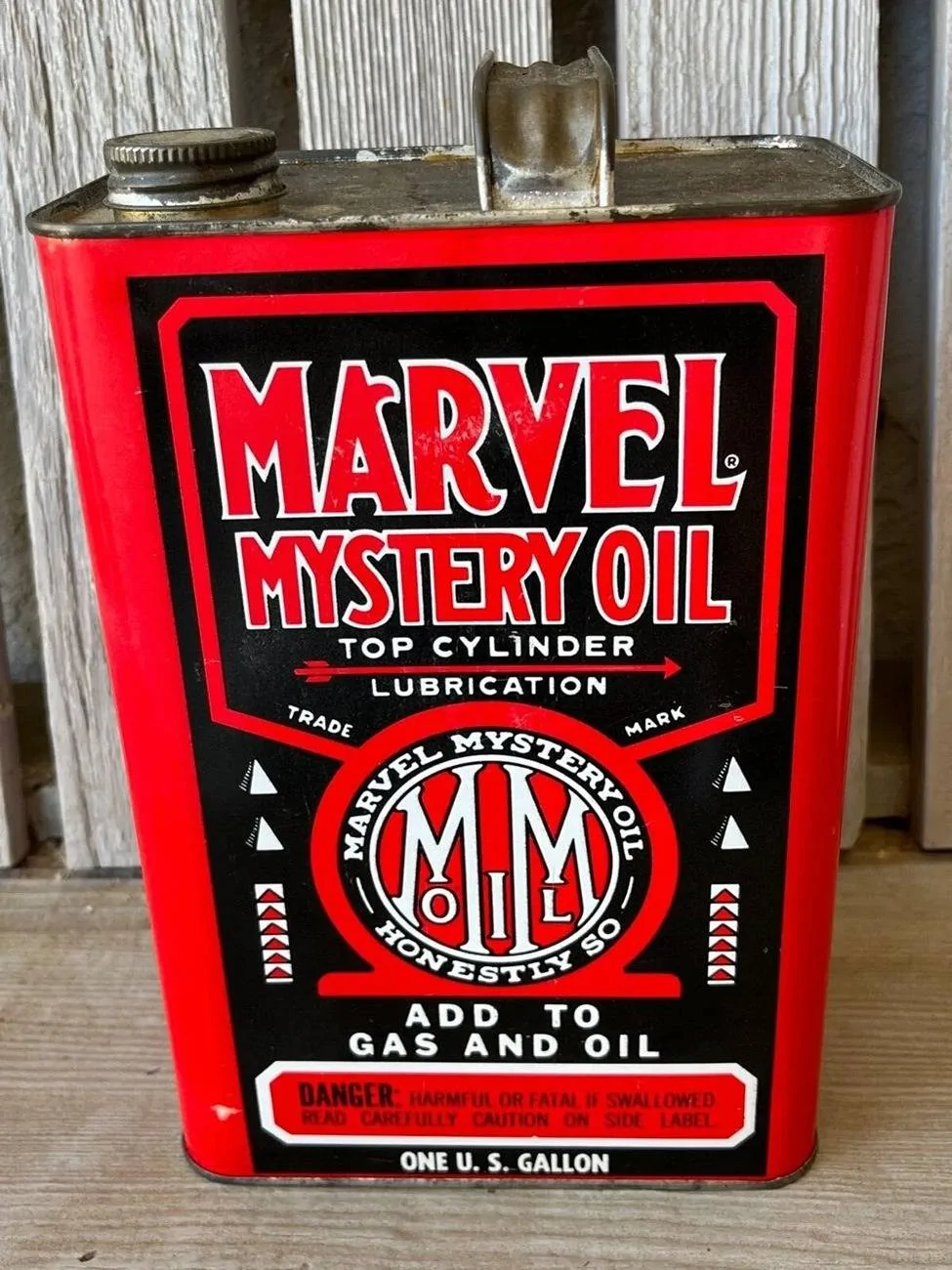

What would you send them? A tiny vial of your $50 quart of Ford RDU fluid? Remember Marvel Mystery Oil? When I first started driving and working on my own pickup in the 1970s I knew very little about what went on under the hood. So every now and then just to make myself feel better, I would dump a little magic in the oil filler. I suppose that's why most people would add STP, another popular additive in the era. It made us feel better. Of course there were the racers who knew exactly what it did and used it because they had to.
