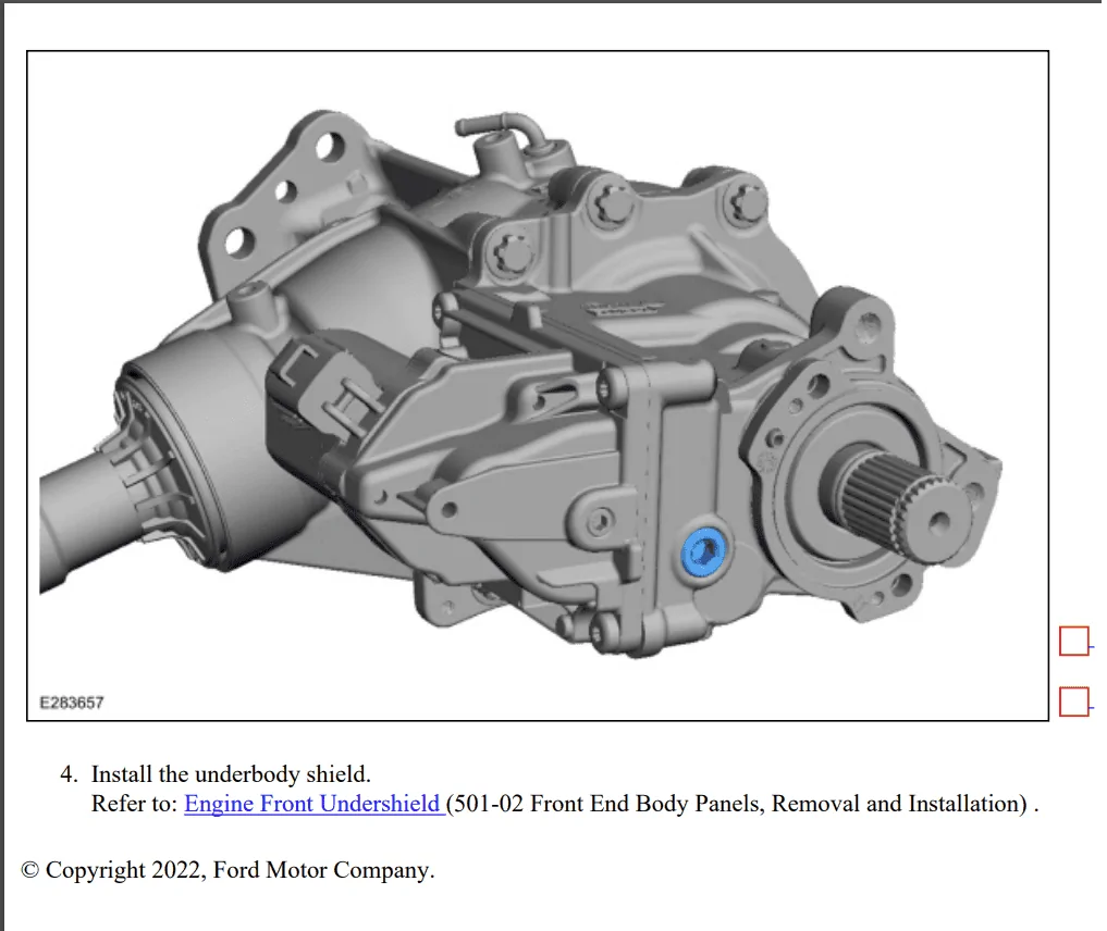

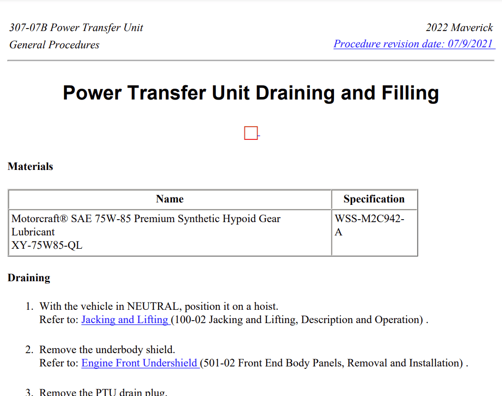

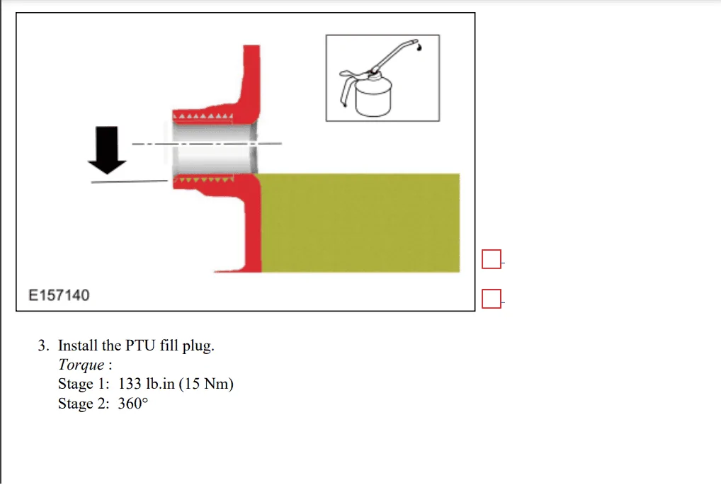

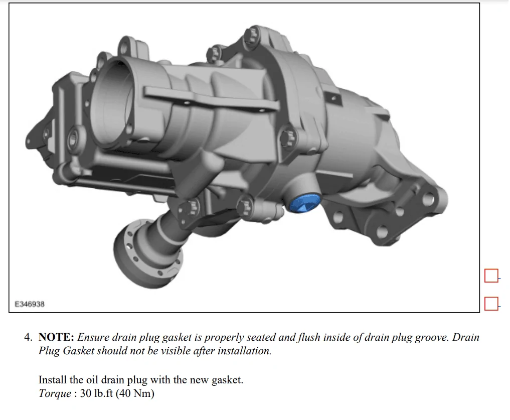

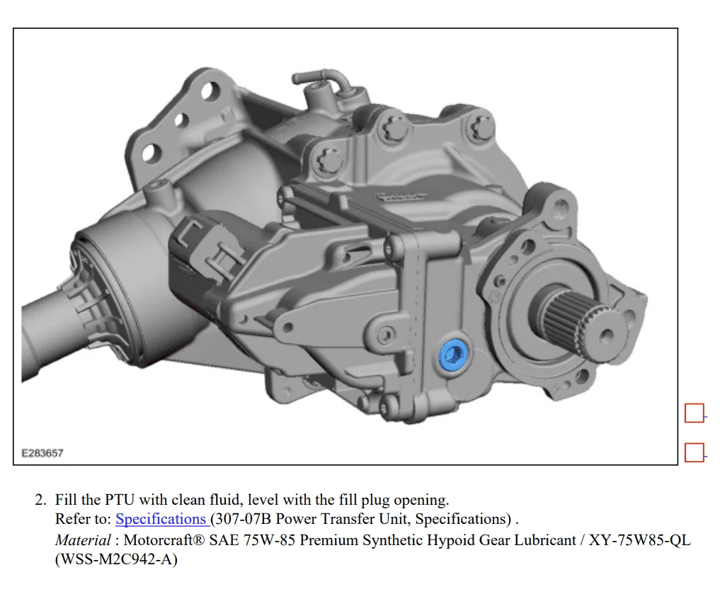

Also if anyone is interested here is the fluid specs and oil change procedure for the PTU. I can post the procedure for the rear diff as well if anyone is interested. Just let me know.
1. Remove the filling ptu plug.
