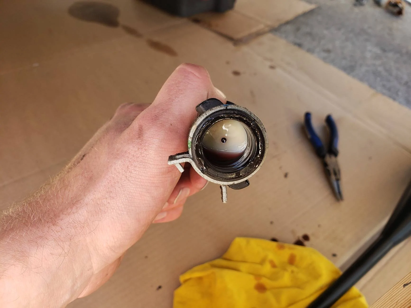

That was my experience exactly as well when filling the ATF through the vent tube. Did you remove the airbox to get to the hose clamp on the vent? With the airbox out there was plenty of open space!
My PTU was also underfilled. Crazy how they're coming from the factory like that!

I just changed all powertrain lubricants in my maverick at 15,000 miles. I don't drive it hard, but I don't drive it lightly either. I towed a 2,000 pound boat and trailer for maybe 3,000 of those miles so I figured it was a good idea to do a break in change, especially since I hear horror stories about the PTU being underfilled.
The transmission fluid looked clean. Minimal sparkling, no chunks, shavings, or bits visible to the naked eye. 4.25 quarts came out. Filling it up was a fiasco. I tried filling it through the vent - big mistake. Transmission fluid trickled out from between the funnel spout and rubber vent. I strongly recommend people do themselves a favor and remove the hose clamp and take it off. Filling it was a breeze. I have no idea how much I put it. I used up 5 quarts, but I have no idea how much I lost from spilling some. My guess is I lost about a fourth of a quart, not much more, not much less. I decided to just put everything in and then check the leveling plug. I went for a quick drive through town and then the highway to make sure I got the fluid up to temp. When I opened it up, a fourth of a quart trickled out.
The differential was the easiest of them all. Quick and easy access. The fluid was clean, BUT I was a bit surprised by how much sludge was on the magnet for 15,000 miles.
The PTU was very worrisome. I should have measured how much came out, but it was WAY underfilled. Thanks Ford. Glass half full is that the fluid was clean. No shavings, bits, or chunks. Another surprise was that there was less sludge on the PTU magnet than on the differential magnet. That was a head scratcher.
The biggest mistake I made was not filling up the ptu immediately after hearing all these stories. It was a commonly reported problem. Very disconcerting to know I drove 15,000 miles like that.
