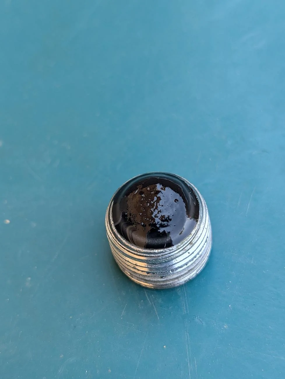

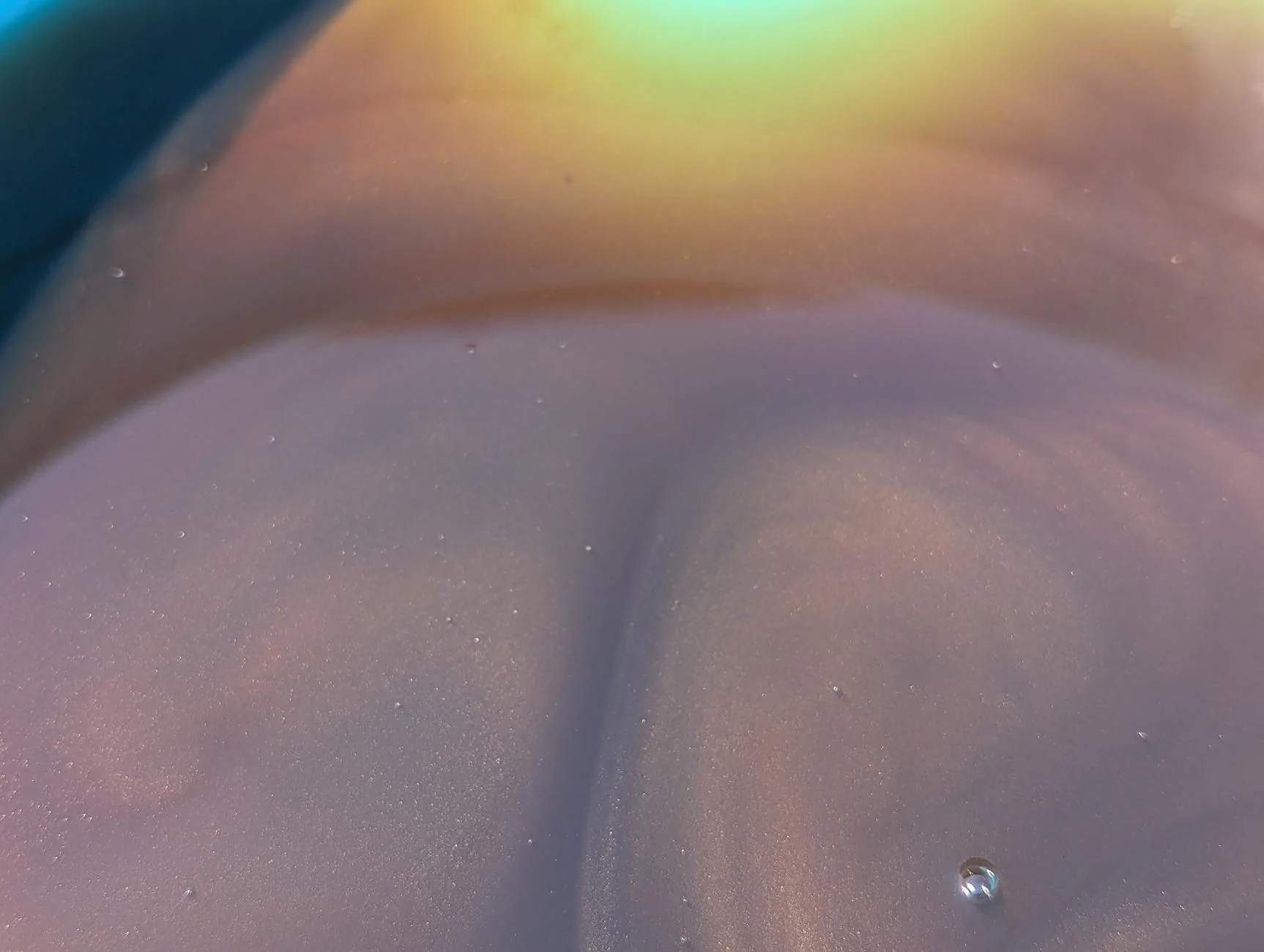

Ford Maverick Oil change & Rear differential fluid change PXL_20240709_165650775
Ford Maverick Oil change & Rear differential fluid change PXL_20240709_172810469.MP
Ford Maverick Oil change & Rear differential fluid change PXL_20240709_171236679
Pictures of products used and the RDU fluid state (metal on the plug & glitter in the fluid) after 4800 miles.

Did the PTU lube change the next day. Not that it absolutely needs the fluid changed on either one right away. I do think that it can't hurt to remove the "break-in" fluid and get those metal shavings out of the case's. I'm of the opinion( along with other proof from mechanics from previous Ford models with these units) that when the PTU and the RDU units are ignored, that it can cause these to fail prematurely.

I did my first RDU/PTU D&R at ~15k, again at ~30K, and third time at ~60k.....by the third time at ~60k, both fluids were barely distinguishable from new. So, I'll wait to do #4 at ~100k. The take home; the first two seem to get you the most bang for your buck. 🤠
