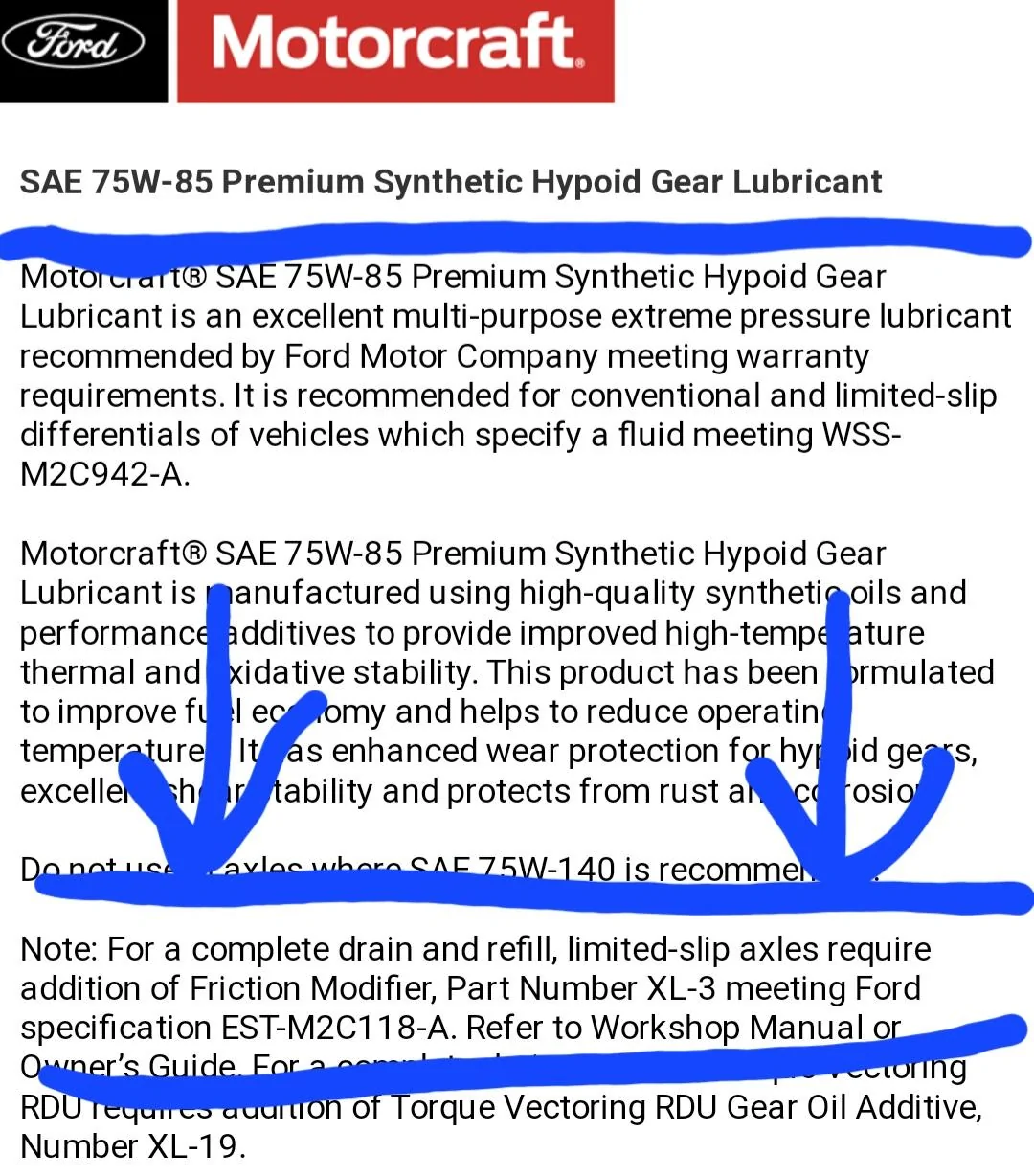

No. It must have the special additives (friction modifiers) for the clutch packs. Regular gear oil is only good for non-limited slip differentials.
The Motorcraft 75W85 gear oil does not have friction modifiers in it... (see pic of label)
Ford Maverick Rear FX4 Differential Fluid Screenshot_20230903_174129_Chrom
