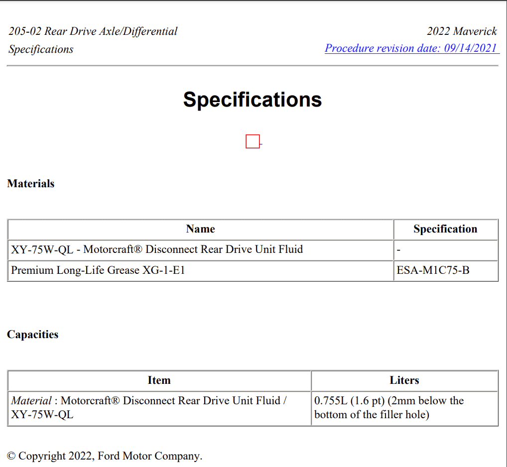

Here are the rear differential fluid specs and capacities from the service manual. Hope this helps!
Ford Maverick Rear FX4 Differential Fluid image_2023-06-20_184537043

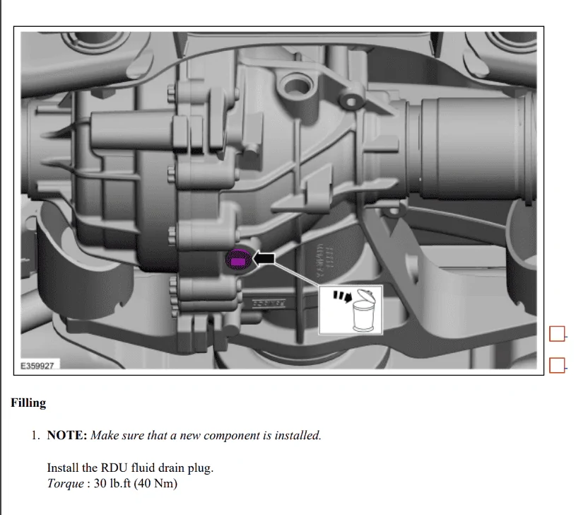

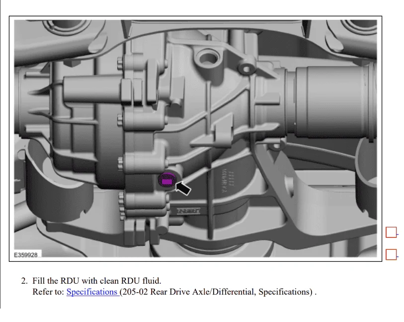

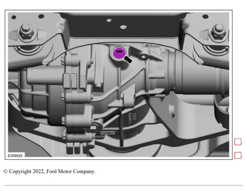

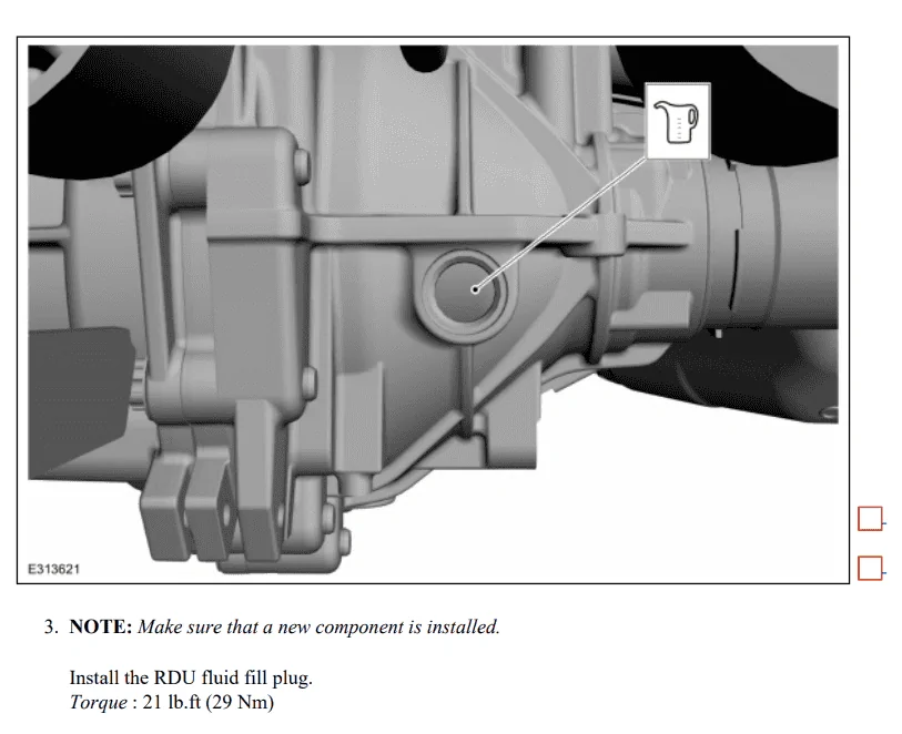

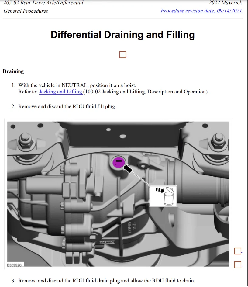

Alright here is the procedure to drain and fill the rear diff. In the service manual the fluid level check is a different procedure. I can post that to if anyone is interested. Just let me know.
Ford Maverick Rear FX4 Differential Fluid rear diff1
Ford Maverick Rear FX4 Differential Fluid rear diff2
Ford Maverick Rear FX4 Differential Fluid rear diff3
Ford Maverick Rear FX4 Differential Fluid rear diff4
Ford Maverick Rear FX4 Differential Fluid rear diff5

Interesting the manual says to remove and then discard the plugs. Anyone know why that is?
(((( EDIT: I think I'm wrong about it being a Yield Tightening bolt. Looks like it just has a plug that comes with it's own sealer already painted on the thread, so get two cheap Ford-brand plugs for $6 with new sealant coated on there. ))))
Engineers decided there was too much vibration on that diff.
They spec'ed a "Yield Tightening" bolt, which means it locks & seals by actually deforming the threads just a bit, if torqued down precisely right.
Proper tightening torque is mandatory. Use a torque wrench.
Can't use it again since the threads have actually been permanently deformed, although you could if it's not cracking the threads (undamaged) & you applied epoxy or Loctite to the threads, not recommended here because it's easy to foul up the job.
(Plastic Deformation is a permanent set, slightly beyond the yield point of a metal, similar in concept to Stretch Bolts, but the plugs here just use it for sealing & anti-loosening effects.)
When you put a lock-washer under a bolt head, you get a similar effect, in that the washer is crushed (plastic deformation region of the yield curve) to conform, seal, and prevent loosening.
If you ask chat.openai.com (ChatGPT) this question: "Explain how a yield tightened threaded bolt seals." , it's answer is pretty good.

Also, I find it interesting the other thread on this topic where someone used the incorrect fluid, didn't mention anything about this - well... not that surprised I guess... :rolleyes:
I'd definitely stick to the Motorcraft 75W Disconnect fluid here, since there are clutch packs that require very specific frictional fluid properties to prevent chatter.

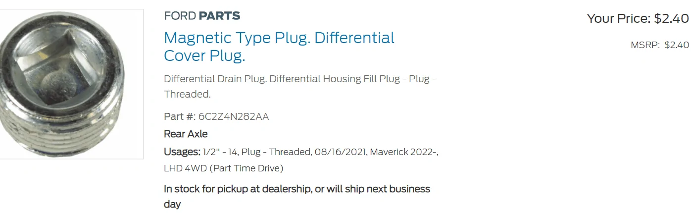

Drain, and also the Fill plugs, are very cheap at dealerships, and they likely have them in stock. Order online or give the parts counter
Part #: 6C2Z4N282AA
, two of them.
I might be wrong about them using Yield Tightened threads here. Now that I look at the part, it is coated with a sealer, which also creates thread friction to keep it from loosening. Taking it off scrapes the sealer off the threads, that is probably why they say throw them away.
Nice they have built-in magnets, and still so cheap. Dorman or other parts brands, make this pipe plug, 1/2"-14, but Ford actually sells theirs cheaper, with the sealant and magnet.
Ford Maverick Rear FX4 Differential Fluid Screenshot 2023-06-22 211307
Of course most can be reused many times with no adverse effects.
I have cheated a little on some non-resuble parts by putting some RTV sealant, a thin coating, on like 3 threads toward the outside casing side. Seals, & kind of weakly glues it to keep it from loosening (leaking).
I can't recommend that though. Could cause leaks later.
Part #: 6C2Z4N282AA
, two of them.

Yea I got all the correct fluids from Rock Auto. It's pretty rare that a fluid costs more than Amsoil... but this is one of them. Not really fond of having to do this, so hopefully in the future as more info comes out, I can save on the next fluid change.
The dealer did have the drain and fill plugs and as you said, surprisingly cheap. Still, sucks to even have to do this, but whatever, not that big of a deal. I already got them, but I'll update the thread once I pull them and inspect. I suspect FORD is just being overly cautious here and like you said again, it's due to a sealer. If that's the case, the manual should just specify to use a sealer. But that would make too much sense...
I suspect a simple RTV would suffice here? Or just use a PTFE like Teflon paste? Of course, less is better either way.
