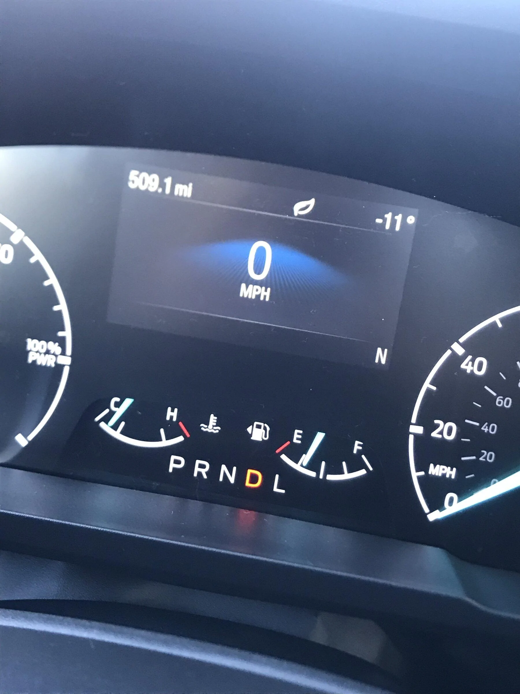

Happened twice today with mine. Key start, not remote start, so we can rule out the ford pass being an issue. Both times the coolant temp stuck at COLD for 30 minute drive and the out side temp stayed at -11 degrees – 0 degrees when it was 27 degrees out.
Maybe it’s thermostat related
The ambient temp sensor on my Mav had to be re-wired by the dealership. They worked with Ford to make that happen. Not sure if it's the fix for this issue, but the sensor reporting the wrong temperature was what was happening with mine.

Interesting. Mine shows way colder and yours showed hotter. Maybe it’s because of the wind hitting the sensor and the engine being cold from not running much?

Happened twice today with mine. Key start, not remote start, so we can rule out the FordPass being an issue. Both times the coolant temp stuck at COLD for 30 minute drive and the outside temp stayed at -11 degrees – 0 degrees when it was 27 degrees out.
I take it that you had heat turned on in the cab?
If so what was the temperature set to?
On your 30 minute drive was the ICE engine running continuous?
Did the cab warm up to what you were asking for or did the cab stay cold?

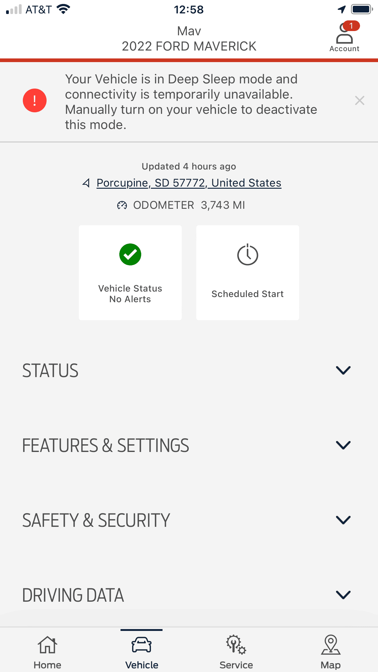

Noticed mine just got an over the air update today. Haven't checked to see if there were any changelogs or notes that came with it. However, it did disable remote start until I physically get in the truck and turn it on for the first time. I don't know if this is infotainment related only or if this could be an update to "solve" the remote start/cold idea problem.
My truck dropped offline then as well after displaying this symptom this morning at 0 degrees F.
