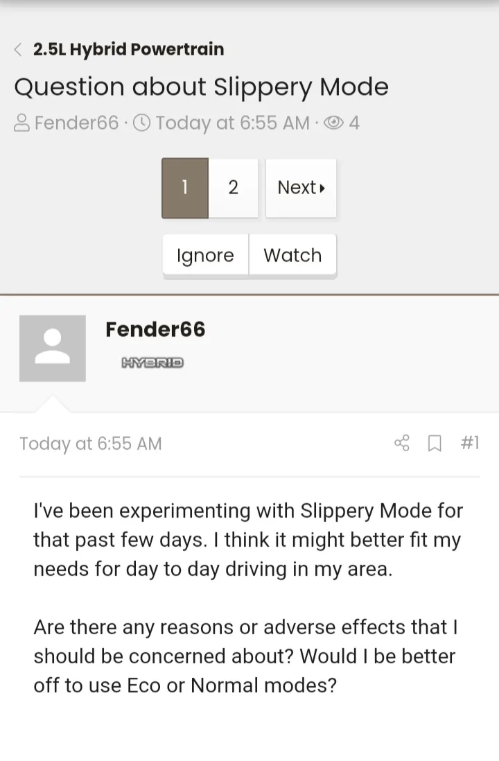

I've been experimenting with Slippery Mode for that past few days. I think it might better fit my needs for day to day driving in my area.
Are there any reasons or adverse effects that I should be concerned about? Would I be better off to use Eco or Normal modes?
