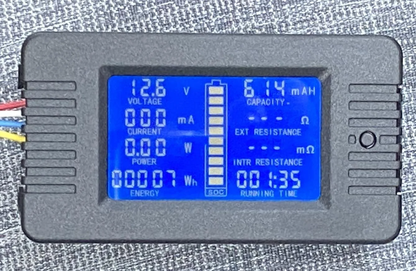

I put a 12v data logger on mine.
The truck draws 5 watts for 90 minutes after you turn the key off. Then it draws absolutely nothing after that. Or below detectible limits.
The limit of my data logger is 20 mA.
That's 0.02 amp. There is no parasitic draw. But my battery won't hold a charge. Park it at 12.4 or 12.5 volts. Next morning the dome light and parking lights come on when you open the door - this draws a minor 4.65 amps, or about 55 watts - but that tiny draw pulls the battery down to 11.7 to 11.9 volts.
Your truck will start if the voltage is high enough to run the computers and close the contacts on the HV battery that really starts the engine.
Ford Maverick ANOTHER deep sleep mode question IMG_0080

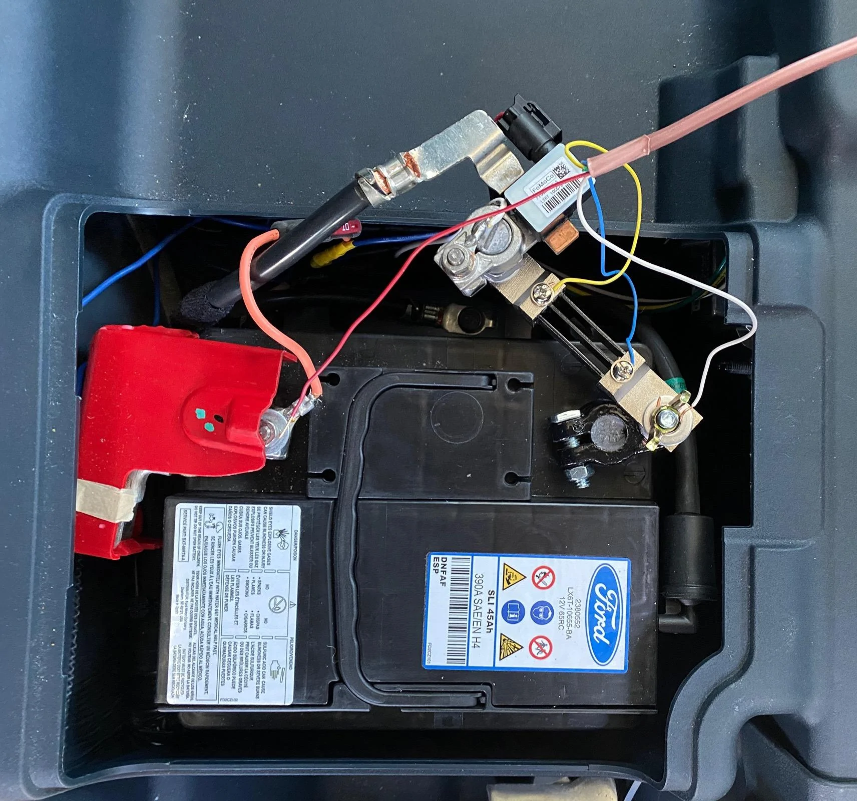

Data logger put on under seat battery.
After 1 h 35 min only 7 watt-hours were consumed from that 12 volt battery and 0.00 mA draw at the time the photo was taken and was zero for the rest of the overnight period.

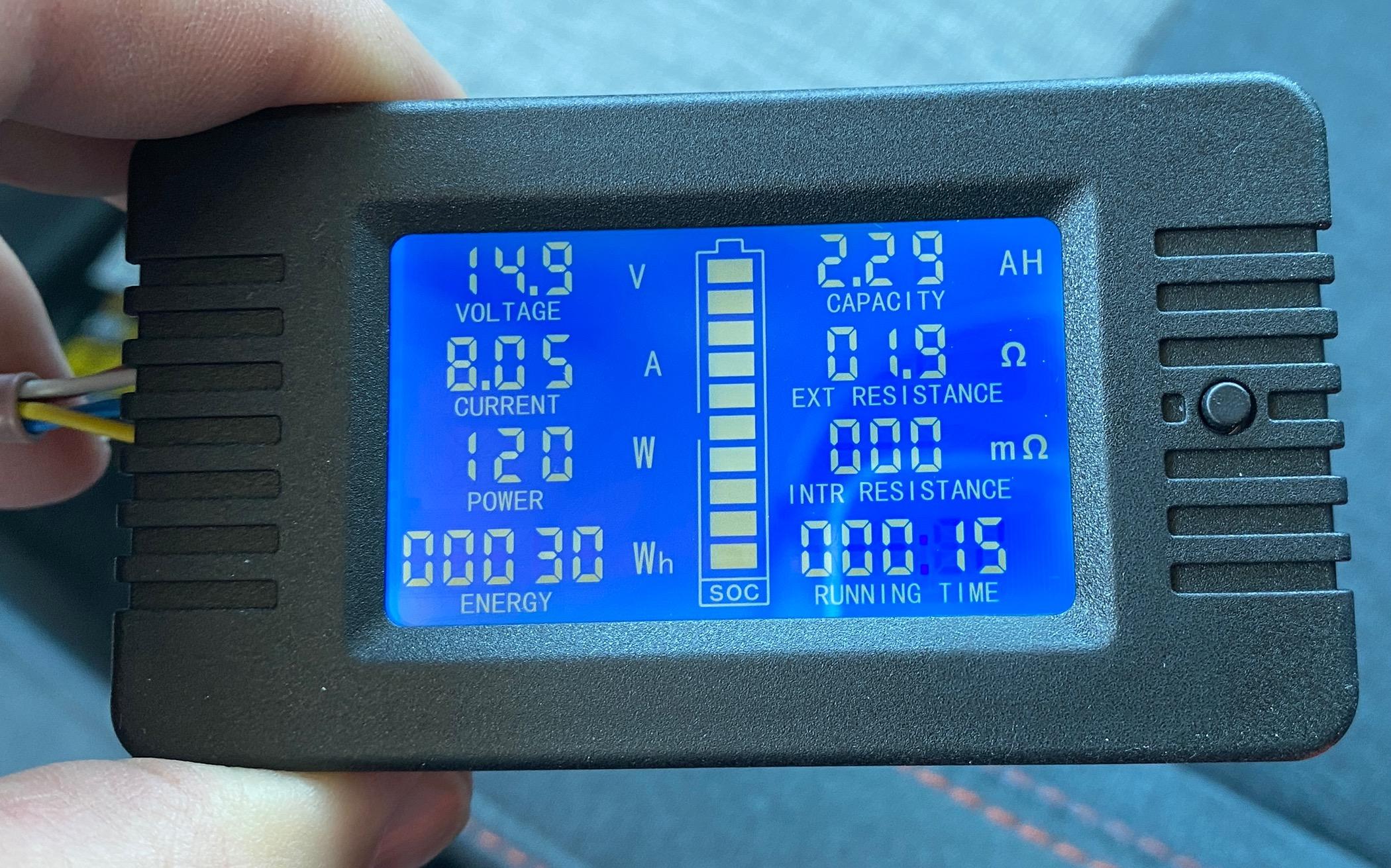

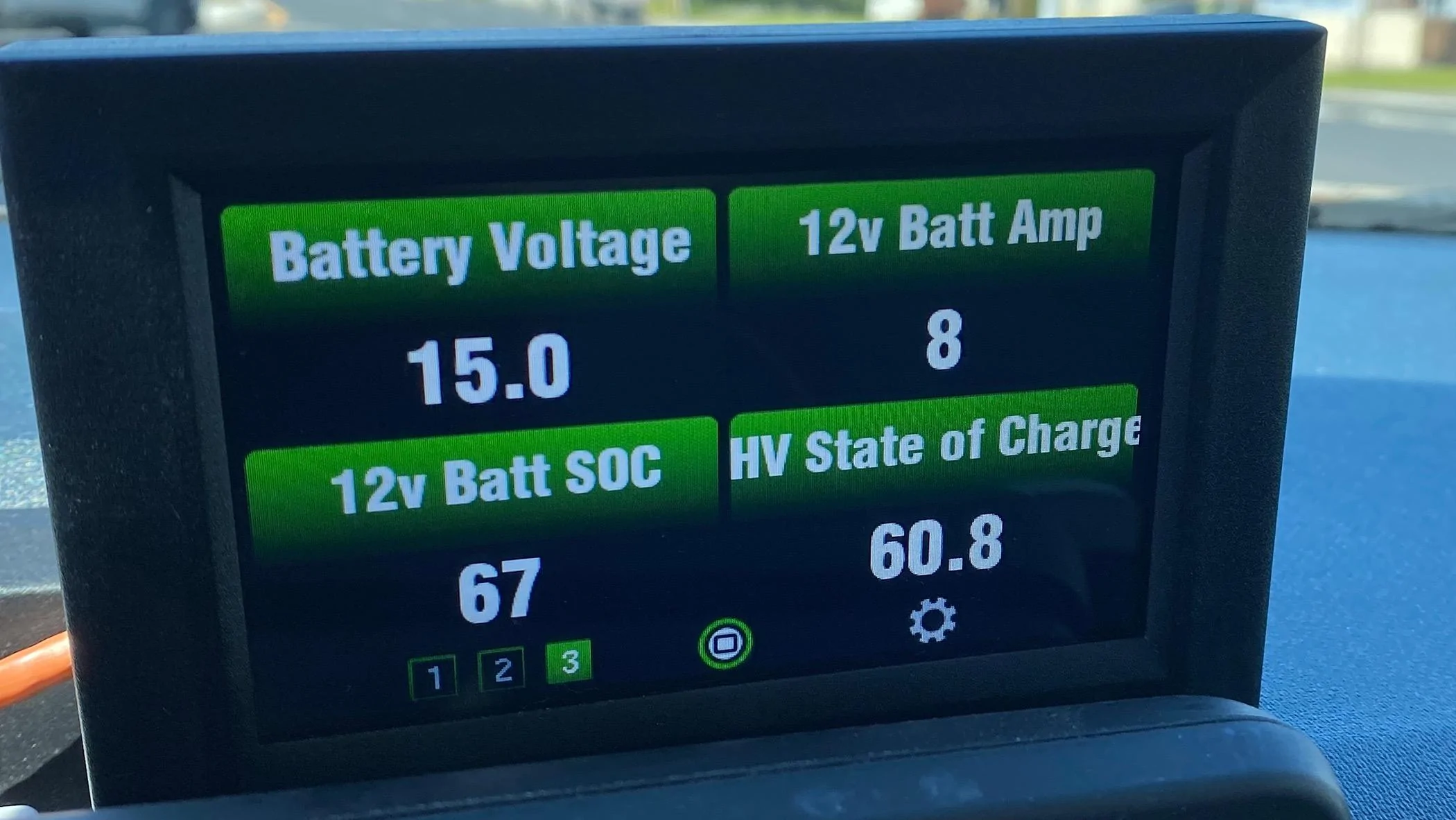

The data logger does not log direction of flow, which is annoying but it was only a few bucks.
Shown here is "charging" amps going in which matches the more expensive scan gauge nicely. The scan gauge will show negative numbers for discharge and positive for charge.
Your data logger may not pull enough to amount to squat directly but anything it does pull will
not be seen by the factory bms since it is located between the factory bms and the negative post. Due to warning in manual to not attach anything to negative post I believe that factory bms will interpret the disappearing consumption as reduction of battery capacity and adjust it's recharging. Again this would take some time to accumulate but would be there. The 5 watt draw for 90 minutes will be something active on the 12v buss (power point circuit) which keeps active for the set time delay (90 minute default) OR until 12v battery drops to 12.0-12.1 (I don't remember which). Change the time out period or turn off /remove whatever is on circuit. This will help also but is not the total answer. Also I do not believe this will turn off the power point delay early but does turn off the courtesy light, radio, dash, etc early, is to double lock (phone push key fob or outside door handle area twice) your truck.
