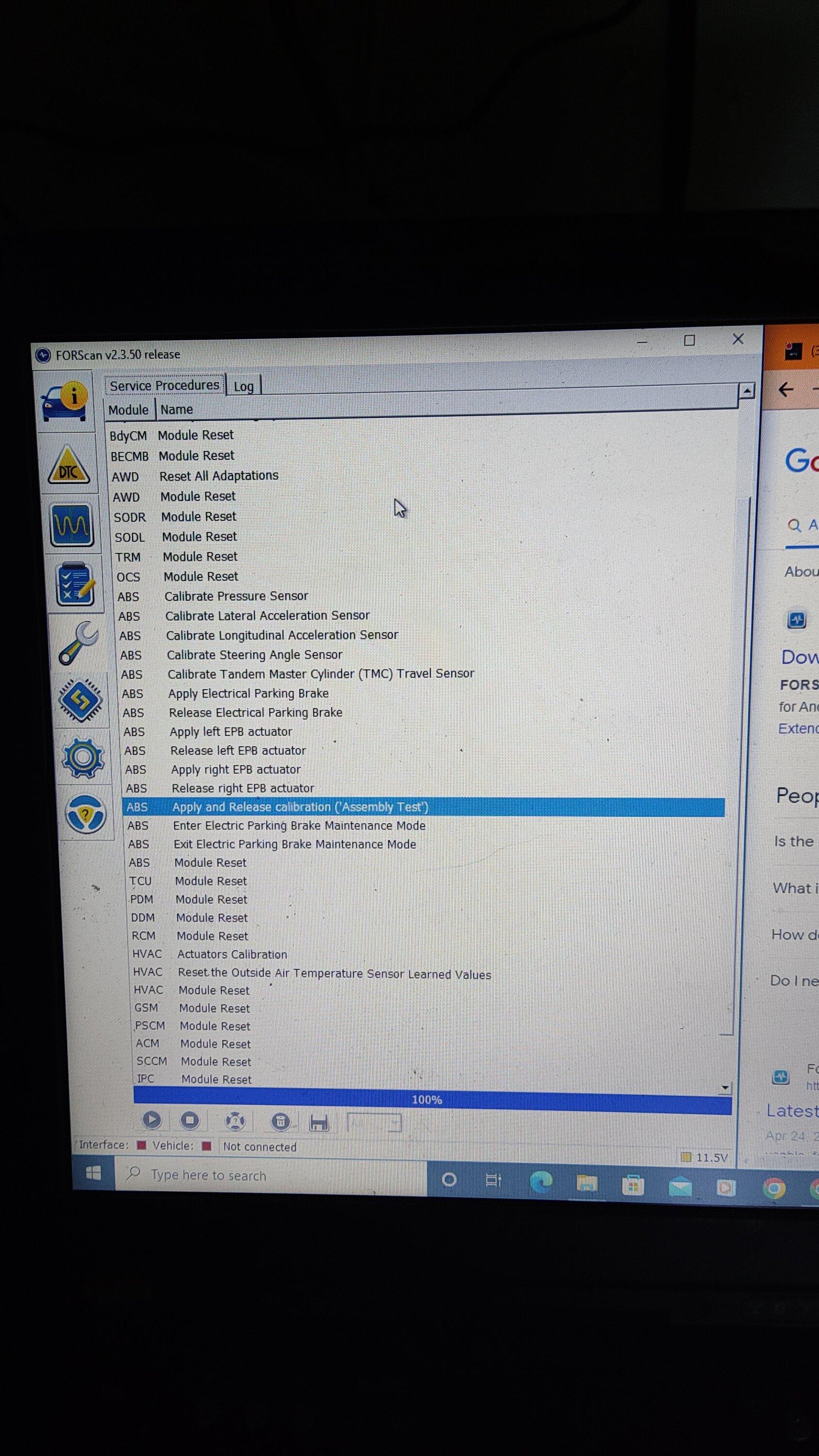

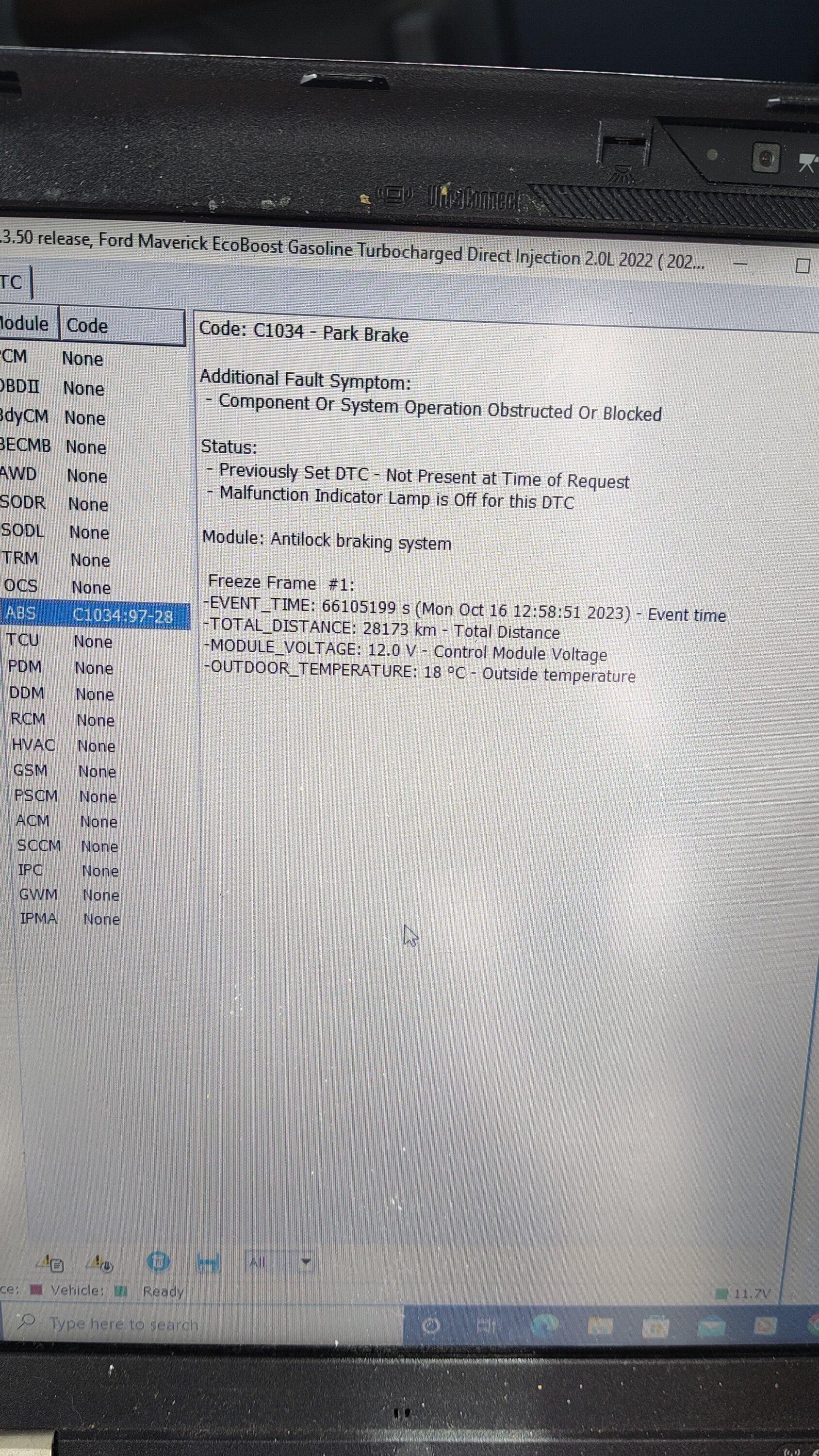

Update. Forscan brake service modes don't work. Only modes that work are
-Assembly test (only does it once though
- release parking brake
- engage parking brake
All the rest fail and give me an error code

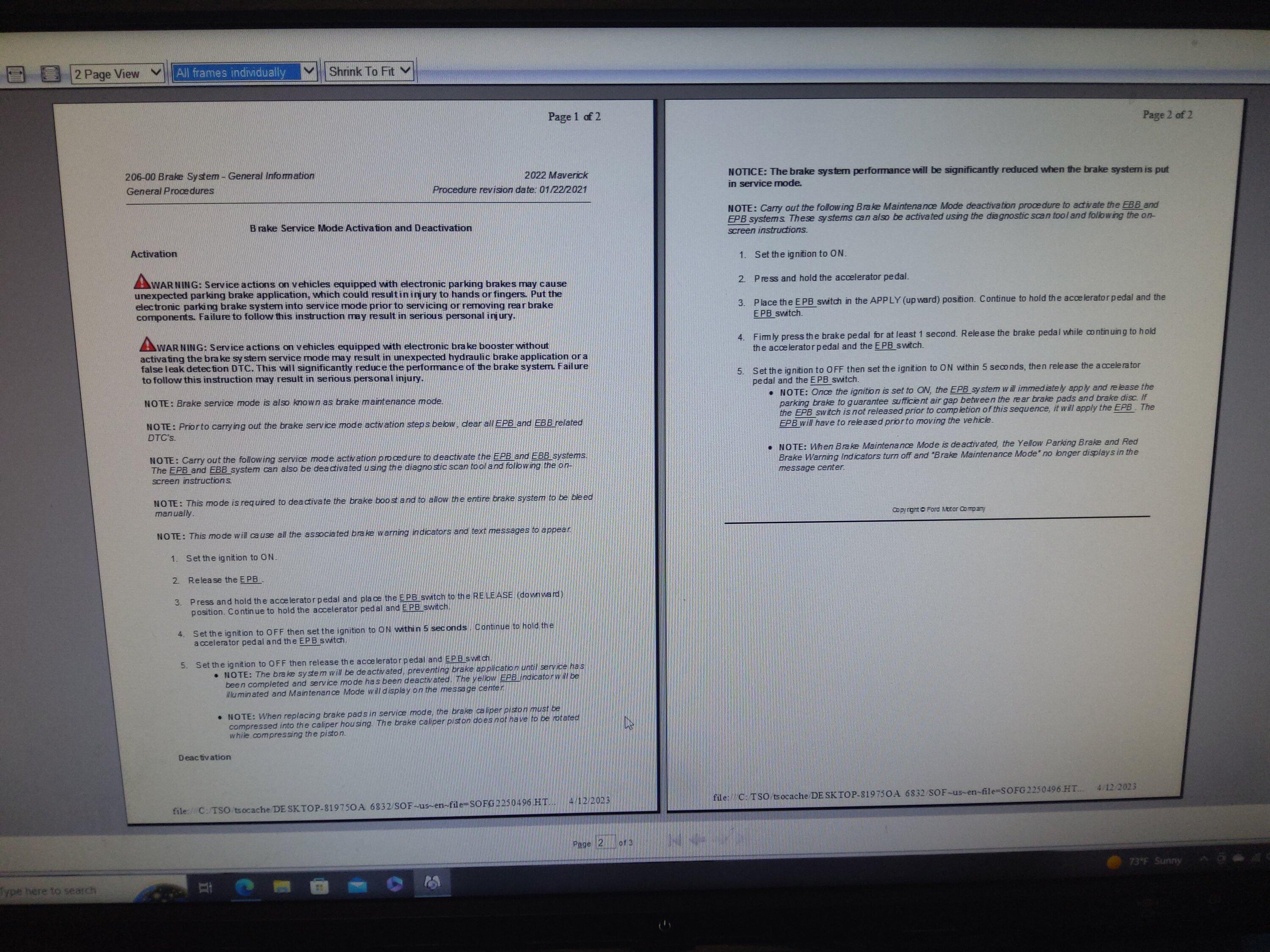

It has been confirmed that ForScan does not work.
Only way to do it is through FDRS and FORD knows it. They don't care. We may be the 1% that actually still change out own brake pads...
It is a service bulletin, but it will never go any farther than that. Too much profit for them to actually allow people to do their own maintenance.
Overall this is the only issue I've had with my Maverick, but it's a pretty big one. I'm not paying someone to service my own brakes. It was $120 for the rears because of this issue and I provided the pads. Ridiculous.
