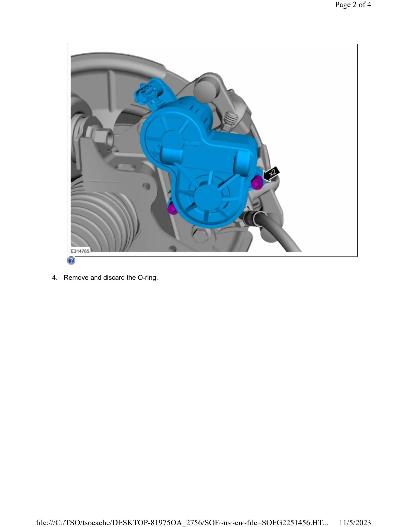

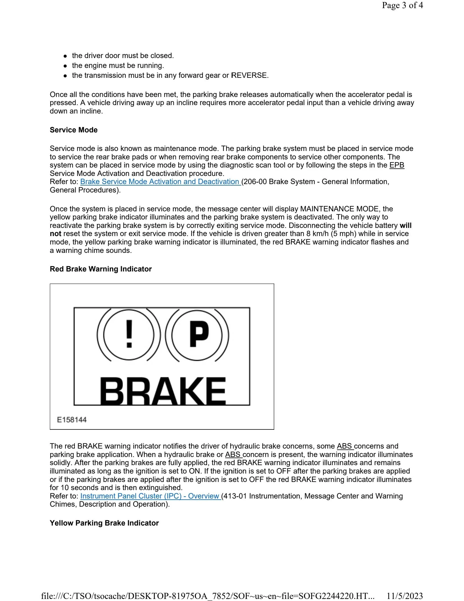

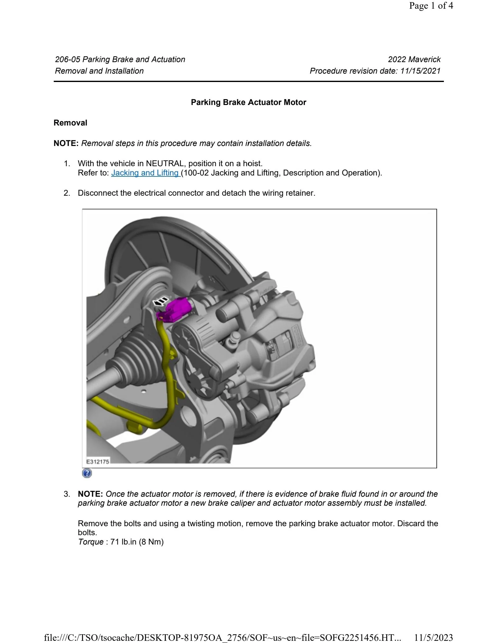

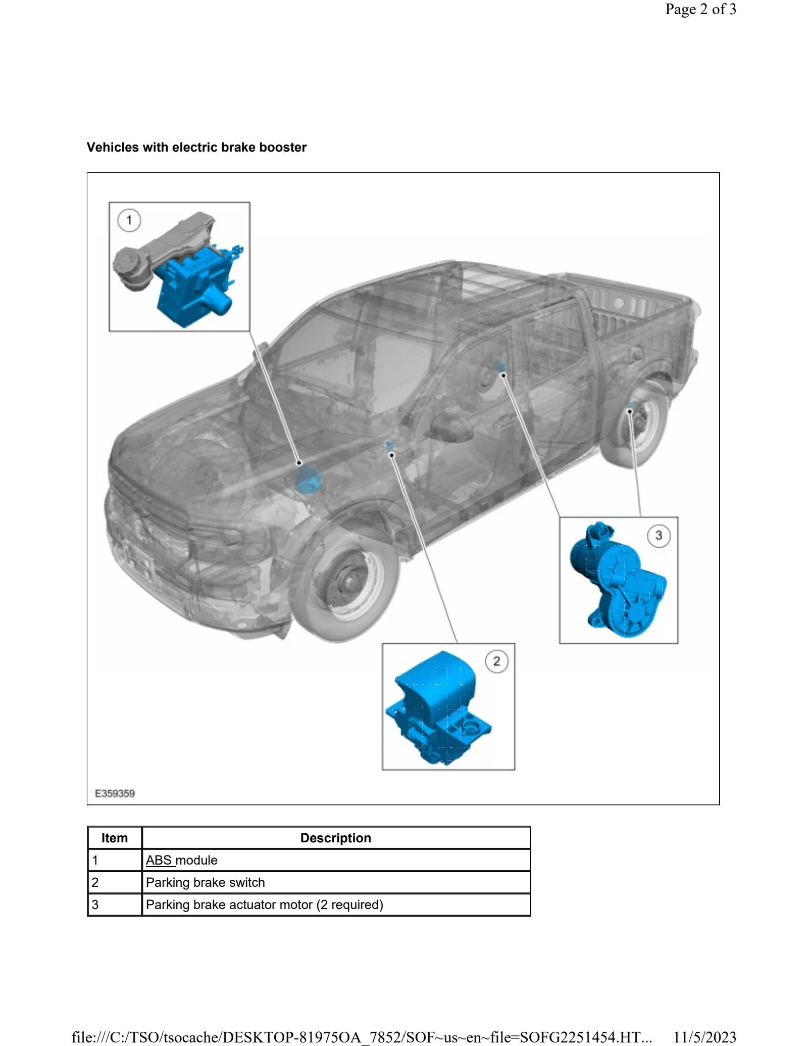

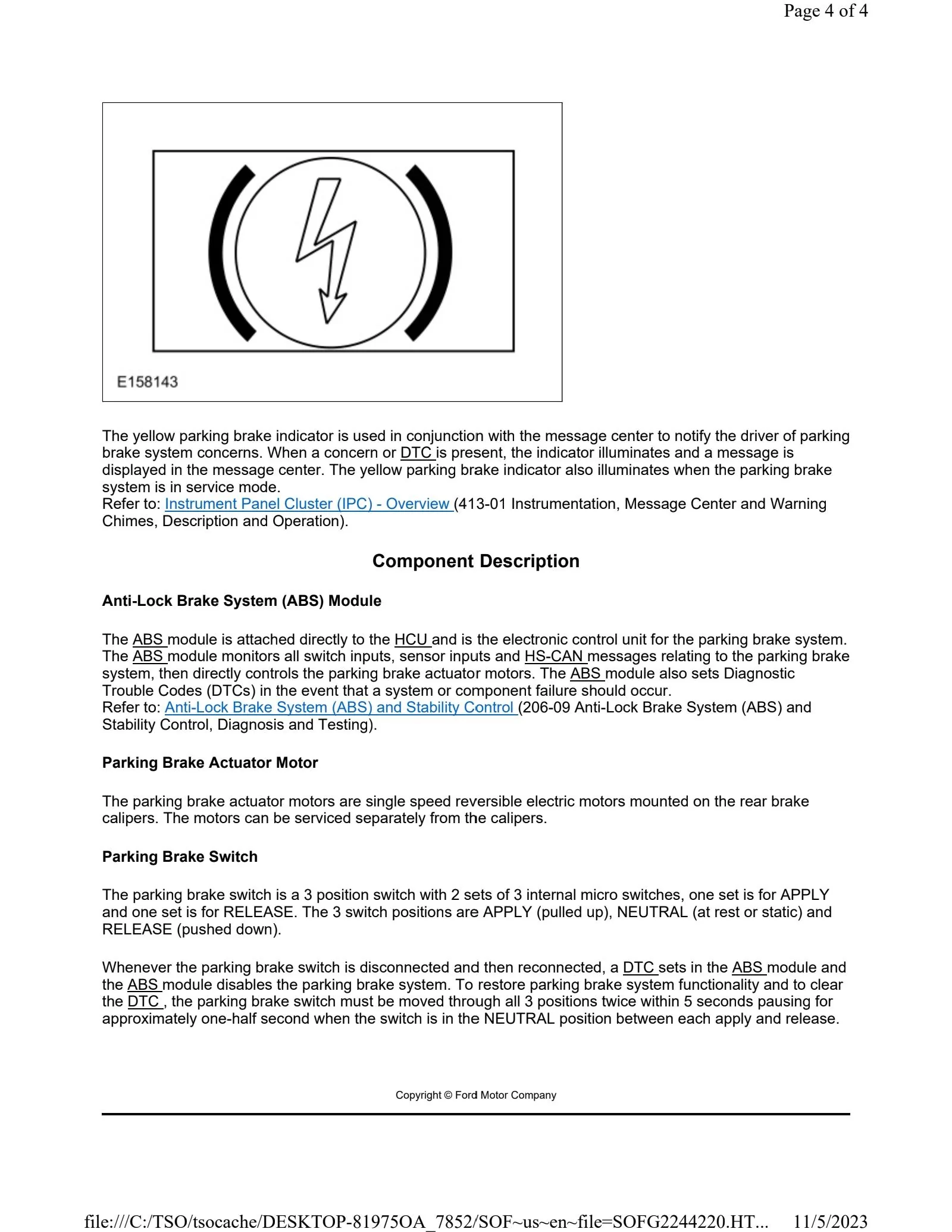

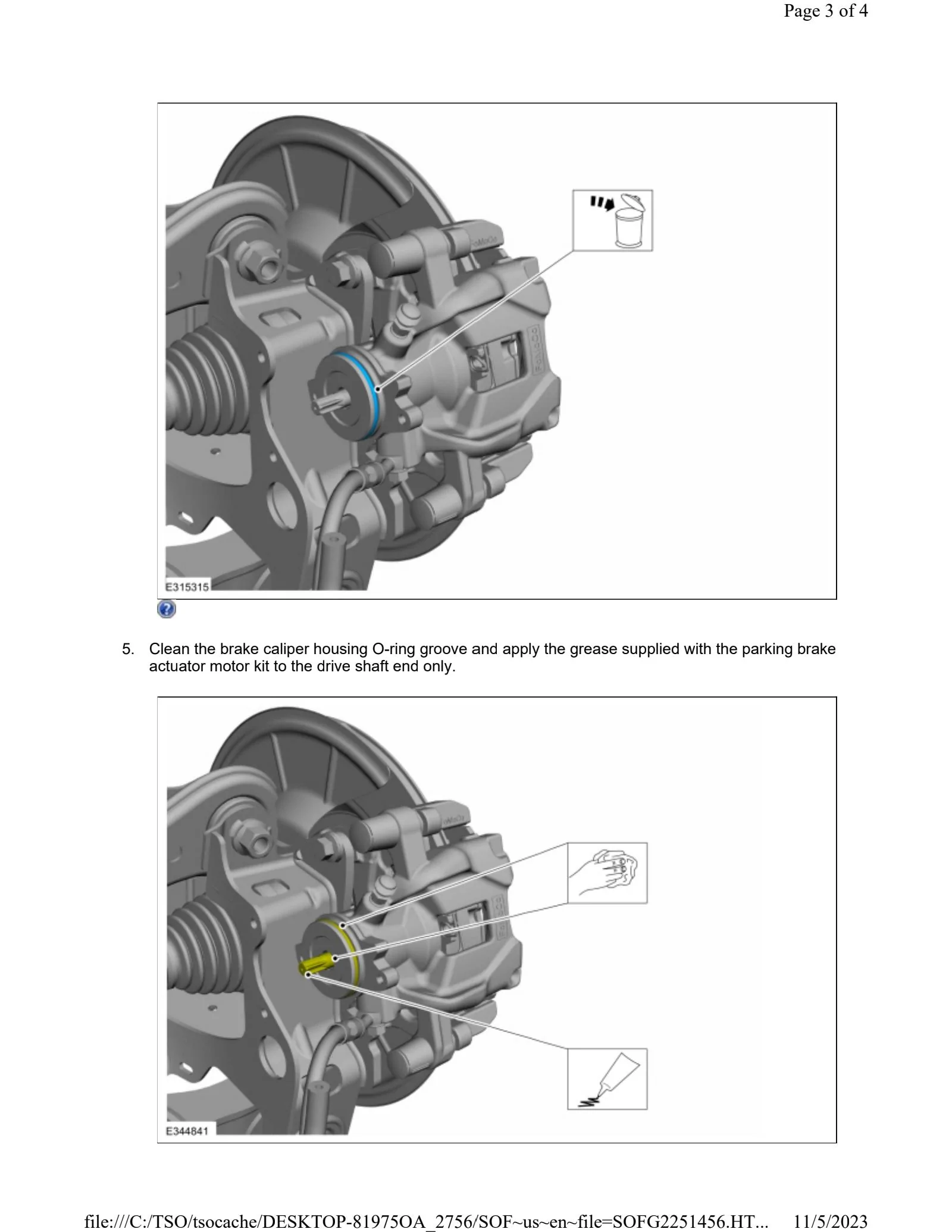

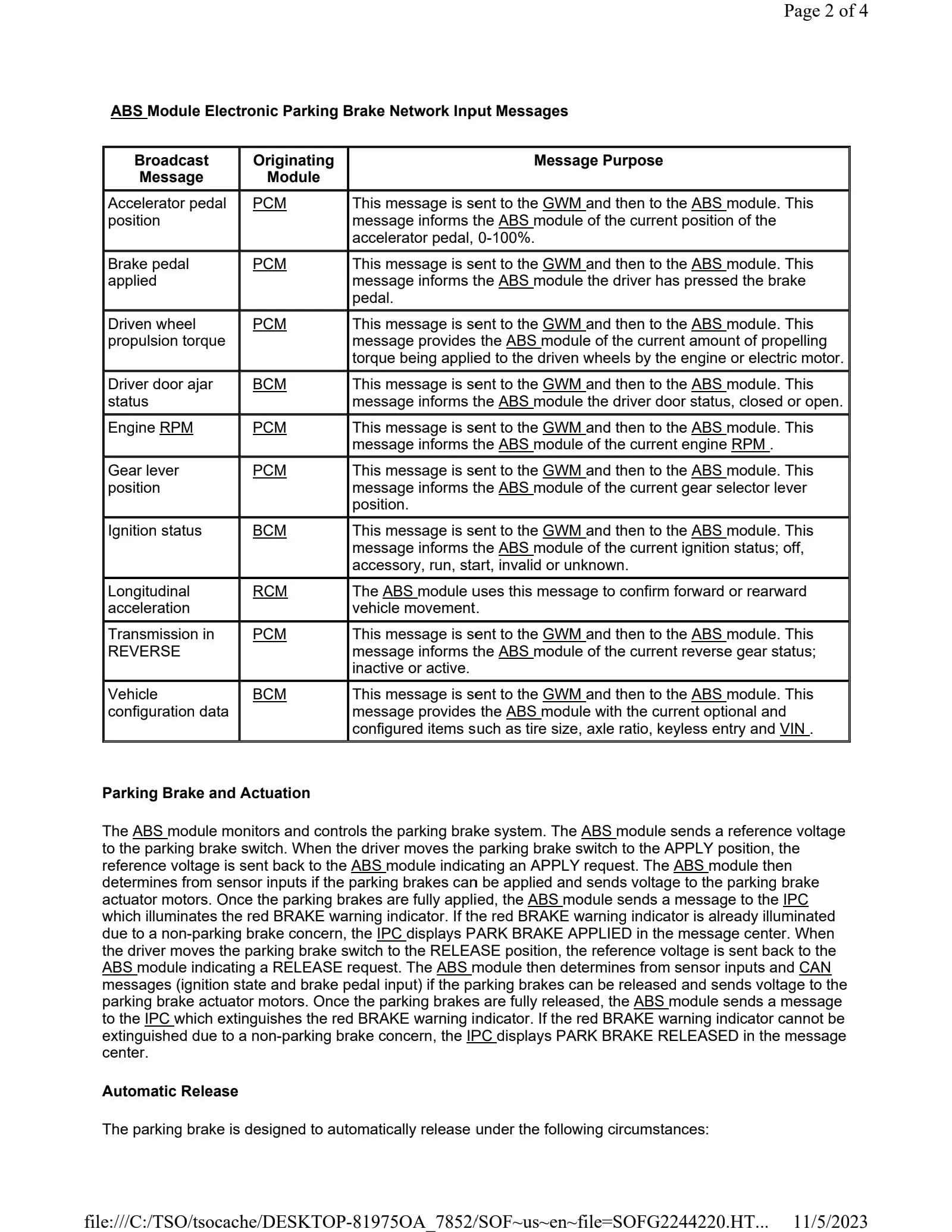

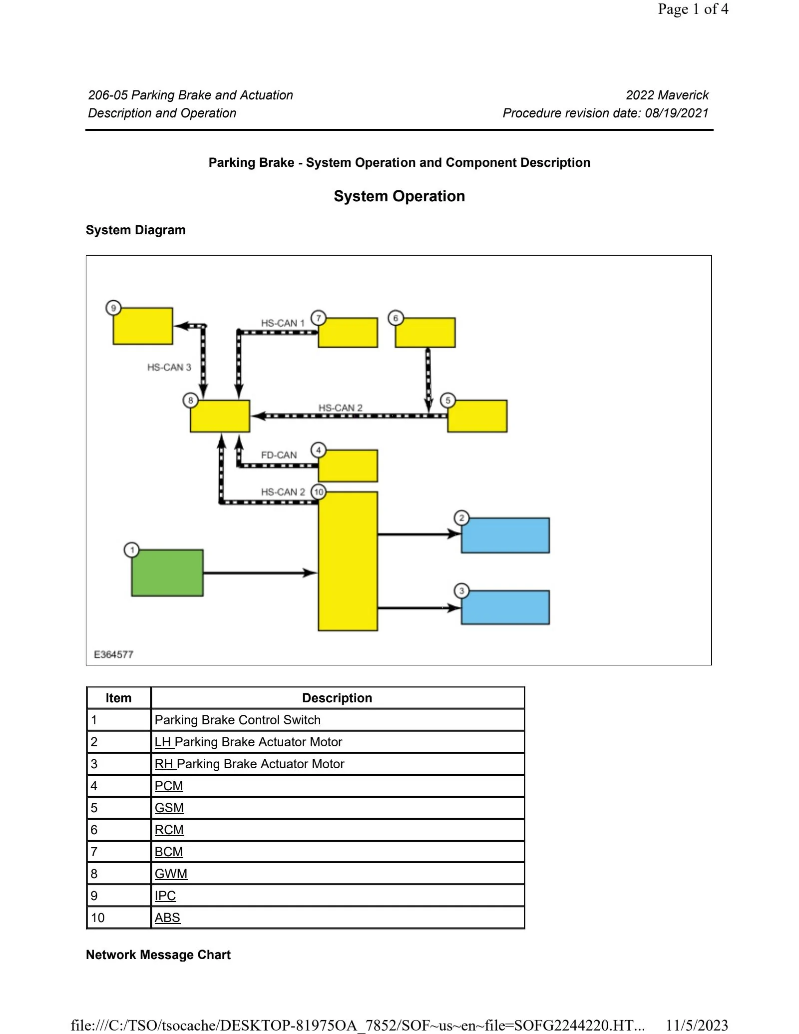

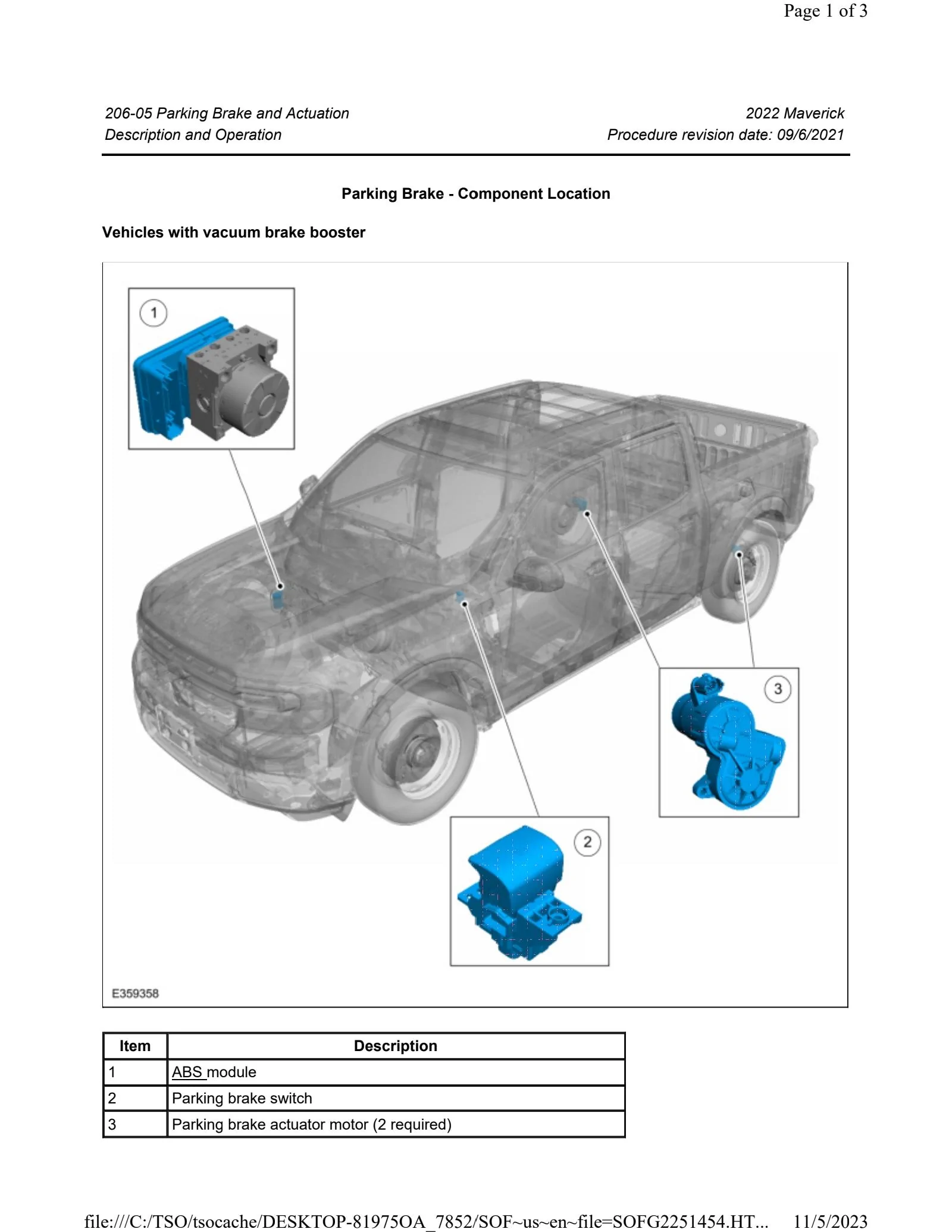

My assumptions on how the system works based on the below TM excerpts:
1. Switch tells ECU Park brake is commanded
2. ECU checks permissive list, if all good it sends command to the actuators
3. Actuators turn driving piston inward to a pre-set torque limit. Current draw monitored by ECU watching for faults.
4. When commanded off the actuator reverses a few turns past zero torque, this way it is ready to go for the next command. Over ti e as the pads wear the piston winds up sitting proud of the bore just like the normal brake pistons do - hence the need for service mode.
5. Service mode would drive the actuators in reverse until torque limit is hit, placing the piston within its bore.
Thoughts?

So, in a nutshell, service mode simply retracts the pistons all the way and most likely prevents any input like hitting the brake or park brake switch from doing anything?
I've done rear brakes on a Lexus with elect park brakes and the way to do it is remove the actuator and turn the pin to retract the pistons. This is because an exspensive scan tool is needed to retract the pistons.

I believe you are on it @Silver23 , seems the most logical to me with the information we have.

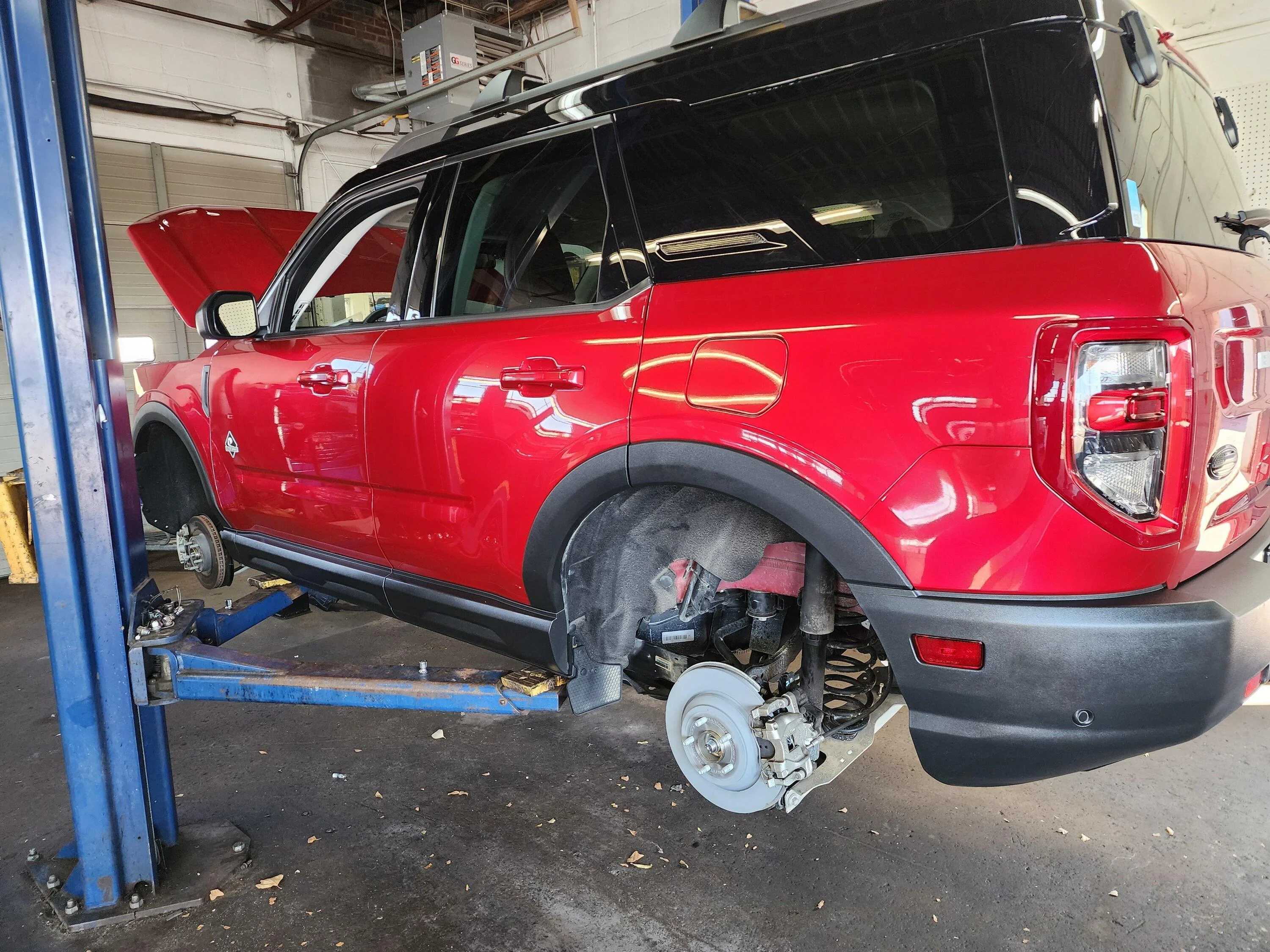

Still here. On the shop working on it as you can see i did the rear brakes.
