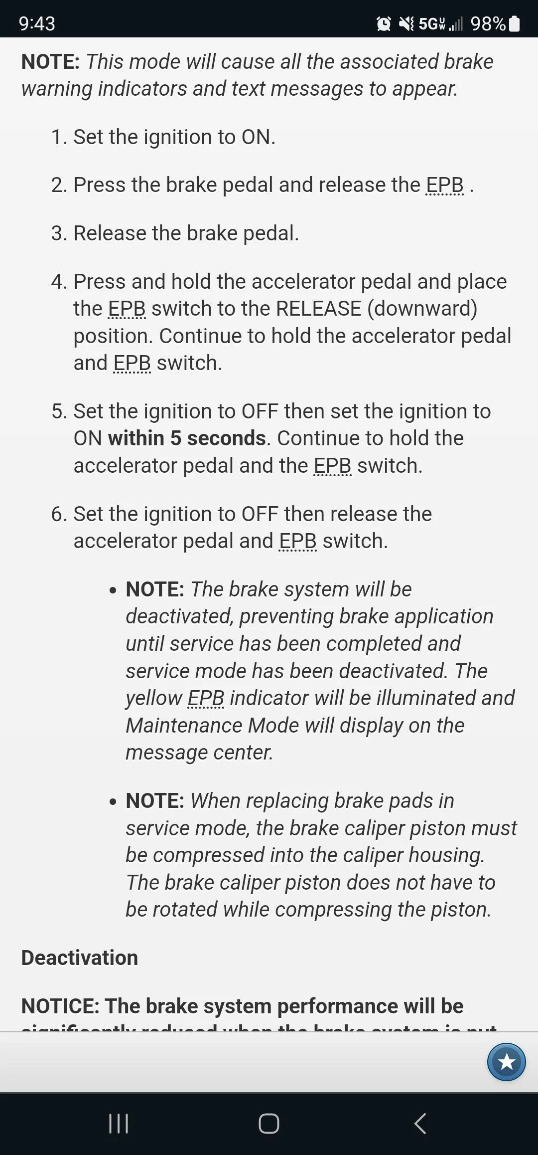

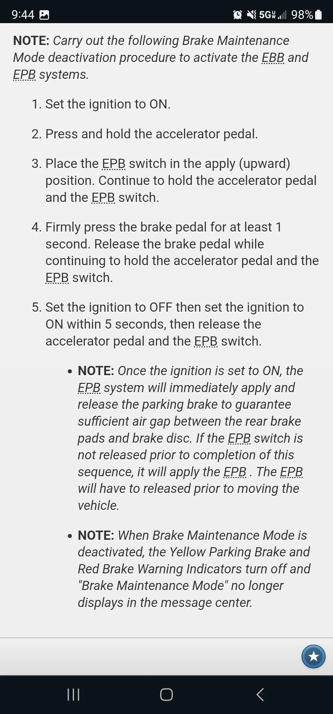

Activation 1st picture / Deactivation its Second Picture thats the procedure to put parking brake service mode. If you want me to post a video i will when i get home. This its from Ford.
