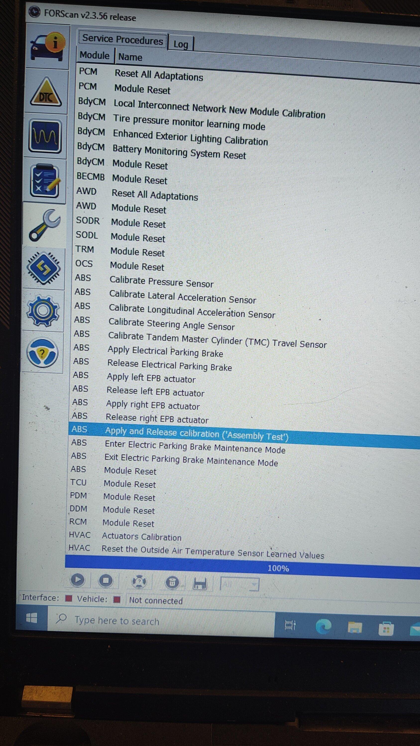

Your help greatly appreciated. We will pull wheels and have a look. Everything I've read even in this thread seems to indicate that you can't just do pads and rotors in the back, some tooling and the computer is necessary?
LC48
Oct 24, 2021
456
676
Johnson County Texas
Maverick XLT, AWD, Carbonized Gray. Highlander Lim
I see no special tools for the back, or front. Service mode not being required in the front unless you have an electronic booster, yet required in the rear regardless is a head scratcher - my deduction is this is related to the electric parking brake. Time comes I will disconnect the servo and go to work.
