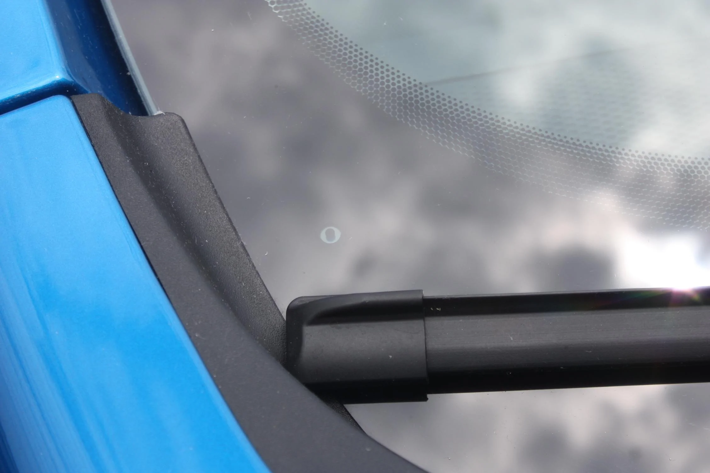

Nice to know about the wipers parked at the dots in the glass.

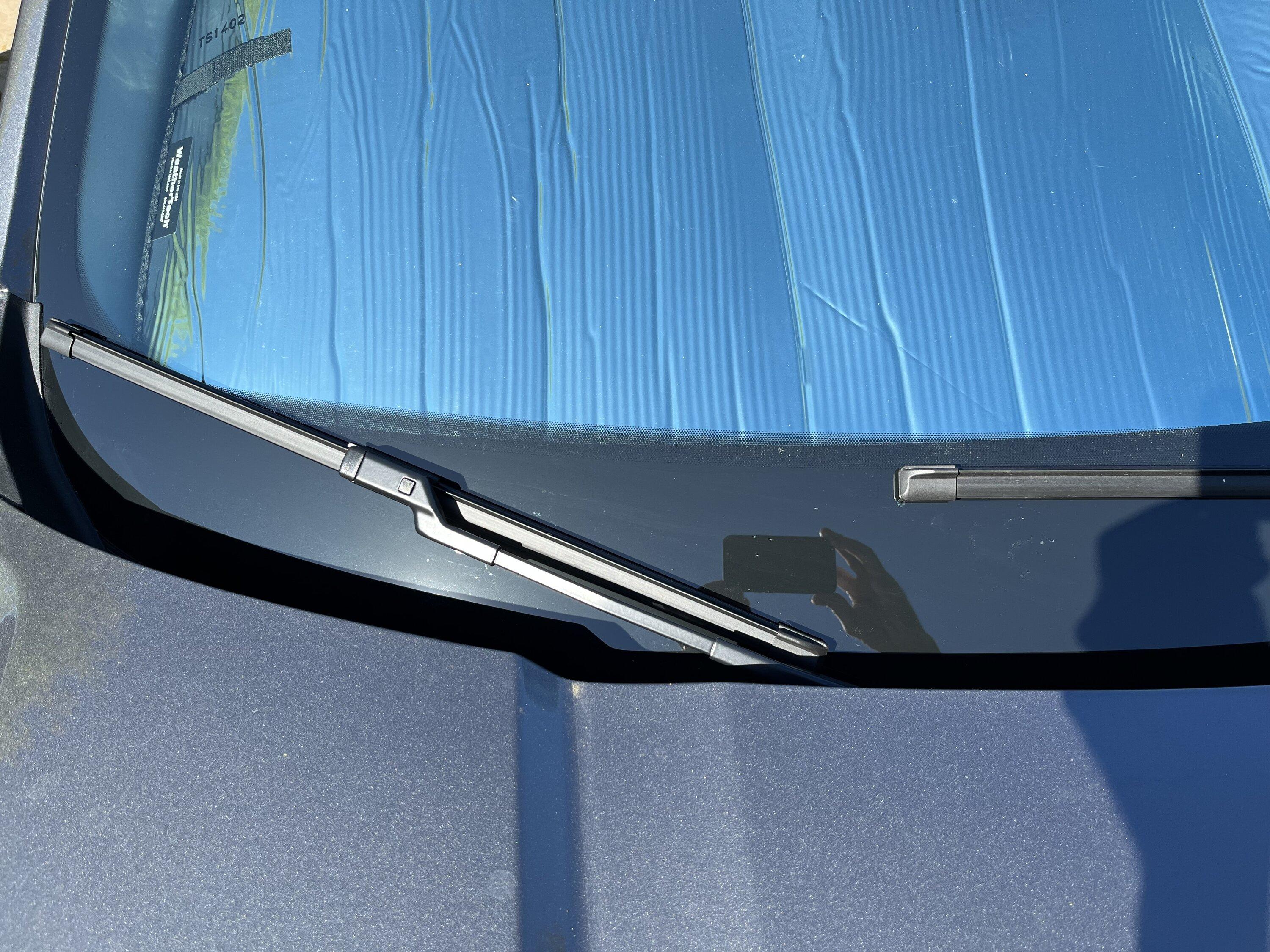

Has anyone fixed or had a dealer fix their wipers being high? Mind tried to retract into snow and now seems off positionally.
Good morning! I can look into this for you. Feel free to send over a private message including your VIN and dealership information at your earliest convenience.

Mine is too high. Not sure how to fix it.

Mine are just like yours , I am going to change out the pass. One for an 18" blade and I hope that will fix.

Yeah I hadn't even used mine yet and noticed that it sits comically high.
Going to bring it in as a warranty item. No chance my heated wiper bay can help that poor guy way up on the windshield all by itself

With the wipers parked it should be stopping with the blade right on top of this mark
Just checked mine and it is right on top of this mark.

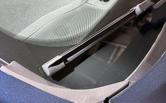

My passenger side was too high, I pulled the wiper arm and readjusted it so it is now perfect.
How hard was it to pull the wiper arm? Could you explain the procedure?
I tried pulling the arm off after removing the plastic cap and nut, but no-go. I ended up getting a wiper puller from the local auto store - but it didn't quite fit over the arm. it was too narrow. Using a wood shim I was able to get it to work and release the arm. Some owners have said they had no problem removing it by hand.

Shut the Mav off. Push them both down. Start and see if they remember the lower position. If the passenger side is any shorter it won't clean the windshield sensor at the top.
