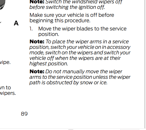

turn the wipers on, let them get to about a straight up position and turn the ignition off. You'll have alot more space to change out the wipers without risking rubbing the paint on the edge of the hood. Also, double up a towel and place on the windshield in the area the wiper arm would hit the windshield for protection from cracking the windshield in case it was to pop down on the glass while your working with them.
