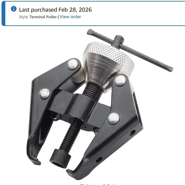

Any luck getting the arms off?
I tried with the tool but was concerned I was applying too much pressure. After reading and some videos a fair amount of pressure is needed. I haven't had a chance to try again but hoping I will tomorrow if not then Tuesday 🤞

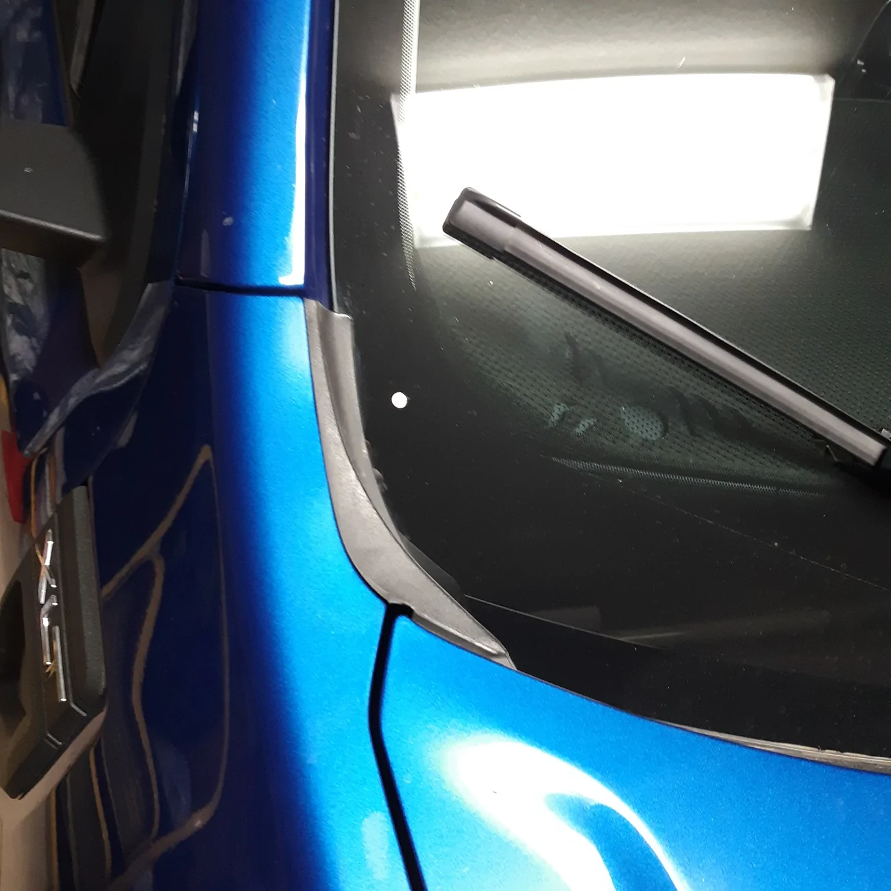

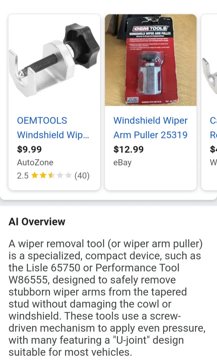

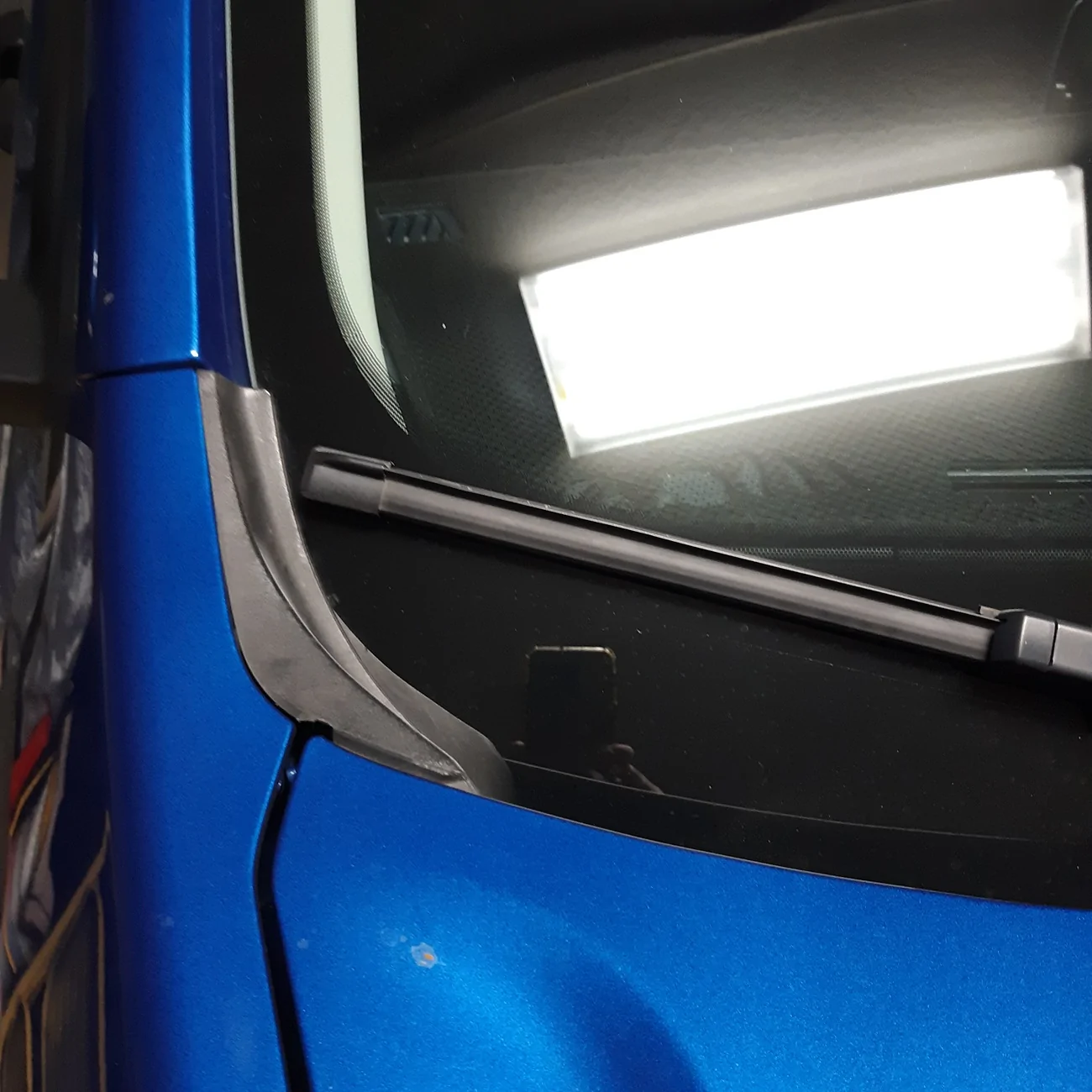

I'm wonder if I'm missing something. I'm trying to remove my wiper arms to reset their home position which I'm guessing was incorrectly set when the windshield was replaced just prior to my purchase. I have removed the cap and nut on both and tried to remove them with mild force and some wiggling but they don't budge. I've applied penetrating spray as well but no luck, so my next step is to buy a removal tool. I just want to confirm I'm not overlooking anything?
Just an update, mission completed! It did require far more force than I expected but they did pop and I was able to adjust them to the proper position. Thank you to all, especially Glen for the very helpful photos 🙏🏼
