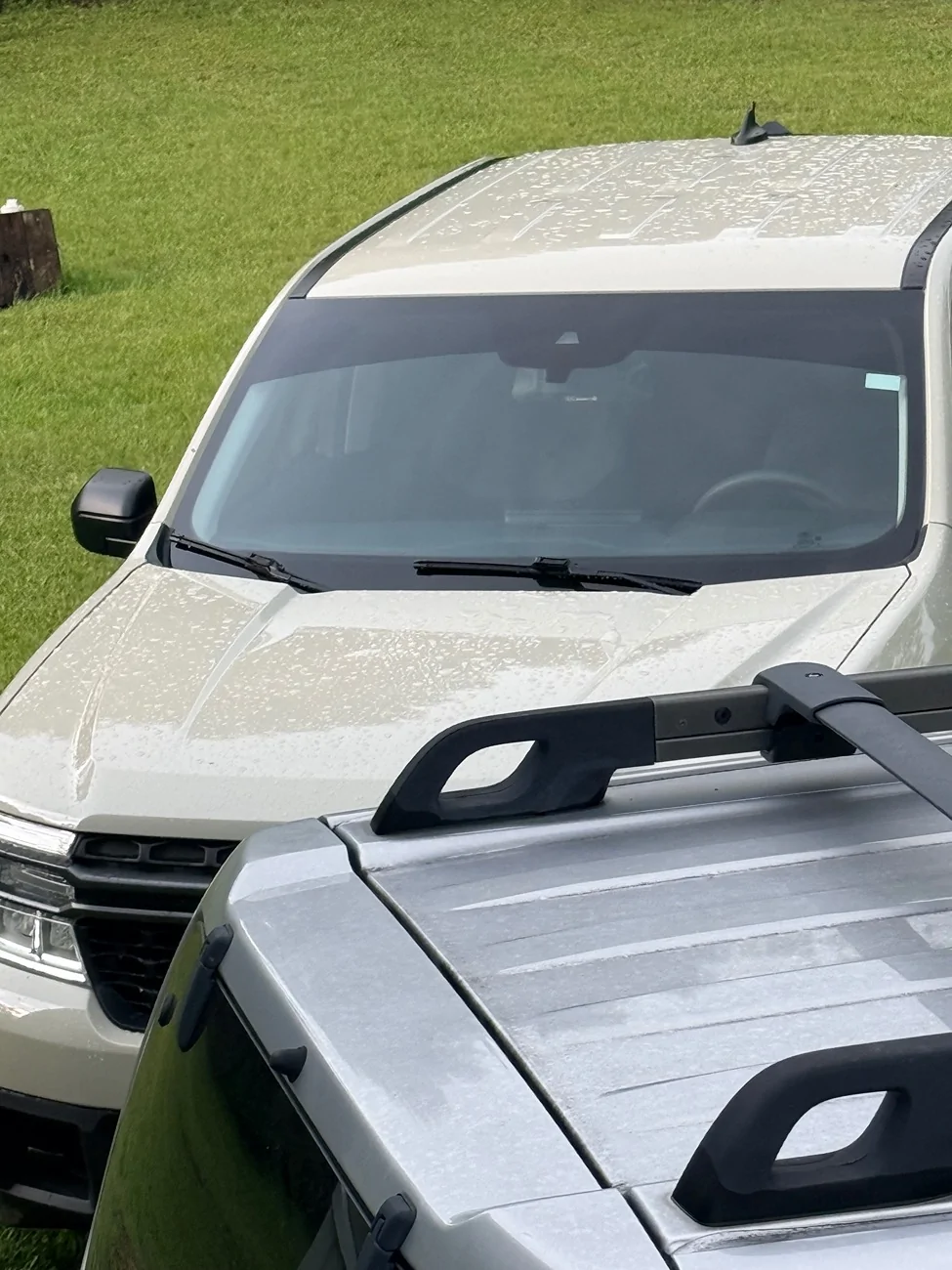

This is how my passenger wiper is in the off position. It's been like that since I got it and the other day I turned off my wipers and it went down several more inch's and stopped. Now it's back to this position. Which correct.

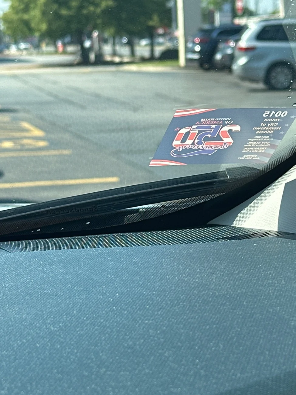

basically where mine does.
Ford Maverick Is this how everybody's passenger wiper rests. IMG_3305

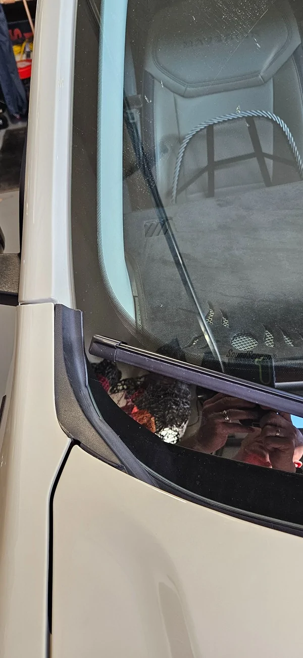

Good day

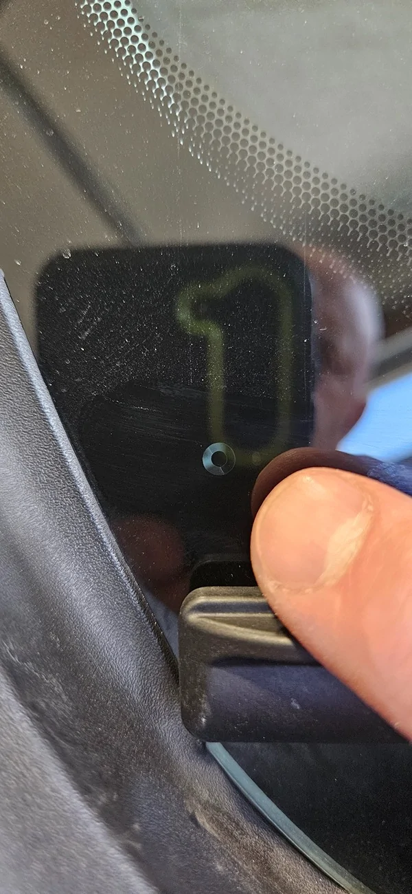

If your windshield is like mine, there is a small mark on the window that indicates where the wiper should rest, when is turned off and returns to its parked position.
Andy
Ford Maverick Is this how everybody's passenger wiper rests. 20260524_185418

I looked closely at your photo, and your wiper seems to be sitting above its parked position...I think that I can see your indication spot below your wiper.
Here is a pic of my wiper in its proper position.
Be careful if you decide to pull your wiper off (to reposition), as I have read here that a special puller is needed!
Cheers,
Andy

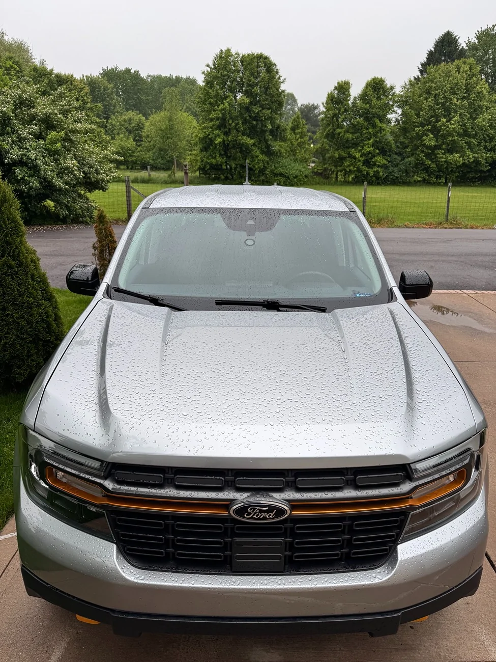

Normal. My passenger wiper also parks in that same position.

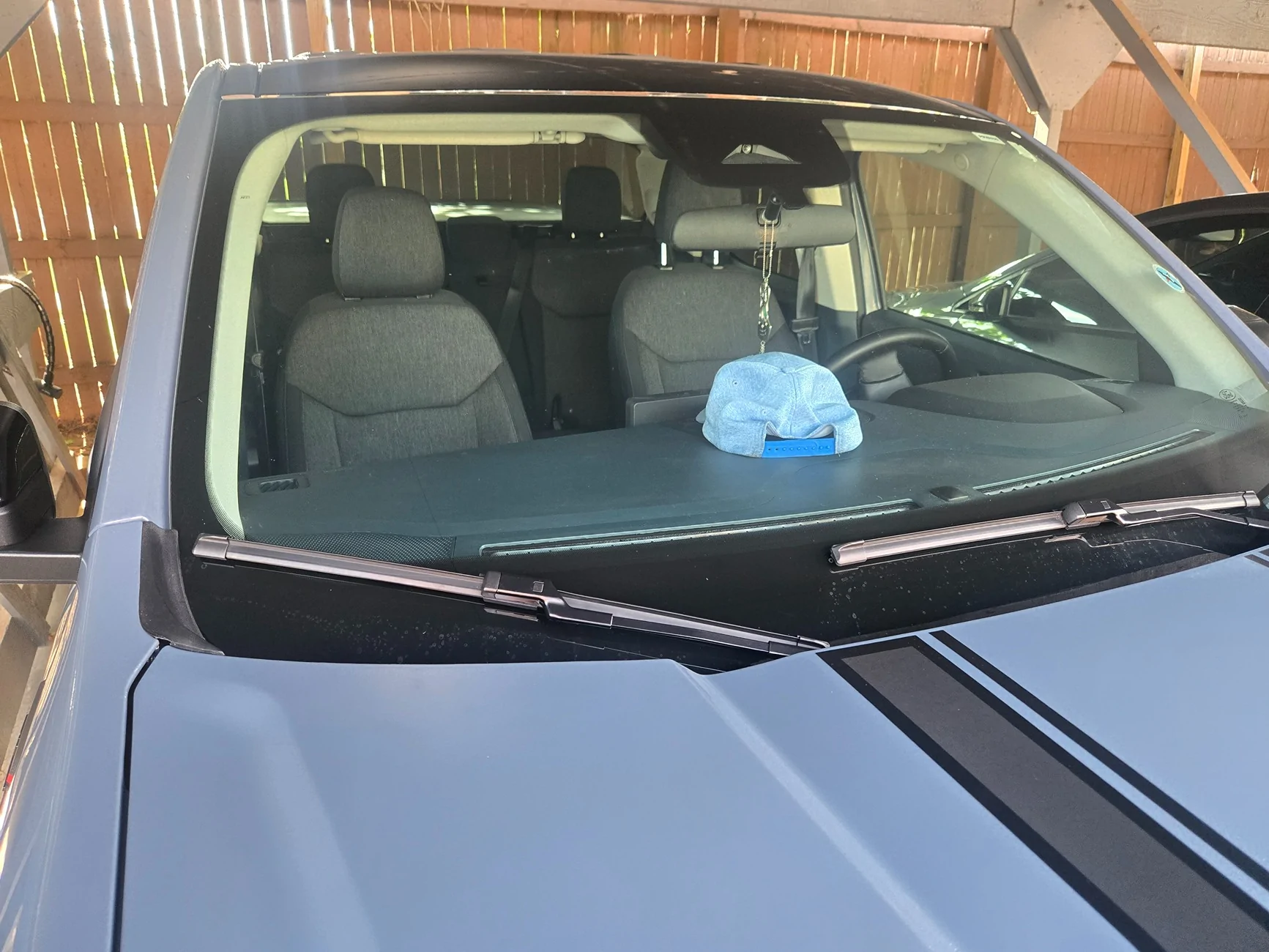

Once in a while it will sit lower after I use them, which I cannot explain, but yeah that’s about the spot they typically sit.

Thanks for the heads up on the circle mark.
I did not know that.
Mine is sitting right on top of that mark.
