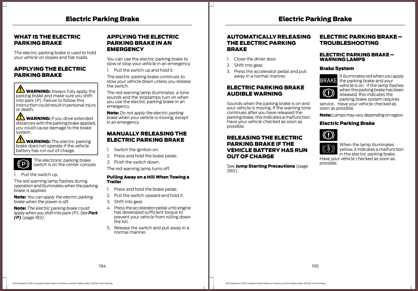

That is only the disclaimer for how to automatically release it. Page 194 refers to the normal, manual release.

Crazy! I find it interesting they put it as a warning though.
I was always under the impression a parking brake was to help prevent accidents like mashing on the gas and rolling forward as part of its features lol.
Never argue with a FORD engineer ;)
I still need to know why. Why FORD... Why?
*Edit
Page 194:
You are not doing it wrong. That's just the disclaimer for the AUTOMATIC release.

Same here except on manual transmission cars. I have used the " emergency brake" more than once to get me to a safe place when I have has a brake line rupture. Can't do that now.
You sure can use the electric parking brake in an emergency. See your manual.
Electric Parking Brake - Applying the Electric Parking Brake in an Emergency
APPLYING THE ELECTRIC PARKING BRAKE IN AN EMERGENCY
You can use the electric parking brake to slow or stop your vehicle in an emergency.
Pull the switch up and hold it.
The red warning lamp illuminates, a tone sounds and the stoplamps turn on when you use the electric parking brake in an emergency.
The electric parking brake continues to slow your vehicle down unless you release the switch.
Note: Do not apply the electric parking brake when your vehicle is moving, except in an emergency. If you repeatedly use the electric parking brake to slow or stop your vehicle, you could cause damage to the brake system.

All that means according to manual is when the parking brake is engaged, you need to start the truck, put it into gear and it automatically releases when you hit the gas.
