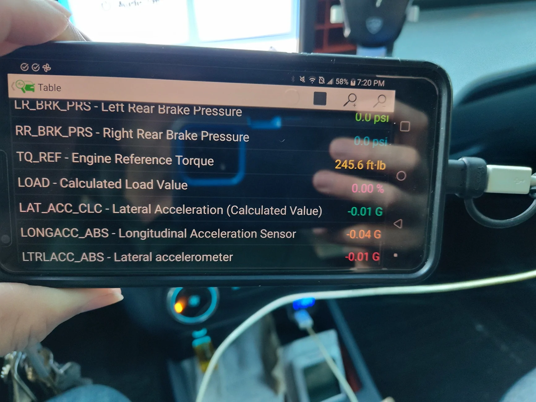

There is an easy way to test if the calibration on the accelerometer sensor is correct.
Notice a barely there slope where the Hill Assist does engage to give you that 3 seconds before brake release.
Turn truck around - still an assist going the other direction?
Because if the calibration is off - it'll sense enough slope pointing nose down say to provide it going in reverse, but not nose up in drive.
If it does it both directions - calibration should be good enough if the EPB is going to be auto-engaged.
Or use Forscan Lite. Confirm level is level.
Ford Maverick Parking brake IMG_20250902_192054282_HDR
