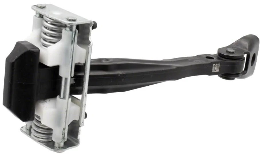

Greetings all. I have a sharp “clicking” in my driver’s door when I fully extend it when opening. No noise when it closes. I’ve tried silicone lube spray on the hinges to no avail. It only occurs during the hot months (May-September here in Texas). Any other ideas or suggestions? Thanks!

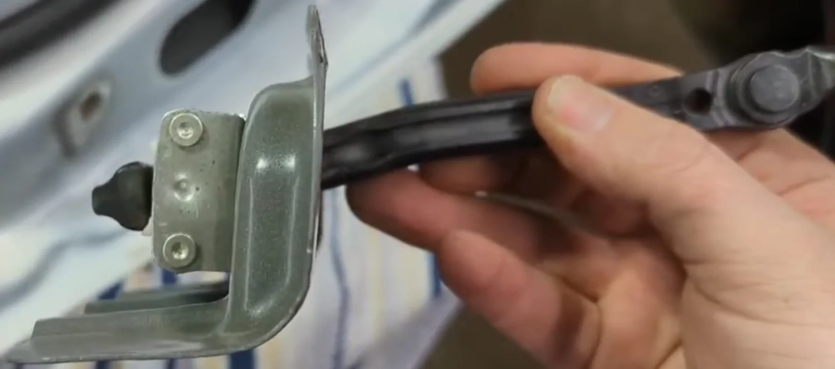

It's not the welds failing. The welds are holding. It is the metal on the door shell that is too thin and failing. Literally ripping around the welds.

It's the weld/sheet metal that has broken. It's not a loose bolt.

Spot welds failing. Rewelded mine but the metal is too thin I’m sure it is just a matter of time before these fail also. Was always careful opening and never had wind catch it. It’s just not heavy enough material for the stress over time.
