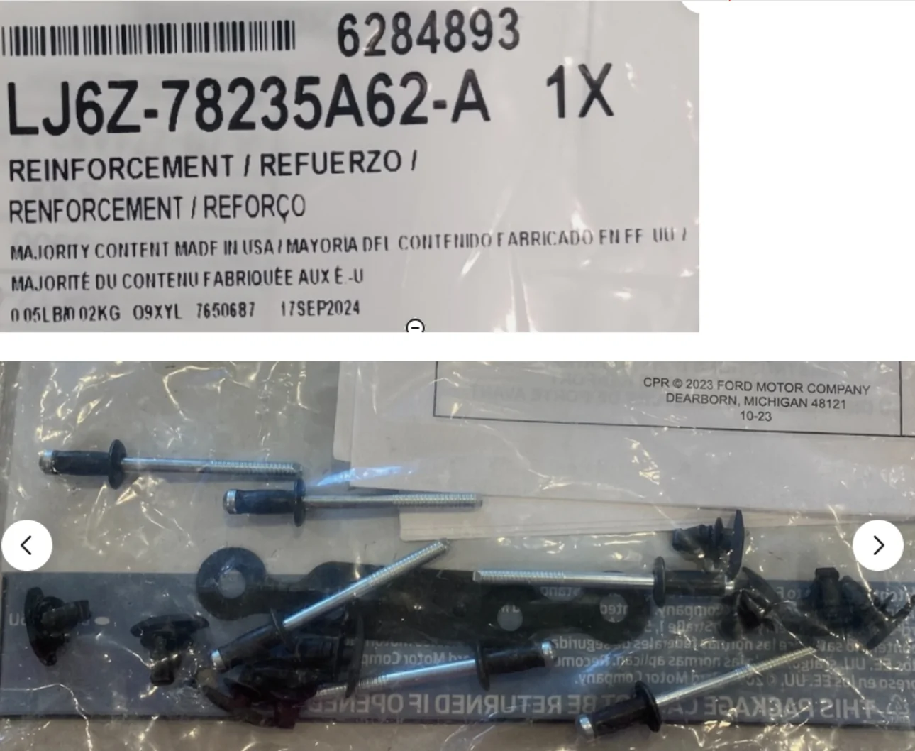

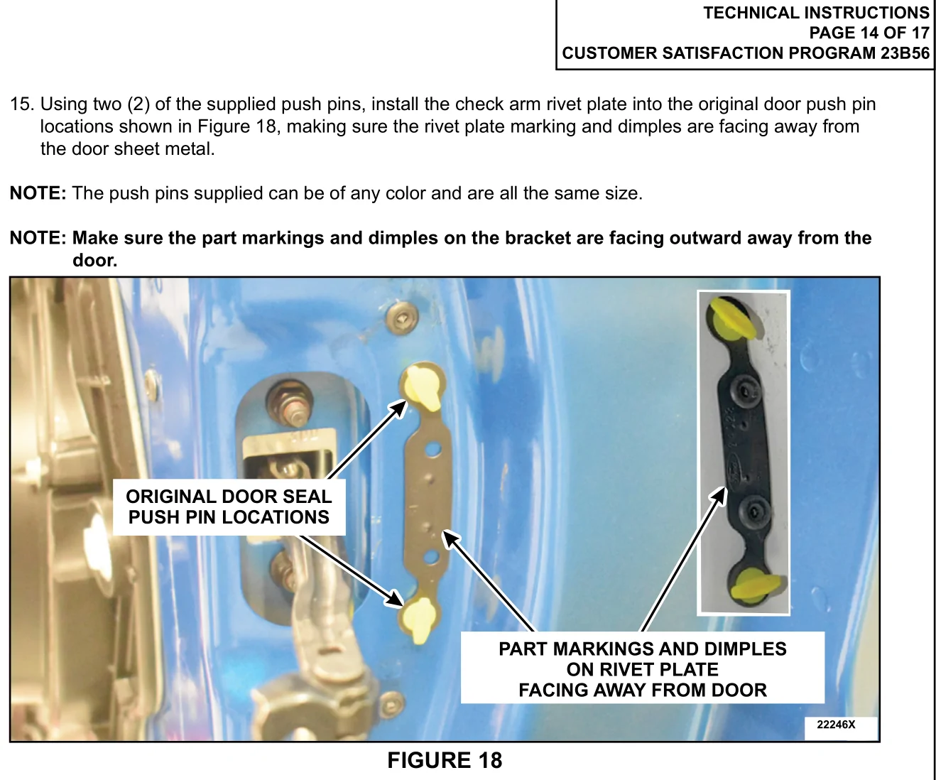

My Escape doors are heavier feeling than the Maverick's doors.
The doors at the check arm looked similar.
On Escape doors if Ford doesn't replace the door on CSP 23B56, they install a $8 reinforcement kit that is pop rivets and a small plate.
