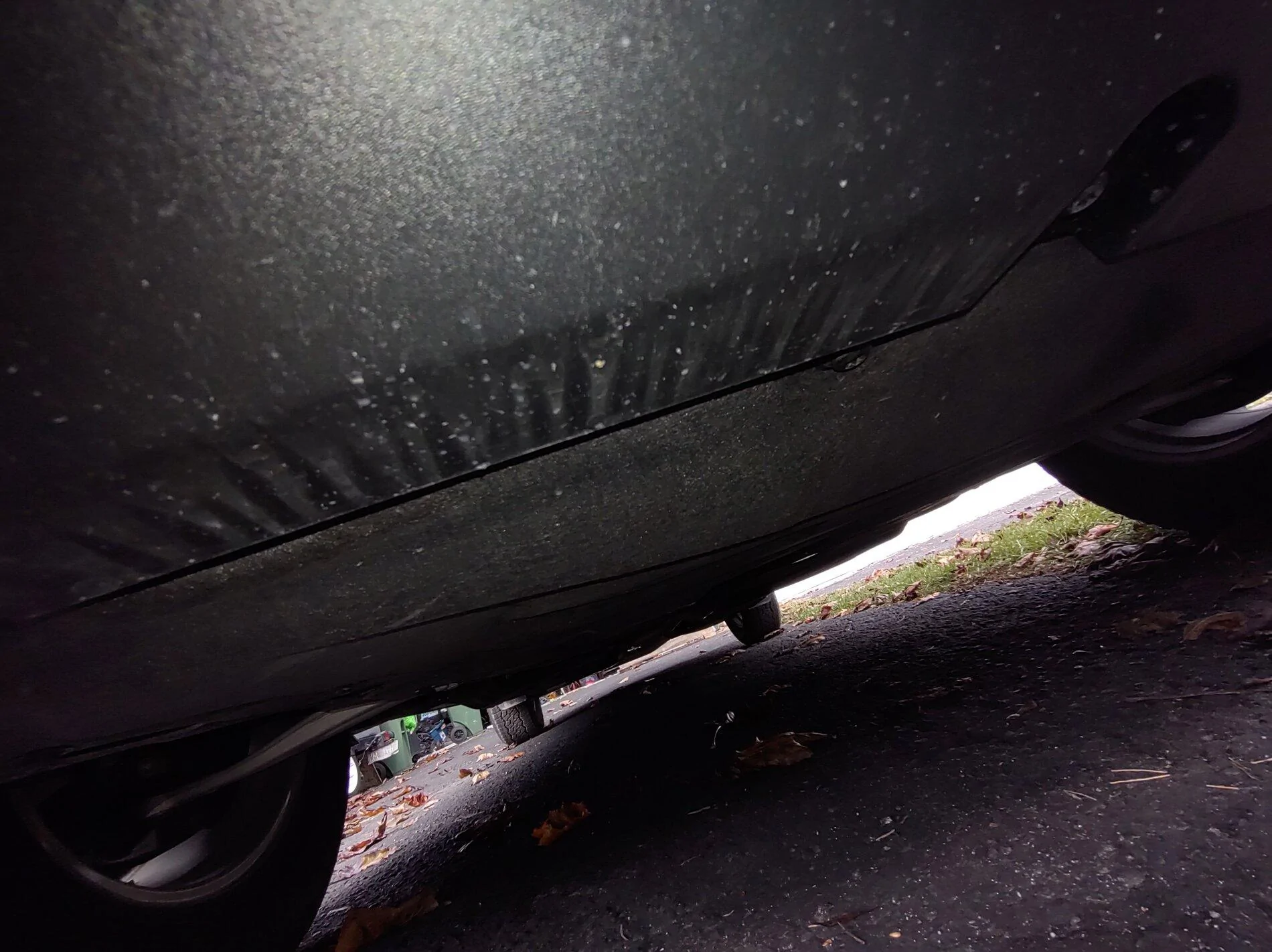

it is not very heavy and dont know how access panel will work but only took a minuet to remove with a power driver
Wife’s past Fusion had a drive train cover with access panels. 1 screw time remove. Easy to make some ABS panels. Will decide on first oil change.

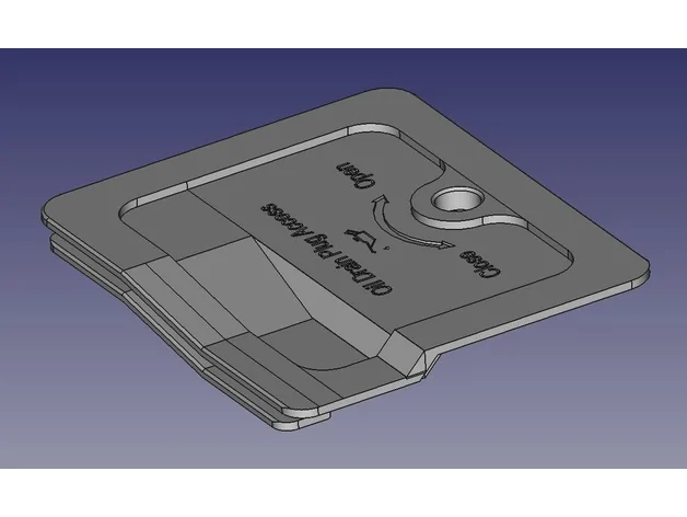

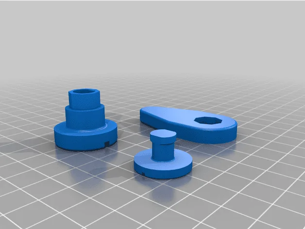

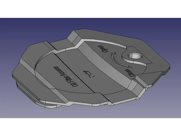

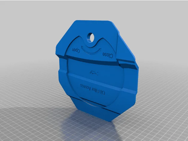

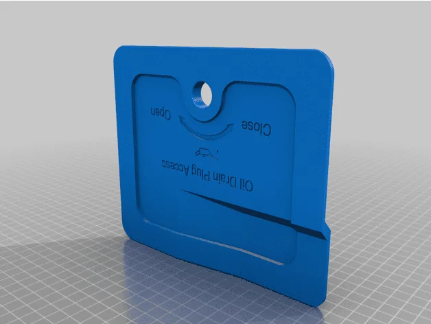

I can see myself making an access panel for oil changes instead of removing entire thing.
Get somebody with a 3D printer to make you these out of PETG high temp plastic. Mod your under cover, and install them. They are on thingiverse. My 4K has a plastic scoop where the oil drain cover would go, so I cant use it. I think the plastic scoop is to put more airflow on the turbo to try to cool it.
