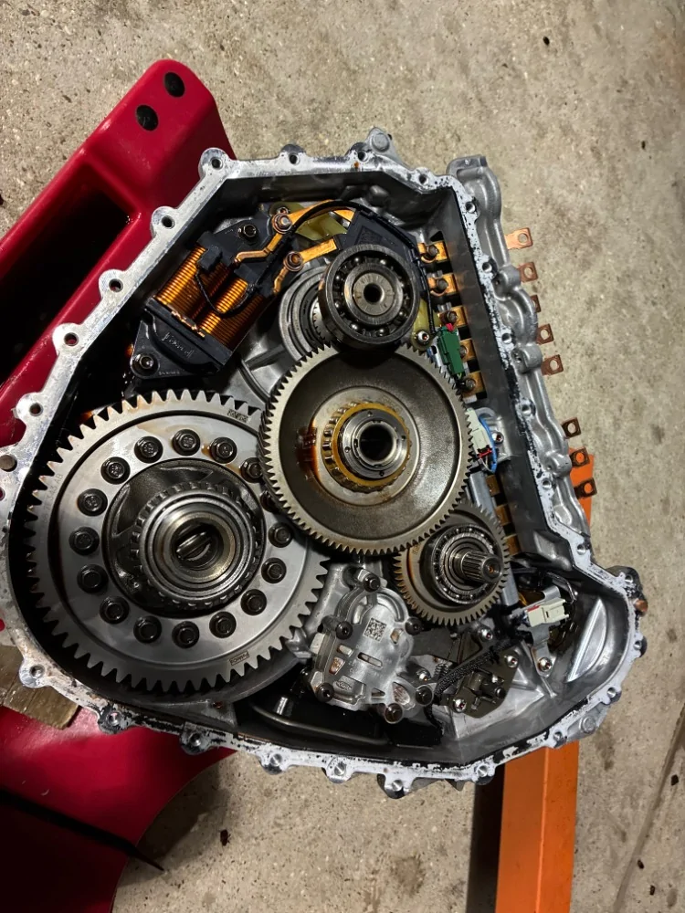

A picture of the tranny on the ground would be interesting. You’re going into a repair area that is mysterious and frightening for me.

Here you go. Very similar to the HF35 from the Fusion.
The large gear in the middle is the top gear on the transfer shaft. The shaft consist of three gears and ties all of the inputs/outputs together.
The shaft at the top of the photo is the input from the electric drive motor. It connects to the top gear on the transfer shaft.
The large gear on the bottom left is the differential that send power to the wheels. It connects to the bottom gear of the transfer shaft.
The smaller gear on the bottom right is the gas engine input, parking mechanism, as well as the starter motor. It connects to the middle gear on the transfer shaft. This is where my issue lies. The middle gear on the transfer shaft is spinning freely (loudly). Not sure if it is splined to the shaft or just press fit, but either way it's not any longer. This explains why I was able to move the truck under electric power, but all hell would break loose as soon as the gas engine would start to drive the truck. Oddly enough none of the gears show any wear or damage.
I'm in the process of double checking all of the bearings. Pulled the sun/plant gears out yesterday and they look fine. This necessated the removal of the starter motor. Those permanent magnets are strong! Ended up pulling the stator first as I could get my hand under it for leverage, but I missed removal of one wire broke it. Haven't flipped the transmission back over to see if it is an easy fix.

Thanks for the Picture very helpful for the Hybrid Owners.
